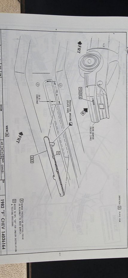

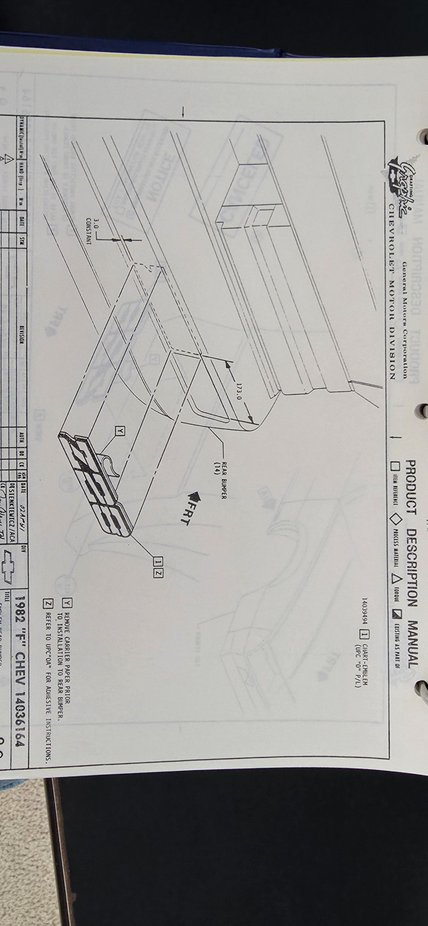

I finally got my car in paint, and I am now at reassembly stage. While I am not doing a concours restoration, I would like to know the factory placement of the stick on Z28 emblem location on the back bumper, passenger side for the 1983/1984 Z28. I assume that the assembly line guys and girls "kind of" placed them in a general position (not perfect for each car as they are mass produced).
Could I bother one of you all who have an original car to give me a ballpark measurement from the factory indent (for lack of the better term) on the back bumper to the start of the emblem?

The ballpark is more visual than dimensional.
Draw a straight line down from the left edge of the yellow lens. That would be either the very left edge of the Z28 emblem or the middle of the Z. That gives you a rough placement since the factory just stuck them on.

These are the exact placement records from a 1982 assembly manual.

When you could still buy a replacement from GM, it came on an extra-large sheet of waxed paper, with a line to put on the bumper/QP junction, and an instruction to center it vertically in that place in the bumper.
