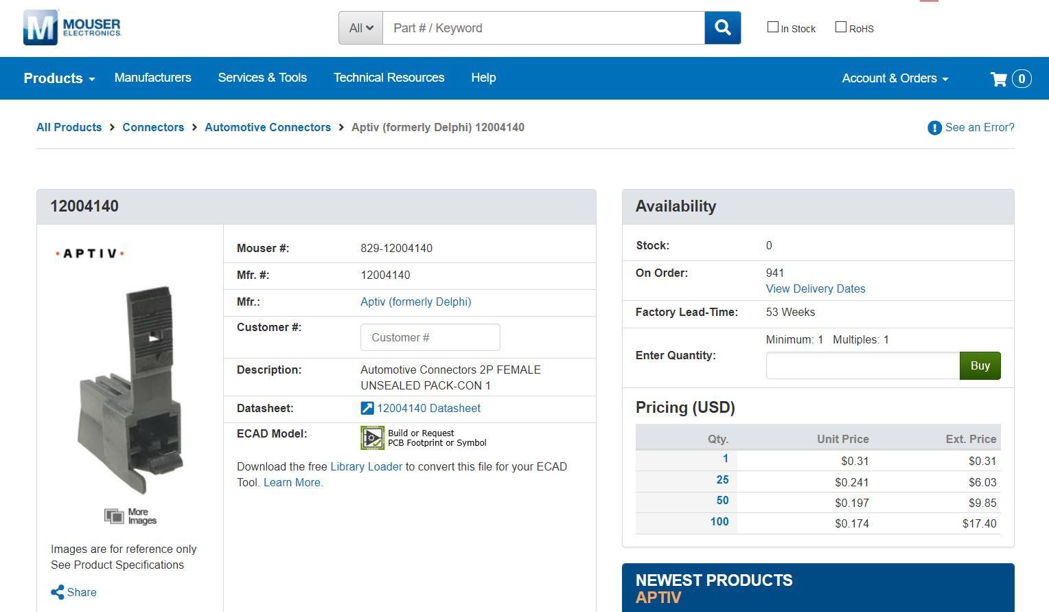

I broke my connector for the power lock actuator in my 85 TA, does anyone have a part number, or a replacement connector pigtail?

It's the same one as the power windows.
Mouser has the connectors and crimp terminals, or hit up the usual suspects for a pigtail. They're listed under one or the other application, but I assure you they're the same. If it's just the plastic connector that's damaged, it can be removed from the terminals/wires and a new connector slipped on.

It was just the connector, but I didn't know they were the same part as the window connectors. Thanks for the heads-up, I was able to find the correct part and order it with that info.
That being said, if anyone has a working connector and/or pigtail, and can beat the lofty price of $23, by all means PM me and I can send the one I ordered back,.
