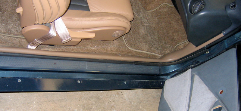

Interior getting close, new seats & 4th gen dash done.

After almost four years my interior is finally coming together. Got my new seat covers installed, 4th gen dash finished up (with vinyl wrapped custom a-pillars and vinyl wrapped dash pad), & rear panels covered in matching vinyl.
Rather then type everything over again, as always you can go to my website and check out ALL the pictures of the 4 year build up:
http://www.ms-fbodies.com/jade_ta.htm
Still left to do on the interior: wrap the 4th gen kick-panel / sill plates, wrap the rear panel trim pieces, fill in un-needed holes in the stock front seat-belt trim pieces (and wrap them in vinyl), and of course make the door panels. I am NOT using the 4th gen door panels as a whole, too many compromises to make it worth it. Instead I'll be applying 4th gen pieces onto a 3rd gen panel base, and then molding the two together.
Any questions, feel free to ask.

That sucks you gave up on the 4th gen door panels. Your install was my inspiration!
I am interested to see the 4th gen sill plates though, and how you got that worked out.

Honestly the panels fit well enough and looked good. It was the rest of the car that wasn't in yet that caused problems.
The sill plates or extended kick panels? Since they're two pieces on the 4th gen. For the kick panels I attached a section of the 4th gen door seals where the panels will cover and then just screwed them in. Some minor trimming on the passenger side and moving the hood release on the driver's. The 4th gen sill plates would fit like a 4th gen if you cut half the flat piece off, cut the tabs off, then taped them onto the metal. I opted to take some stock 3rd gen pieces and cut the sill section off. They slide right in under the 4th gen seals, and use the stock screw holes.

I was wondering about that flat part of the sill you cut off. That looks amazing. I never would have imagined blending the 2 together, and using the rubber piece. I cant wait to see your door panels finished!!

actually I have another question, do those 4th gen sill plates sit any higher than the 3rd gen ones? I'm just wondering if I can get those and get them to close the gap I have on the bottom of the door.
A little bit higher, but not enough to cover the gap. But since the piece is going to lay on the seal, you could space the seal up higher to match the gap on the door. The seal is your typical U-channel type so it should be easy to fabricate a riser for it to rest on, rather then just the sill joints in the body.
Kevin D.
thats not a bad idea, I got to do something, I have a nice one inch gap... which I'm sure is what you meant about the poor fit of the 4th gen panels.
