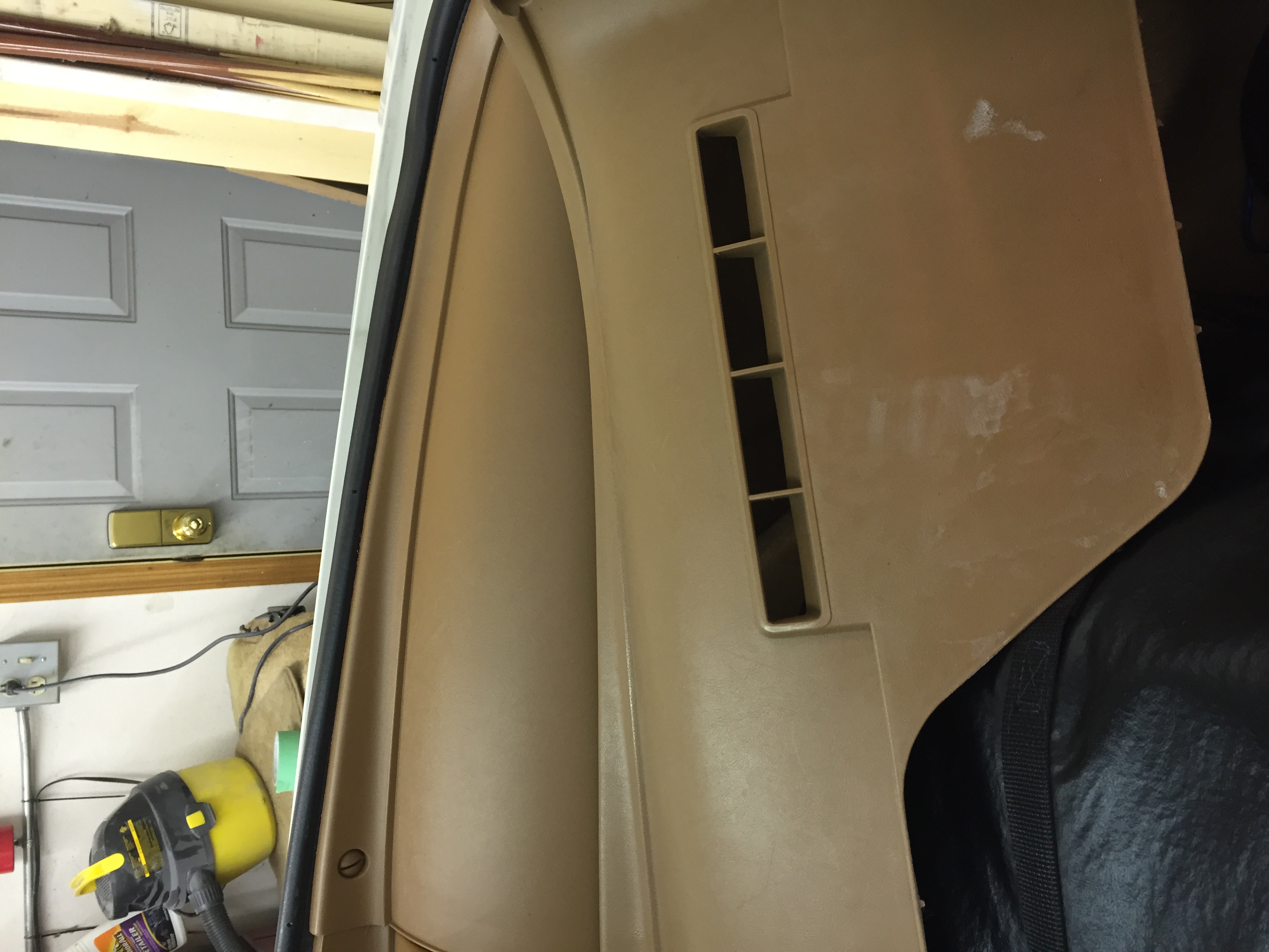

If you are referring to the plastics, the Camel color #15173 from SEM is the closest match to beechwood. The TTA and the GTA are the same interior trim for 1989. I had a cracked door sill on my TTA and got one from a donor car and painted it with the SEM paint. Match is very close, if you paint all the plastics it will look good.

Originally Posted by brett89
Gteatr6 do you have any side by side comparables ? (Original beech wood and the sem 4310 )
I googled Sem 4310 and nothing came up. How did you come up with that code ?
The tire cover in front is untouched
The one on the car behind has been redone with 4310
You can't tell it was even sprayed!
