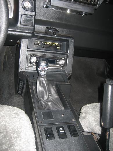

I did my car. Locks and windows and hatch. I just jumped into it and im not any professional. It thought it was a big deal, its so easy every third gen should have power. I don't have pics of doing it but heres how it came out:

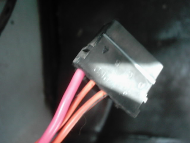

It is a 91, so I guess what your saying is it should have the relay. I pluged everything in and it didn't work, which verified to me that it should have a relay. All I see under the console is a big... 2 inch by 2 inch black box, which i know isn't a relay. Is this some sort of cover that needs to be removed? or something else? Does anyone have pictures of this area on their car?
Also, Anyone know about the plug and play wiring harness, for the windows? are there any relays or fuses associated with that?

The relay is for the door locks. If you're using that connector that was dangling under the driver side of the dash, you'll probably need to buy a circuit breaker to go in the fuse box. Mine didn't have the circuit breaker there becuase my car had no power options.

Ok, from what I remember from the last harness I pulled, there should be a relay (large silver thing, probably about 2" X 3" X 2") that is plugged into the power window harness. It should locate behind the drivers kickpanel. As far as power to the system, there *should* be a black plug board (I don't know what else to call it) up high on the drivers side dash. It will be clipped into the the inner steel that makes up the firewall post/kick panel. Basically, stick your head under the dash, look for a big fat orange wire with a black stripe. It should lead to the plug board. If you DON'T have a big orange wire under there, there should be a BATT ACC or something like that on your fuse panel. The big orange wire on your windows should plug into that. That should power them up. I don't know about the circuit breakers on these cars...back in the day GM used them, but I've never seen one on these car, mind you, I've never looked either. You should ask compuwiz for more details. What colour are the wires going to the 'black box'??
Oh, and I assume that the power hatch you are trying to use came out of a 91 as well??? If you want to by-pass the pull-down motor guts part, the solenoid does unbolt from the other parts and you can just use it by itself....I think I might try to take a look at some schematics and see what the wiring looks like.

There are two kinds of harnesses for the power locks and windows. 82-88 (not sure on the ending year) had a silver metal relay and the black junction box (pic: http://img233.imageshack.us/img233/2327/40600170pd1.jpg) described in the previous post. The 89 and later harness has a black plastic relay (pic: https://www.thirdgen.org/forums/atta...w-img_0048.jpg) and no junction box. It uses this plug instead of the junction box: https://www.thirdgen.org/forums/atta...w-img_0047.jpg.
Hope that helps clear up the wiring harness types

okay... i have a harness from a 91. It has that 'relay' as well as that one plug. I pluged that plug into the existing plug on my cars harness. so hypothetically speaking.... if i plug in the window motor and the switch... it should work. just that ONE plug and everything is all set? nothing extra hidden anywhere?
Thanks, those pics are helpful, becuase i can see what oyu are talking about
Yep, just make sure you have the harness grounded. The stock ground point is right next to the front left driver seat mounting bolt, but anywhere that it is screwed into bare metal will work.
