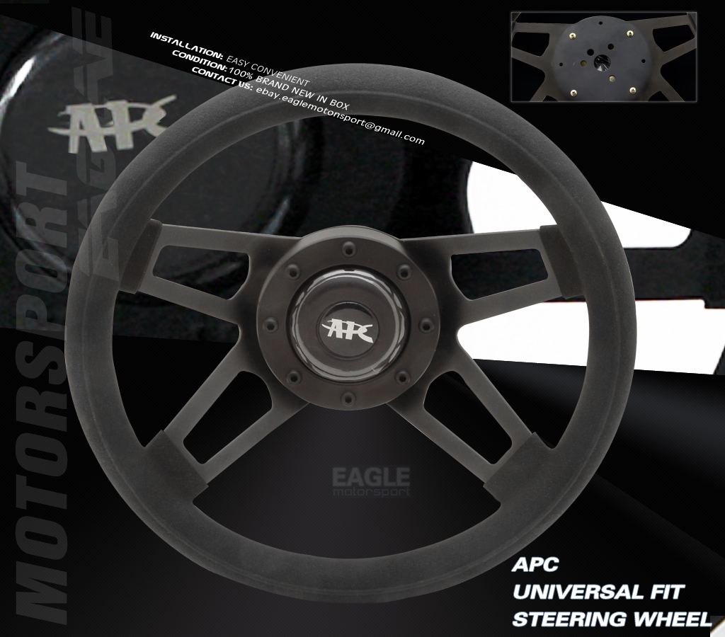

Will this steering wheel fit?
Will this steering wheel fit? If not what adapter can I buy to make it fit?

Re: Will this steering wheel fit?
Well it looks like a rip-off of a Grant steering wheel. Juts get he Chevy hub adapter and it should fit no problem.
I actually Bought that exact same stearing Wheel for my 84 camaro off of ebay.
When I tried to remove my old one it almost seems as though the current one is possibly welded on, all i know is that its not going to be very easy to take off.
If i can manage to get the stock one off It looks like the apc wheel should fit, or mabey It will need that chevy hub adapter or whatever. Not sure yet.

Its not welded on.....You just need a steering wheel puller (any Autozone/O' Riellys etc.) to get it off. That center ring will come off with the welded pieces.

Thanks for letting me know. The odd staggered bolt pattern in the center of the wheel looks as though it matches whats on the Wheel that I bought so i figured that I might be able to just bolt it on if i got the old one off of there but I guess that whole center peice is one part and all comes off. Meaning I will likley need to get that adapter or whatever to get it on.

its a universal wheel. U will need a kit trust me. i know this. 100% sure of it.

Ok what kind of adapter should I be looking for? Can I get a part number or maybe a pattern number of some sort?

Grant Steering Wheel Adapter Part # 3162 according to my old parts catalog... any advance auto, auto zone, or O'reilly's should be able to hook you up with the right one...

Yep. Go to the parts house. They will be able to tell ya witch one to get. Or you can read the box's. They will tell you what cars they work for.

My adapter kit was part #3196 and I have that same wheel but silver spokes.
Here is the difference between the 3196 kit and the 3162 kit mentioned above
#3196
Does not fit telescopic steering column.
#3162
Will fit TSC (Doesnt say it won't so I figure it will)

May be a dumb question but whats a telescopic steering column?

A telescopic steering column is one that you can pull out towards you or push in towards the dashboard just like a telescope.
