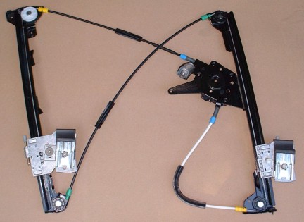

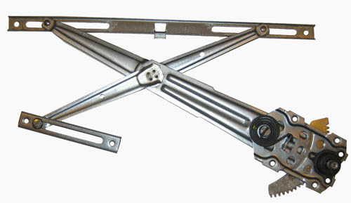

Well I've never seen a 2nd gen regulator, but I'd assume it's similar to 3rd gen style (pic 1). That's how I thought the Grand Am's would be, but it's not, it's a newer version (pic 2). After looking at the system with the door panel off today and removing the drive lever (manual handle) it looks as though grafting an older, slimmer motor will work. The door panel provides plenty of space to work with, so I'm confident I will grant him his wish of power windows. I can take pics along the way in case anyone would like to see the process. Although, I am not sure exactly how much would apply to 3rd gens, because I know room is a big issue on our doors as well as the regulator assembly type. However, if this works, then my question will be answered and if someone can find a way to mount the motor in a 3rd gen with the manual regulator, that's one less PITA per door in my opinion.
