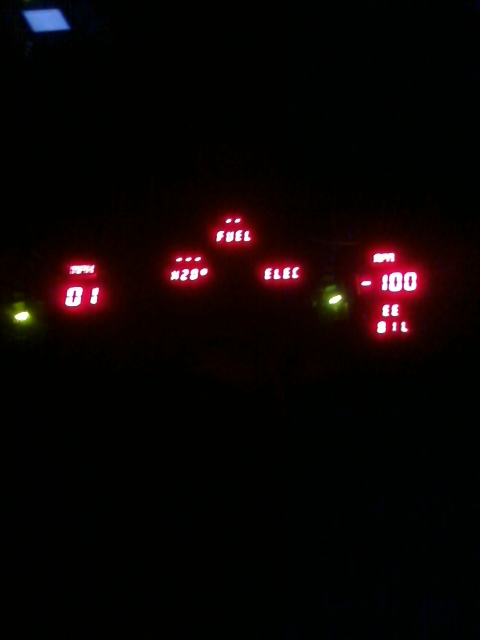

i recently purchased an 86 iroc and have picked up a digital dash for it off craigslist. it looks like a nordskog but the odometer is not digital, it uses the analog that is in the car. i downloaded the installation destructions and the wiring does not match up. i am hoping someone knows if this is in fact a nordskog or if not what brand it might be and how to install it. thanks for any help.

that definately LOOKS like a nordskog, i dont think dakota digital made one in that style, its probably older, i would get ahold of nordskog and ask

That looks like a Cyberdyne cluster.

You will probably need to purchase a digital converter that converts the analog signal from your transmission to a digital signal. This took over the speedo, Odo, trip, etc. I did this just recently on a set of dakota digital gauges in my car.
http://www.dakotadigital.com/index.c...rod/prd168.htm
I cannot find the part number, but if you call up dakota, they may be able to help you with that part.
http://nordskogperformance.net/produ...&cat=10&page=2
The cable shown here is your VSS converter, but I don't think your gauges are Nordskog . I cant even find anything relevant on Cyberdyne's website. What gauges do you he working now ? I'll see where I can help.
