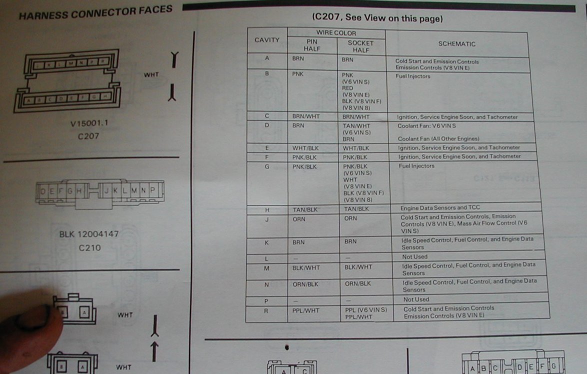

There are some differences in the C100 Firewall connector. You can print out the diagrams for reference here:
http://www.berlinetta.info/C100.htm
You would need to re-wire the wiper wiring and maybe a few other wires here and there.... You will also need to check out the wires leading to/from the C207 connector as well.
Here's the 88 C207
Here's 91 C207
Using these schematics as a guide - you should be able to complete the swap !
