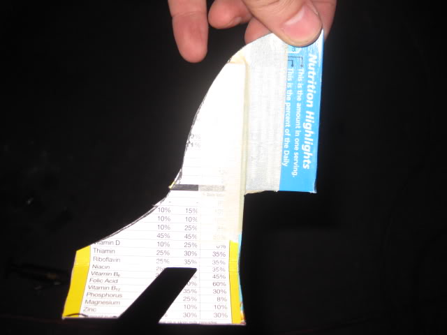

Well, I am working on the lower brace for the dash and I keep looking at the heater box and how I'm going to mount the 4th gen vents to it. I have searched for the past hour and really don't have much more information. I was thinking of using the entire 4th gen HVAC unit but since the car is already painted and assembled, i don't want to modify the firewall and I read the dash is not deep enough to allow for the blower motor and everything to fit. Now I know why few people attempt this. Oh well, it will be very rewarding when it is all done.
