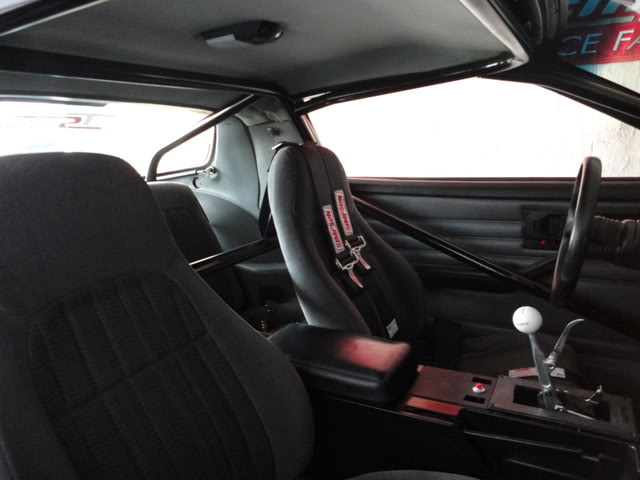

Here was the problem I was speaking of. Look how close my head is to the headliner.
Old Nov 9, 2010 | 07:54 PM
  #109
1MeanZ's Avatar
Joined: Sep 2001
Posts: 2,984
Likes: 37
From: North Central Indiana
Car: 86 IROC
Engine: 383
Transmission: TKO 600
Axle/Gears: 3.54 Dana 44 IRS
Re: roll cage pics with full interior????
Fiero seat tracks on the driver's side will give you an inch or more....

1meanZ is right after some research i found a couple guys doing this. the only other way is to modify the foor board in such a way to resess the brackets into the floor more. its not really hard its just a fact of how much to you want to modify the car.

i used 4th gen corbeau seat tracks instead of 3rd gen ones and it lowered my seats .75 inch at least I'd imagine on my corbeaus

Here is mine. 95% street car. I want to redo the cage now that I've driven it 20,000 miles. I cant find the pic of my door bars..

I've had them on my car for 5 years now. I'm 6"4' and couldn't wear a helmet with the T-tops in. My helmet actually stuck up above the windshield, I have pix at autocross events of it. After the seat track swap, I can get my fingers between my helmet and the bottom of the t-tops.
Old Mar 5, 2011 | 09:30 PM
  #129
Fast 383's Avatar
Joined: Jul 2002
Posts: 784
From: Philly, PA
Car: 1986 Camaro SC
Engine: None
Transmission: None
Axle/Gears: Moser 9" W/ spool 3.50 gears
Originally Posted by mw66nova
gorgeous justin!
Thanks so much. It has been so hard to devote any time to this car lately. I have been chisleing away at this interior for about 2 months at 11:00pm to 1:00am every other night. There's still a lot to do but I had the camera out and figured what the heck. I need to go to the J/Y and get all the missing hardware I need. I am machineing a plate for the shifter W/switches that will match the guage cluster and cage. I also need to cut the dash which is a PITA.
The carpet is new ACC and all the guages and seats are new also. I never had that stuff before.
I may switch to black leather some day but I won these seats for $48 on ebay and they were local. lol

only before picture I have. Seats and carpet were beat! No tach! blah

well i'd say you've done very well so far! i need to get the interior cleaned up in mine...it's in shambles compared to what it was on the first page of this thread, lol...a few drivetrain swaps, and a dash swap, with a whole lot of racing thrown in with little ability to give attention to the small details has let it get in bad shape. i'm going to try to do some house cleaning in it this summer i think when i'm not so tied up with classes.
oh, what steering wheel is that? i've been looking for a replacement for mine (still has the stock airbag wheel in it) and that one looks like a solid replacement.

Just a Grant GT from Pep boys. I think it was $79. Cant beat it. The diameter is perfect and the thickness is perfect. Its also a durable material so it doesnt get dirty and it still feels new. I reccomend it. I like the 4 spoke version also.

you bend it up or is it a kit? looks real nice.
i am not a fan of the camaro high back seat and a 5 way harness. if you crash, you might not stay in the seat.

It started out as an S+W 10 point kit. He pretty much re-bent everything to tuck real tight. Notice the overhead halo is way out of the window view. I had to cut the headliner back to get it back in. The door bars were re-bent to keep the arm rest from hitting. The rear bars were bent completely different. They go into the rear well when you get them. I think there a bit drastic but he knew I wanted to put the rear seat back in.
I also like a seat with a head rest for the belts to go through but nothing was really available. I'm not set on these seats but the'll work for now. I spent all the budget on the cage and figured on doing something different later.
Also, If it makes it any safer, the belt is bolted to the tabs on the cage which are directly behind the headrest. It keeps it lined up real well.

check out hawksthirdgenparts.com for the corbeau inserts like my car had to keep the harness more on your shoulders.

So why am i not seeing any of the drivers seats actually ATTACHED to the rear bar like they are supposed to be? Or did that rule change?
Also after all of the reading.....My rear bars extend over and down onto the rear rails. I dont see how getting rearended is going to push my main bar onto my head!!! I would have to get hit by a H3 Hummer doing 90 to move that bar i would think.
Another find, was about the 6X6 plate, its only required on the inside if it is welded, not sandwiched like someone was getting all bent out of shape about, that only applies if your are bolting it in.
Ok, i'm done
But when we welded the rear bars on in my 92, we only tacked them on for position then tilted the whole assembly forward to do the full weld all the way around prior to standing up and fully welding in the main hoop.

a reclining seat does not have to be bolted in, however, a race seat (like my kirkey) must be bolted to the bar, which mine is.
