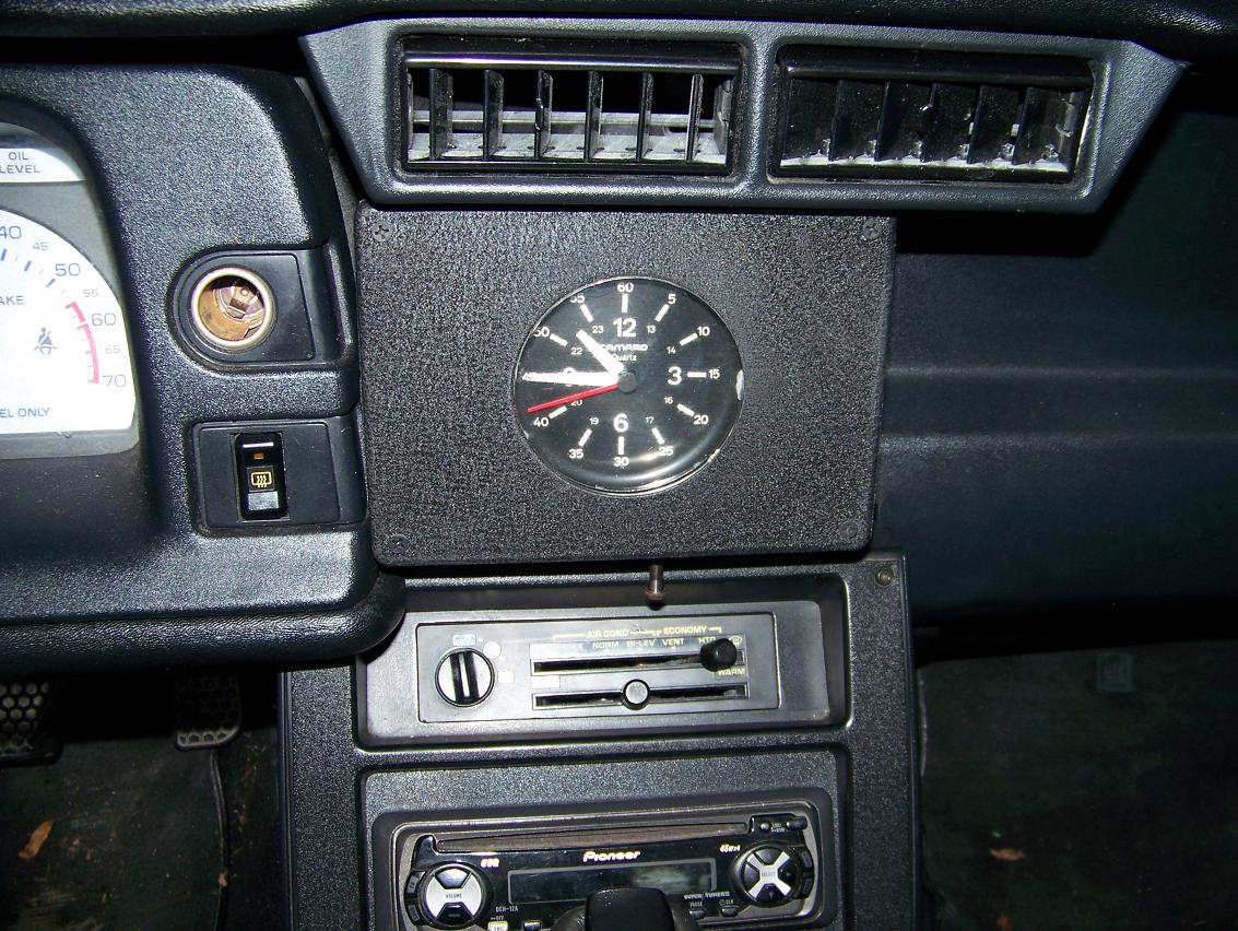

I used a Krylon crinkle on a project box that I put a clock into, I think it turned out well.

camaronewbie,that looks good,it does kinda match a dash board.

I did the same w/ my extra gauges/radio delete
