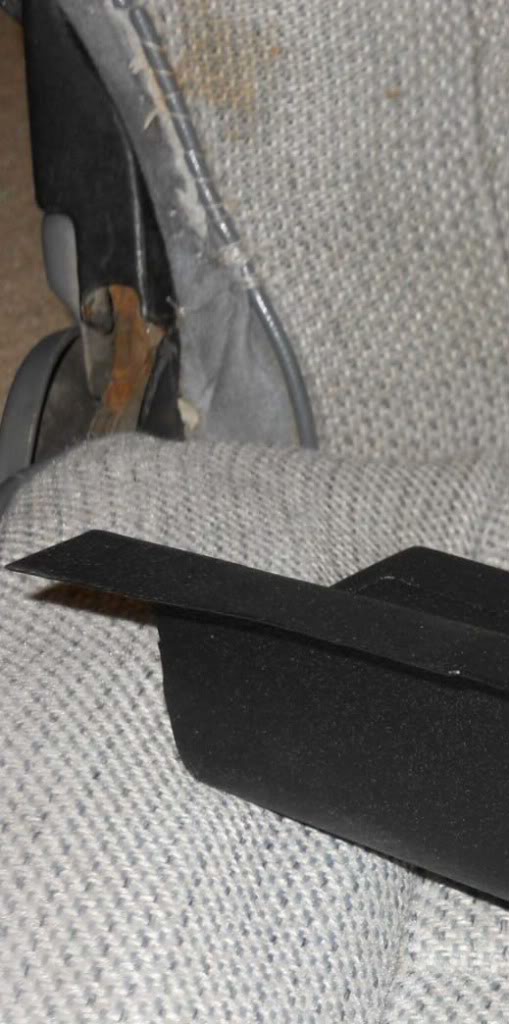

here's an example of the fabric and damage from my cupholder build thread. The seats are in the attic, so I don't want to take them down just to snap a pic

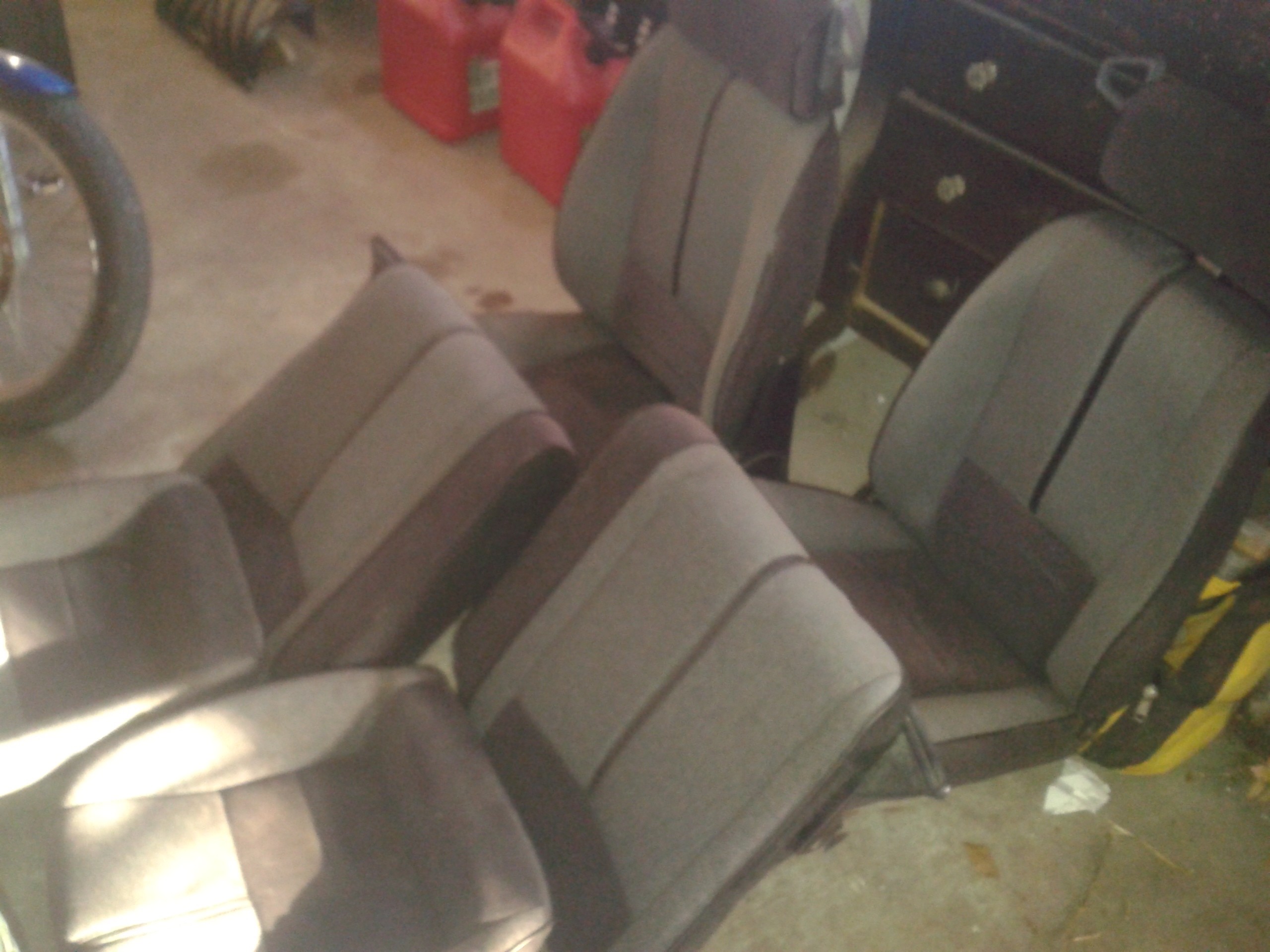

Yeah, I've got the deluxe interior. My black inserts aren't very black anymore, as you can see. The holes I'm patching are on the driver seat, a big one on the bottom and a smaller one on the lower back, both in the tweed sections.
If I could get the entire section from a donor seat, the repair could be professionally done, but I just have two small sections of the fabric.

I have a feeling that I'm going to be in the same boat as you when I get these seats, not to mention the fact that If I use the seat back that comes with the deluxe interior, I'll have to mod my car to make the split back of the rear seat to work
If I do wind up buying a replacement set of covers, I'll put the deluxe cover for a non split back on my base model seat. should work
It might not be worth it right now, but hey, that's what we have storage buildings and attics, right?

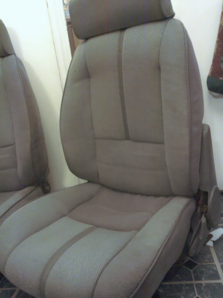

Sorry to ressurect this , but maybe i can still help. Above is a picture of my seats after the driver seat (on right) had been repaired with the "tweed" style fabric in red.
The panel closest to the door on the seatback had a worn spot on it in the usual place, and a local upholsterer was able to locate some of the same fabric by calling some old contacts
he had been buying from for years. Some place in Oregon, he would not tell me where. One yard of the original fabric cost me 85 bucks. I had enough left over to do my sail panels with the same fabric.
I think the stuff is still out there somewhere, just may need the help of someone in the business to find it. The trim shop I went to had literally hundreds of rolls of cloth stacked up on shelves from many years back.

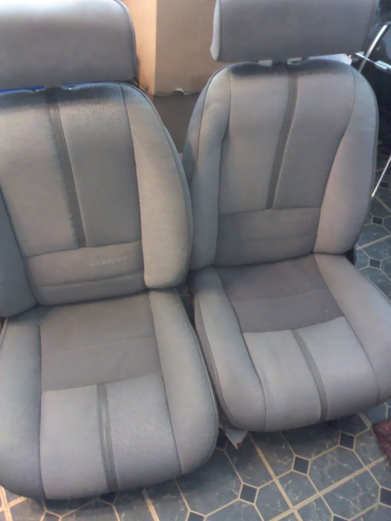

My seats were sun faded also. Found a really good upholstery dye online at this place http://www.leathermagic.com/Pages/carpetdyeProds.htm
This picture shows the before / after comparison of what this dye did on my faded seats
http://i1205.photobucket.com/albums/...esttrip074.jpg

1) You've made my evening. 2) How hard was it and what did entail? I think I know what I'll be doing this summer!

It's really not difficult, just tedious and time consuming to do it right. I suggest buying the dye "kit" which comes with a bristle brush to work the dye in to the fabric. if your seats are the 2-fabric panel style like mine, you have to mask off the tweed fabric to avoid dying that part. I masked it off with plastic sheeting and sticky cloth tape about a quarter inch in from the tweed , and finished the edges, after removing the masking, with a q-tip. also make sure you remove any stains and shampoo the fabric before dyeing. I also used the same dye to do my carpet, and it came out very well....good stuff

Got my drivers seat back from the shop today. it's not perfect, you can certainly tell when something doesn't have that look of being factory original. The lines and creases just aren't as flawless and crisp
That being said, I'll be ok putting these in my car over a 4th gen interior. I do need to run the steam vac uphoulstery attachment over them a few times, especially the passenger seat
I have the back seats and the door panels to match these as well, it will be a nice upgrade for my interior

cleaned them again, looking better. Just about ready to put in the car

Resurrecting an old thread, but I just picked up a set of four seats for fifty bucks. They're in pretty good shape, except of course the driver side, and now I have two good passenger seats.
Fiftymark, how much did it end up costing you to do your driver seat once all was said and done? I'd like to do the same for my car.
Attached Thumbnails matching/replacing one panel in a seat?-wp_000367.jpg

Expensive. I should have shopped around. It was close to $300

AFAIK the passenger and driver seats are "interchangeable" but you will need to unbolt the hard parts and switch them. Not 100% sure this applies to your style but I am pretty sure. You may have to get creative to hide some of the screw holes.

Won't work,but he could switch the upholstery.the only thing is,he'll have to sew the inertia button hole (seat back button)
