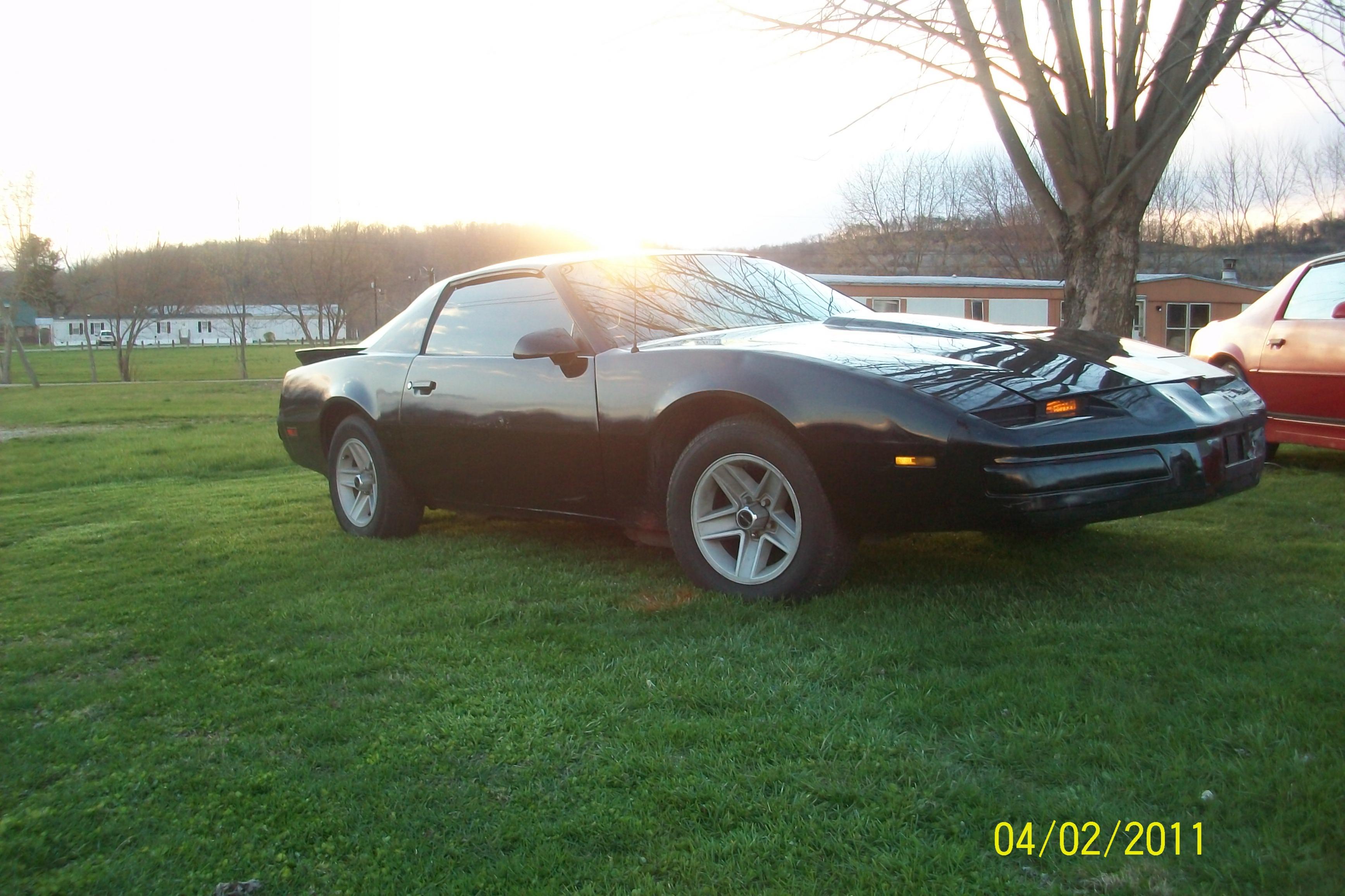

I have a 1989 Pontiac Firebird Formula that I just got and the steeering column needs replaced. How would I do that? I have never had to do that before and dont know what to do. Also the column I am looking at came out of a 1989 Firebird also with a vats key do I need to change my ignition cylinder as well? Thanks for all the help.
