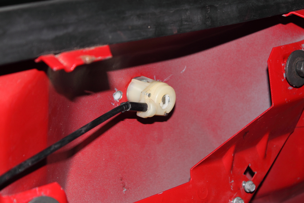

Any body know how to separate the hatch release cable
off the key-tumbler shaft?
Note that the rivets holding on the key-tumbler have been removed,
and do not secure the release cable fitting. It feels like the cable
fitting snaps onto the tumbler shaft in some fashion, but how to
release it is, at the moment, beyond me.

it just snaps on. you have to gently pry the sides away from the tumbler and pull.
