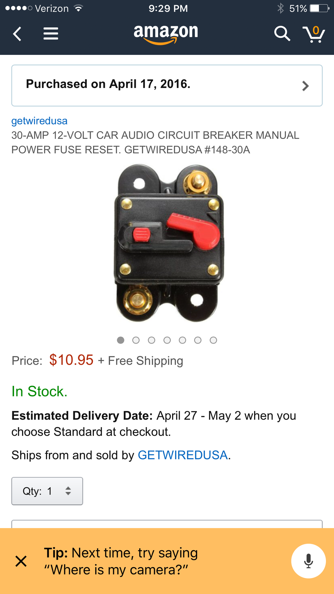

Not trying to revive a old post but this caught my eyes. I have a 1992 poniac firebird and I am planing to run relays to my windows as I have my dash out and car gutted right now.
I bought this relay to start off with my wiring(12 volt 30 amp) . I'm going to test it to make sure it pops like it is suppose to
I plan on using your wire diagram. I understand that there is voltage drop in the wires and get the idea of running a 8 gauge wire to help , but what exactly is that module that they were talking and how dose it help?Is there something else I can do besides running relays to help?
