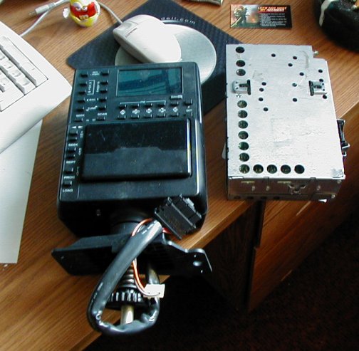

I'm only taking a guess here, but where you mention big flat hole as well as having a Berlinetta, perhaps it had the big pod/swivel radio?
The picture is of my guess. For additional help, I'd try www.berlinetta.info which is where I found the photo.

Yep, you're missing the panel, the pod, the stalk and the tuner box that mounts below the console. What a mess. Ouch. If you want to mount an aftermarket stereo, you can get an underdash kit and turn it upside down, mount the radio in it and mount it over the hole you have. It will require some dremel work and some patience, but it can be done.

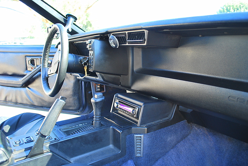

Here's a photo of someone else's modification to add an aftermarket using an upside down underdash kit:
I am leaving my pod in place and installing an mp3 system out of sight so it looks stock but has nice digital tunes. Since you are missing all those parts, it might be easier for you to look into the underdash kit method.
