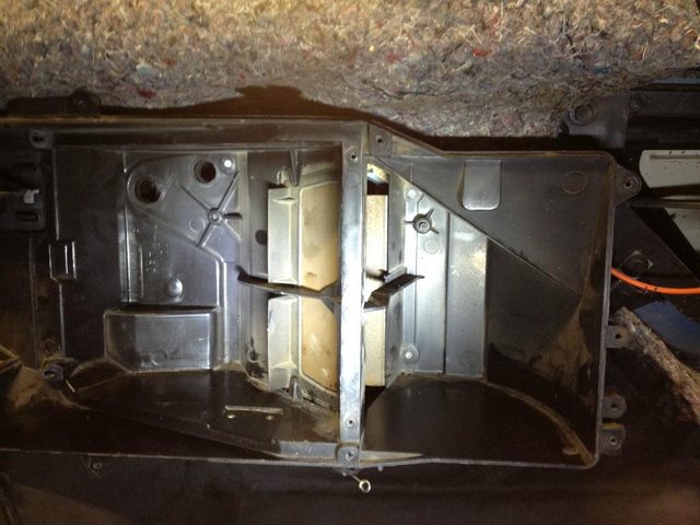

I'm trying to replace the interior firewall insulation and put down some sound deadener, but I can't figure out how to get the plastic air ducting out. I can't see any screws still holding this thing in, but it's still firmly stuck in there.
What am I missing?

There are 2-3 screws at the bottom that go through the box and into clips on the outer case. They're 10mm screws and are about a 1.5" long... There may be another one that comes in from the other side as well at the top.

Thanks Maverick.
I finally got it off this afternoon. How rude of GM to make me take out the AC radiator and condenser just to get to 1 bolt.

LOL... I forgot about that SOB. I took that crap (the engine side of the A/C box) out so long ago I forgot about that one bolt. I know there were 2 bolts I couldn't put back into the case after I took the A/C box out, but I forgot the high one.
