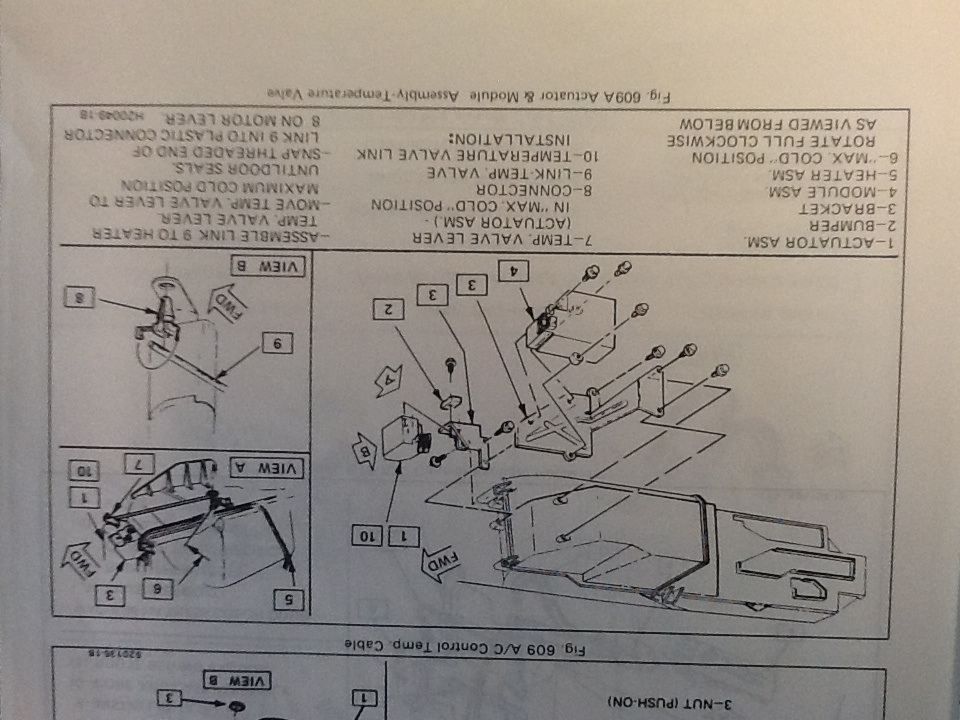

Oops, I think I might be wrong about that, still not sure after checking out my 87 Factory service manual. The actual 87fsm doesn't mention the digital dash option at all, but the 87 electrical supplement describes the digital dash, but not the push button hvac. However, there is a diagram in the 87 fsm that doesn't seem to have a reference and isn't in my 86 fsm (sorry, don't have a 88). I think it shows the ELECTRIC actuators for the temp control that go with the push button hvac. There's probably electric actuators for the modes, too, but I don't seem to have that supplement.hth
Attached Thumbnails HVAC Selector problem in '87 TA with digital dash-image.jpg
