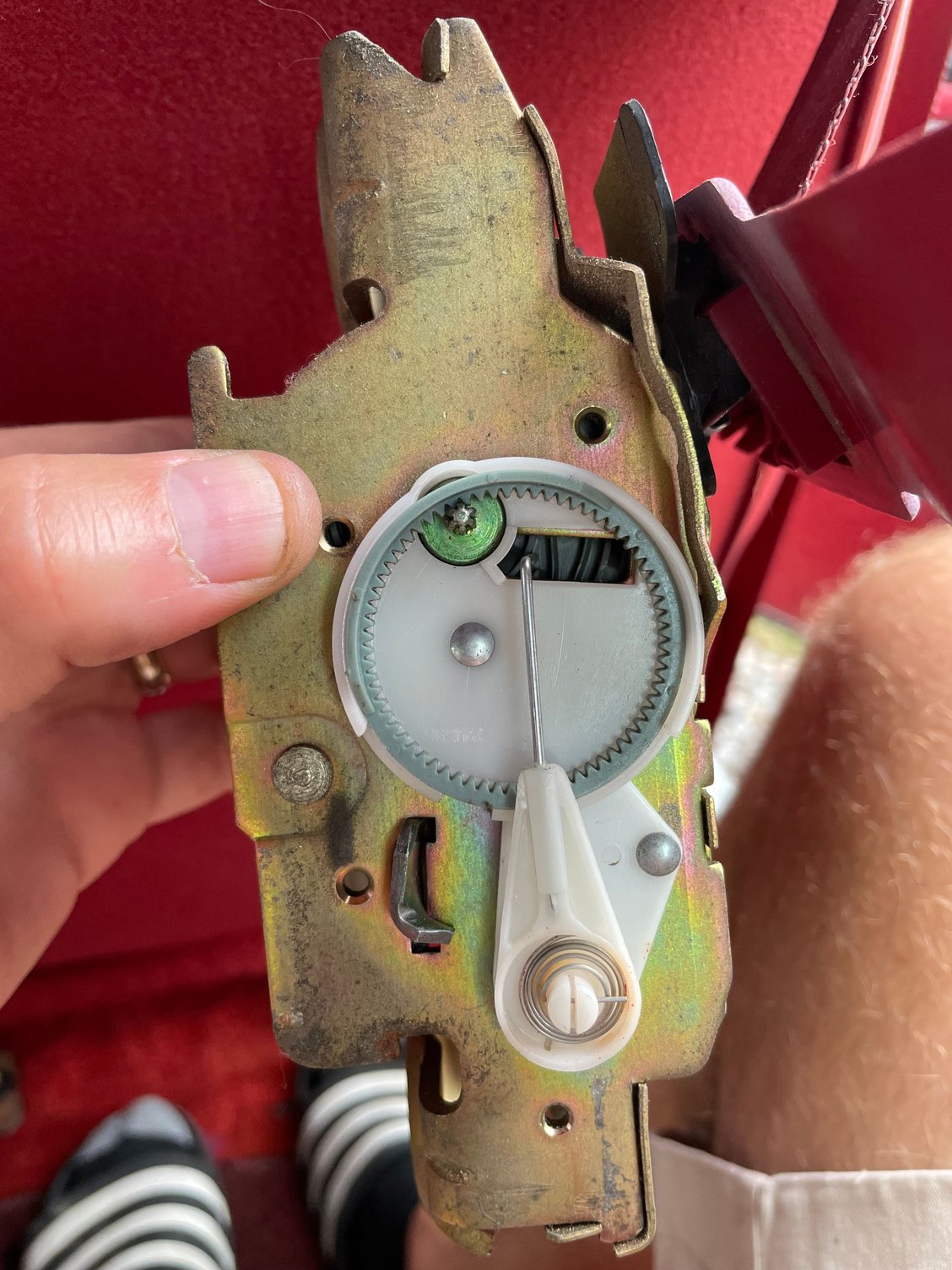

Thanks all for sharing your experiences and for giving me the confidence to tackle this project.
I was able to repair my passenger side upper retractor. As other posts suggest, I took mine one extra step which made all the difference - unbolting it from the roof with a 13mm socket so that I could actually see everything and make sense on how it works.
My belt was completely pulled out and would not retract. Between the inertia pendulum and the intermediate locking/latching mechanism, I was able to fix it.
Not sure how really… but I did notice the clear ish side cover had popped off.
After messing with it for 10 minutes I was able to cycle it several times with expected/satisfied results. The side cover has four posts that have an interference clearance. It appears that this is a dust cover and meant to hold in the plastic geared wheel. Not exactly sure what this wheel does…?
just really wanted to show the image I took to help others with diagnosing and perhaps query those that know more about it than I.
