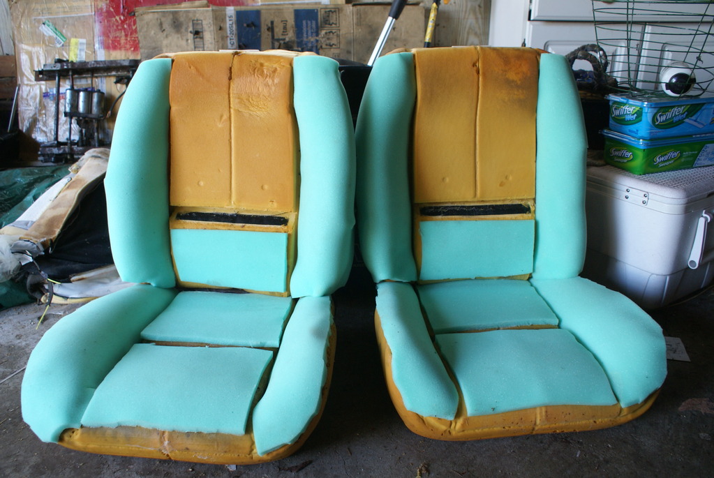

When I redid the seats in my 89, I went to JoAnn's and bought a 2 1/2 yard roll of high density foam, 1 1/2" thick IIRC. Then I cut square pieces out to glue to the various panels on the seats. I was able to cover everything except the upper center panel of each front seat with that one roll. Cost me about $20 at the time. Here's how they looked before I put the new covers on.

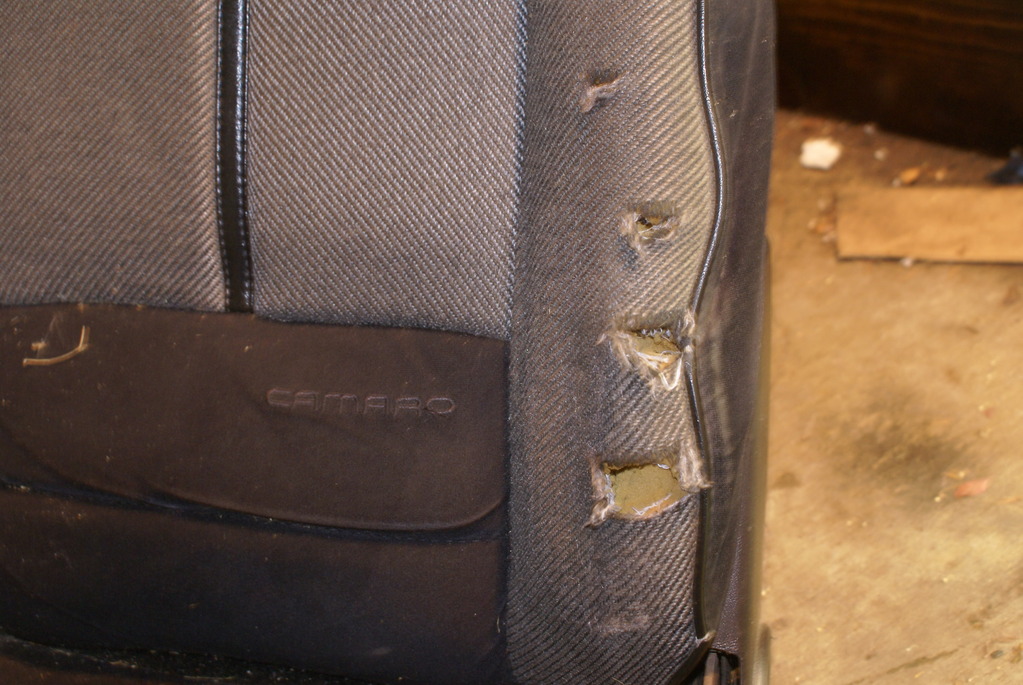

This is how the side bolster looked originally, the bottom piece looked as bad.
