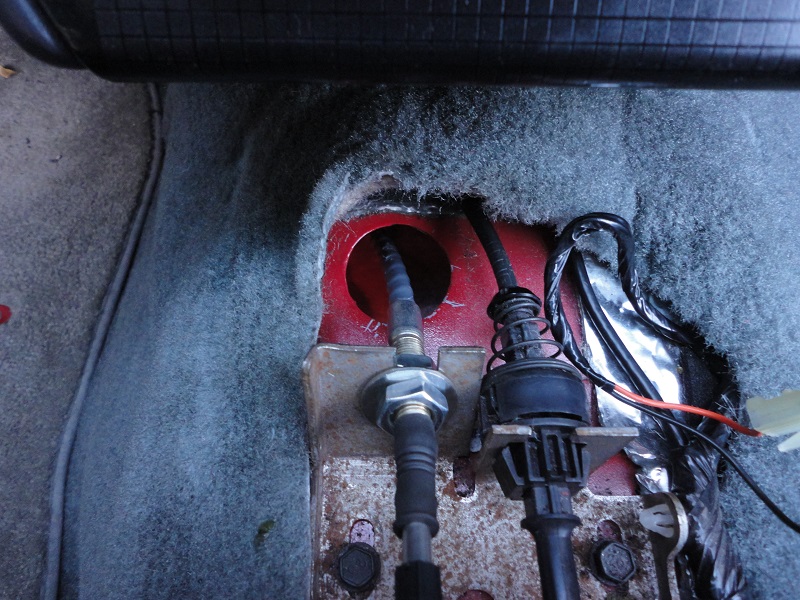

I bought my GTA as a roller, it was a 5spd. car but I'm go'n automatic. I've fabbed a plate to cover the shifter hole with provisions for the front two auto shifter mount screws.
I'm in need of a picture of the auto shifter showing where the cable goes through the floor, a measurement of the cable from the shifter mount to the floor grommet would be a plus.
Soon as I get this cable through, I can install the engine/trans.....

Does this help?

The distance between the shifter bracket and the trans pan bracket is critical. The cable itself has extra length to bend around.

Thanks mantaguy for your time, TEDSgrad's picture is just what the doctor ordered !
