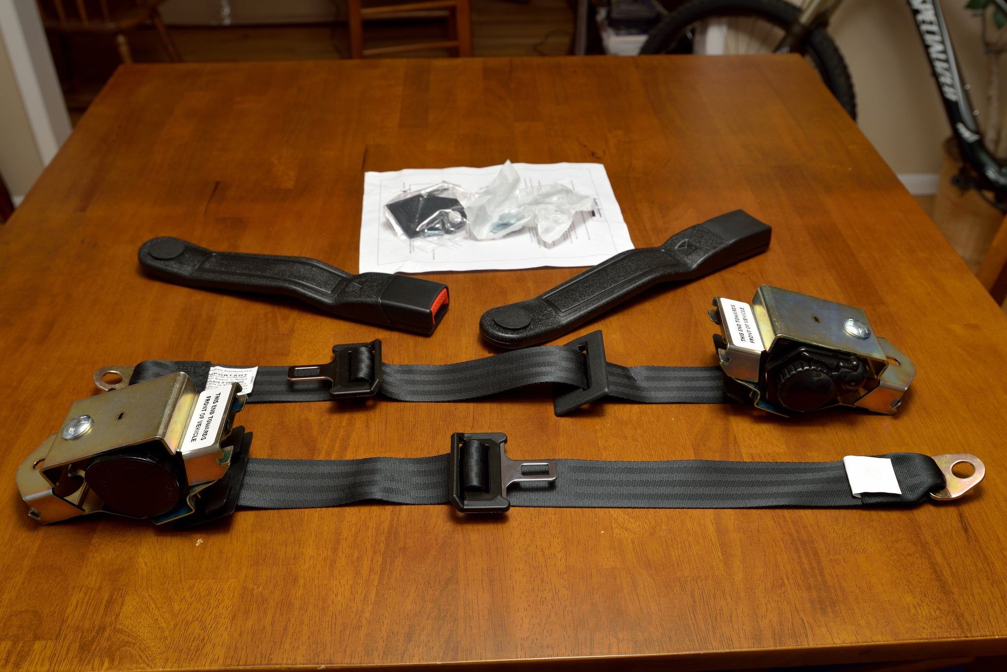

Here is what you get with the kit.
As you will note, these belts only have an upper, roof mounted retractor. The belts seem to be produced by Seatbelt Solutions and are made in the USA. Good stuff.

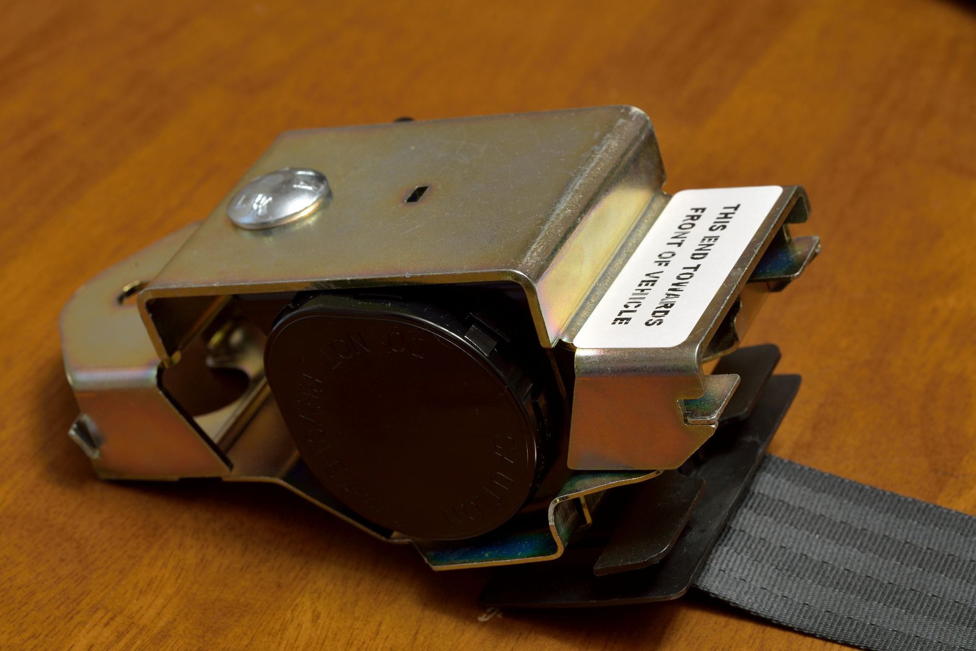

Some detailed pictures:

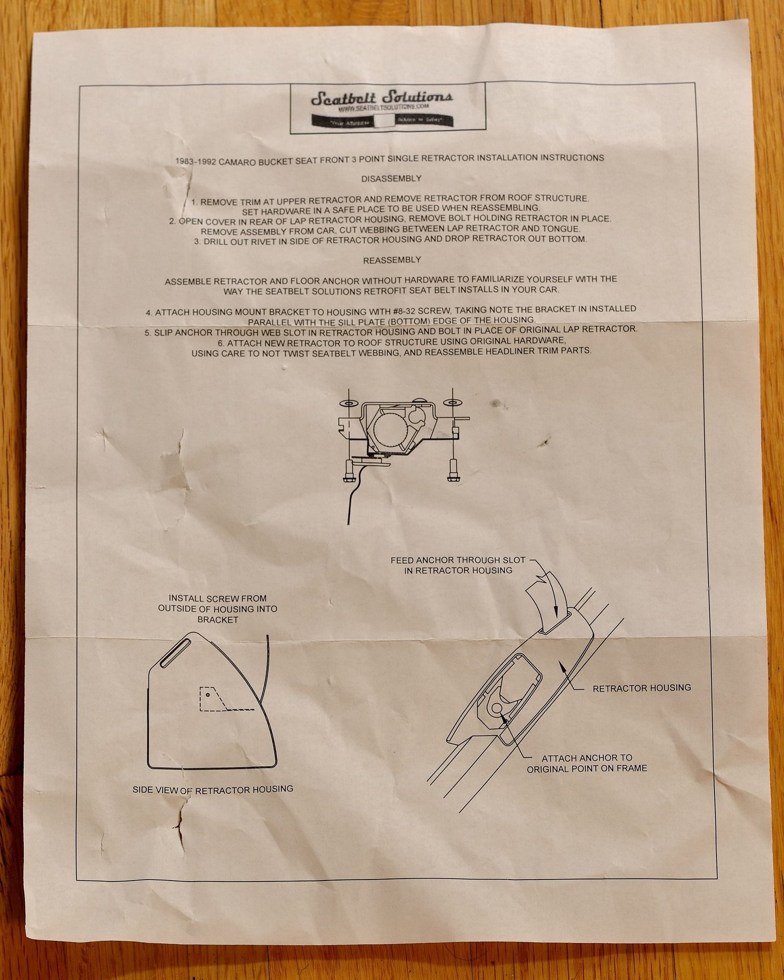

Now from discussions with Ray, I was concerned that this product would look out of place with the factory 83-92 sill plates which have the large cutout for the factory lower retractor. In reality, these reproduction belts are intended to be used with the factory 83-92 lower retractor plastic so the outward appearance is no different than OEM. The belts come with adapter brackets to mount to the lower retractor plastic to make it fit.
And the instructions explain exactly what need to be done.
