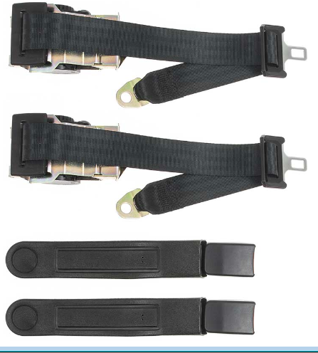

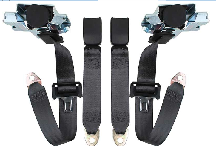

The main difference between the reproduction single retractor Third and Fourth Gen seat belt sets is the plastic sleeve that surrounds the female (buckle) end. This would be the buckle part of the belt (with push button) that mounts near the center tunnel of the car and sticks up between the front bucket seat and the console (to the right of the driver, and left of the passenger). The reproduction Third Gen belt set has a plastic sleeve on this portion of the belt, while the reproduction Fourth Gen set does not.
Additionally, neither reproduction set has the short plastic surround that is shown in your image of the 1982 sill plate with the OE Fourth Gen belt sticking through it. So, it seems to me that if you wanted to go with the reproduction belts, you would still want to use the Third Gen set, because the portion of the belt going through the sill plate, would be nearly identical whether you use the Third or the Fourth Gen set. But with the Third Gen set, you will have the plastic sleeve that may eliminate the possibility of losing the buckle end between the seat and console when unclasped.
THIRD GEN SET :
FOURTH GEN SET:
