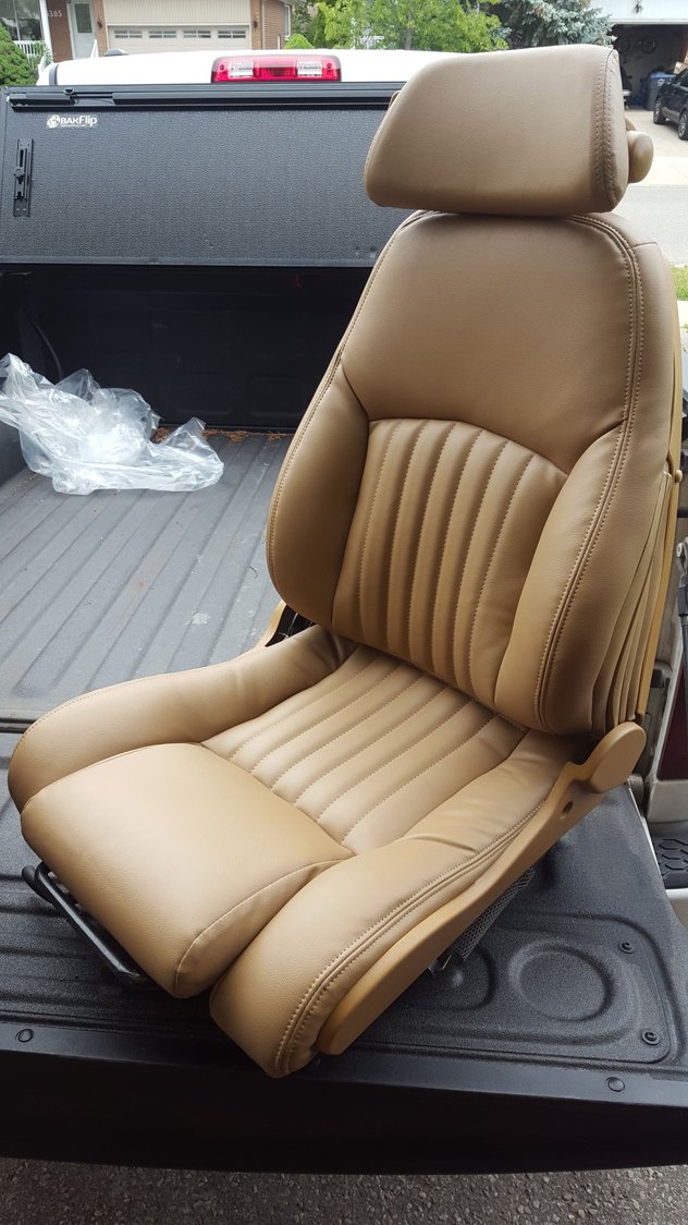

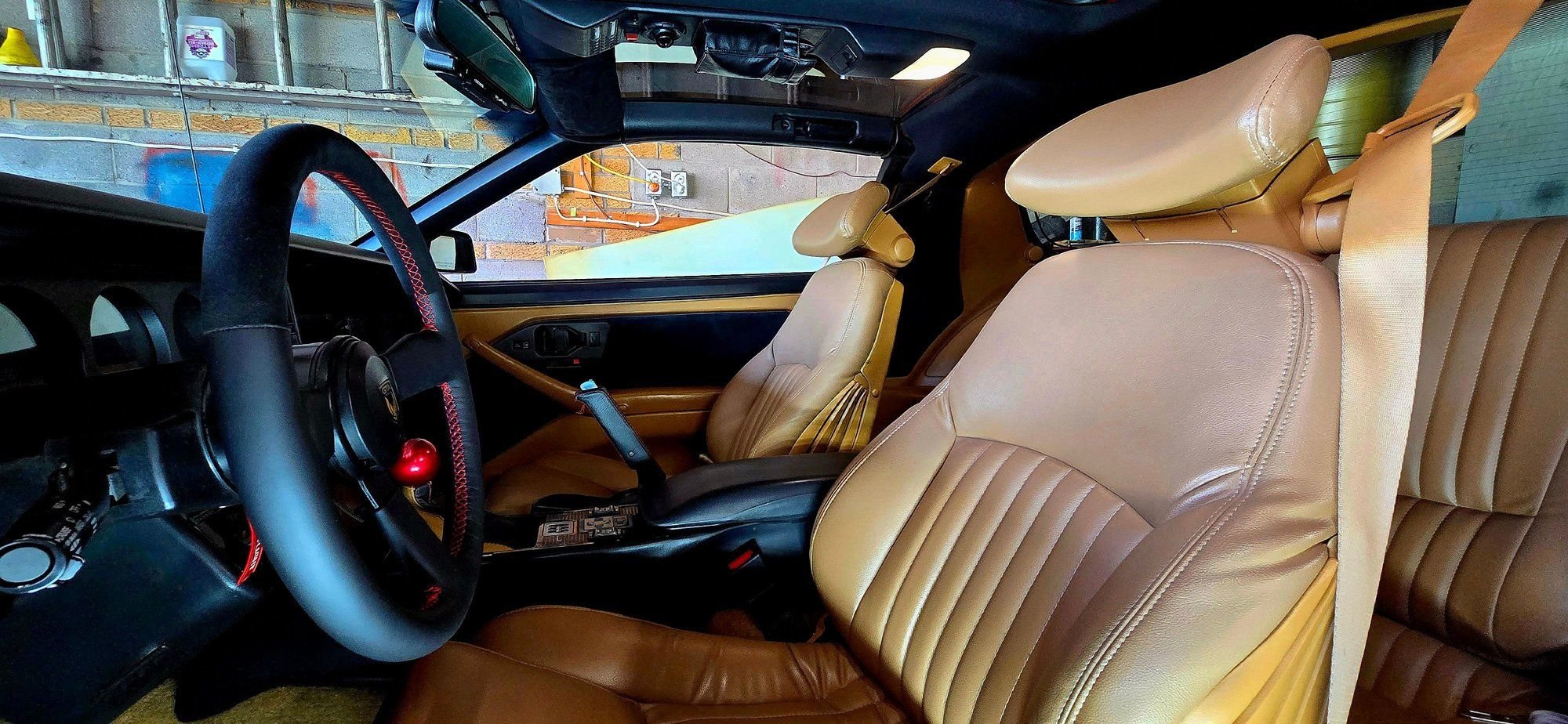

You're in the same situation I was in. Light saddle tan. I ended up going with Beachwood Hampton vinyl seat covers, which are very convincing. You'd think they were leather. Fantastic material. I re-colored the interior panels with Camel SEM die/paint

Looks great! I did get the new carpet in Camel which we thought was a little dark but when we tried SEM Saddle tan paint it was too brown. I was going to have some custom stuff mixed up locally to see if I could get closer to the light saddle. If that does not work, it looks like the SEM Camel will do the trick. Also, thanks for pics of the seats. I'd love leather but that's too pricey so it was a toss up between vinyl and cloth- since they both seem to be the same price.
Now you have me leaning toward the vinyl.

You'll like that vynil. It's soft and it's not 1970's Pinto vinyl hot either. I had cloth originally but that cloth is not available in any of the covers. It's a different material and I didn't like the way it looked. There are guys here that know what that stuff was called. It was particular. But no one reproduces it so I went with the Hampton. Love it!
I recommend getting it installed by an upholstery shop. It's not a simple slip on. It had to be massaged, heated and stretched in places. Unless you know what you're doing of course.
How did you prep the plastic before painting it?
SEM has a panel cleaner that you basically use scothbrite with and give it a scrub. Then there's an adhesion promoter that you spray on it.
Thanks…. your interior looks great! I was worried about the scotch-bright scratching the surface finish. My parts are black so I don’t know if it would be worth it to paint them or just use a plastic protectant on them.
Thanks. You won't damage the panel with scotch bright. You're just basically cleaning and opening it up to accept the SEM die. It works very well

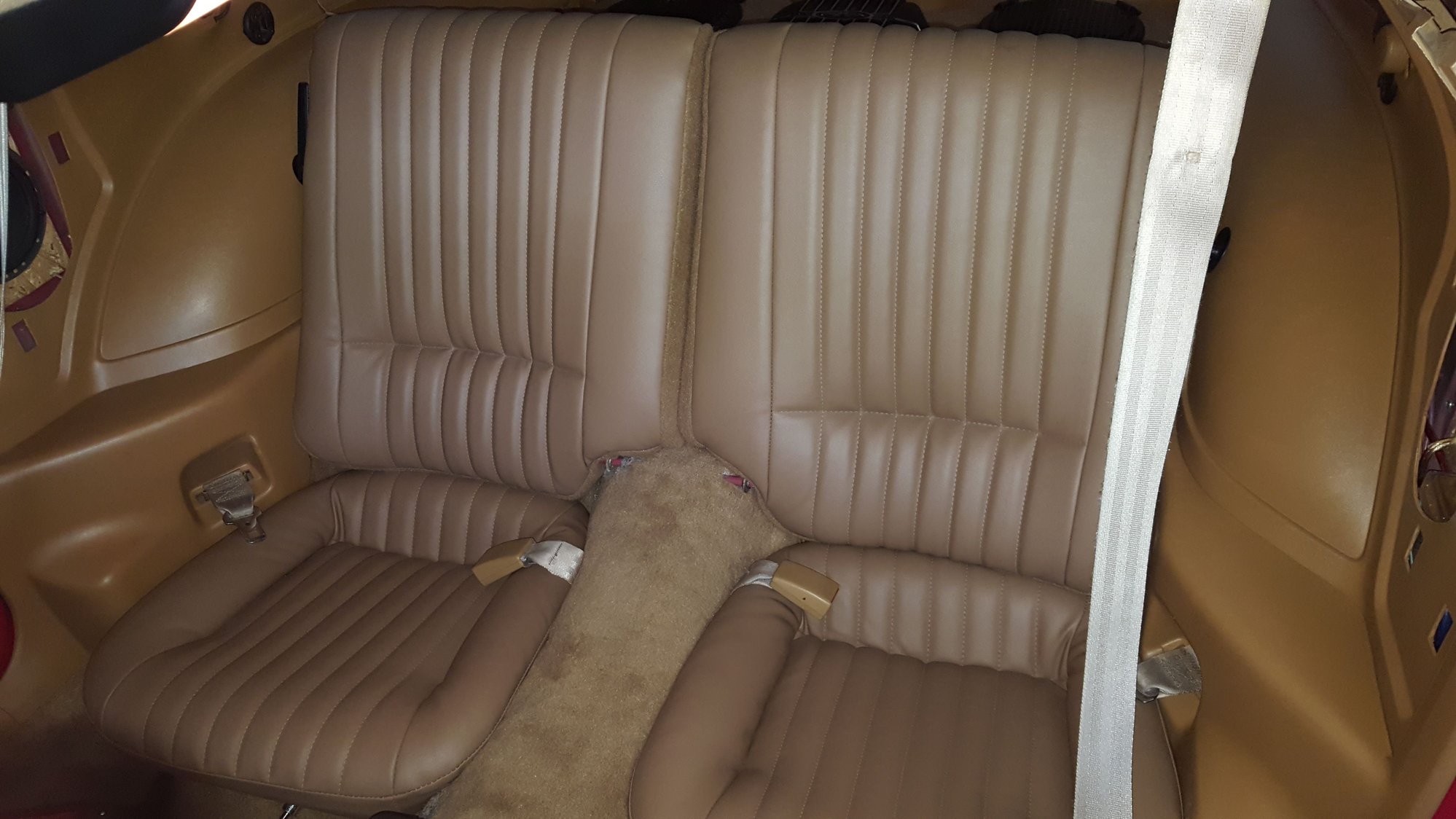

EDGE: If possible can we get a few more pics of the interior plastics? I have been trying to match the light saddle to no avail. Even had the paint store use their machine to match the paint and it comes out looking orange.
I had tried the SEM Saddle tan but it comes out looking more brown so I am leaning towards your set-up. Additionally, I am speaking with a vendor on getting the right seat color. They sent me 3 crappy samples and when I told them none of them were even close they sent me an email with 25 other "options". Ugh. This is tedious.

I can get you a few pics. Just need about a day because the cars masked up right now for paint and I can't open the door. Here's a couple of what I do have that's on my phone right now. The door panel was died with the exact same SEM camel. The seats are Hampton Vinyl Saddle (Tan) Rear Seat Split
