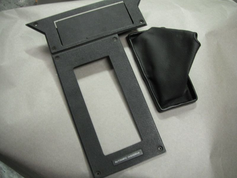

You can make it too.

nice! Looks like you had to modify the shifter base plate, how much did you cut out and what did you use to make a nice cut in the plastic shifter base?

Yes, modified.Never measured I just matched the length of the window to the shifter & the edge the same width as the section between window/boot.Its all hand cut w/ an exacto knife, filed flat.

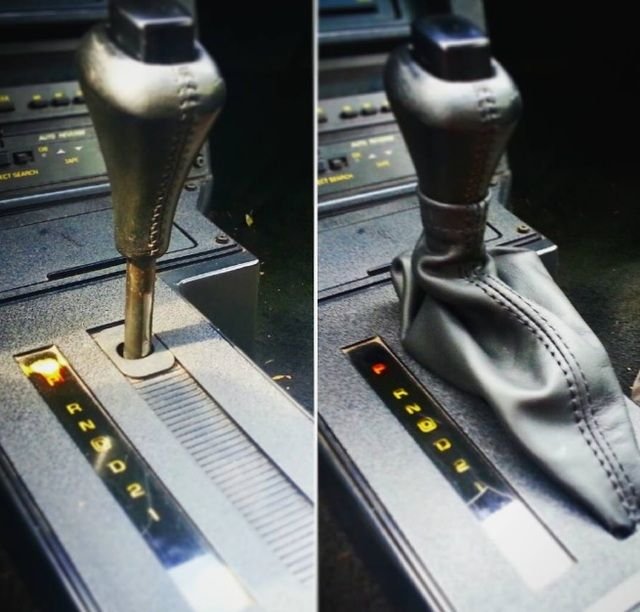

I'll update with pics later, but if you're wanting to add a shifter boot to an automatic in the Camaros (almost Firebird/Corvette style), there is a way to do it and still retain the shift position indicator. I did it to mine and was actually pretty easy. I just got one off eBay and I think it's from a Firebird but not certain. Basically just sandwich the leather between the plate and the plastic piece glued underneath it (which you'll have to break off and re-glue when you get the leather between it)

Awesome. That is what I'm looking for! Thanks
