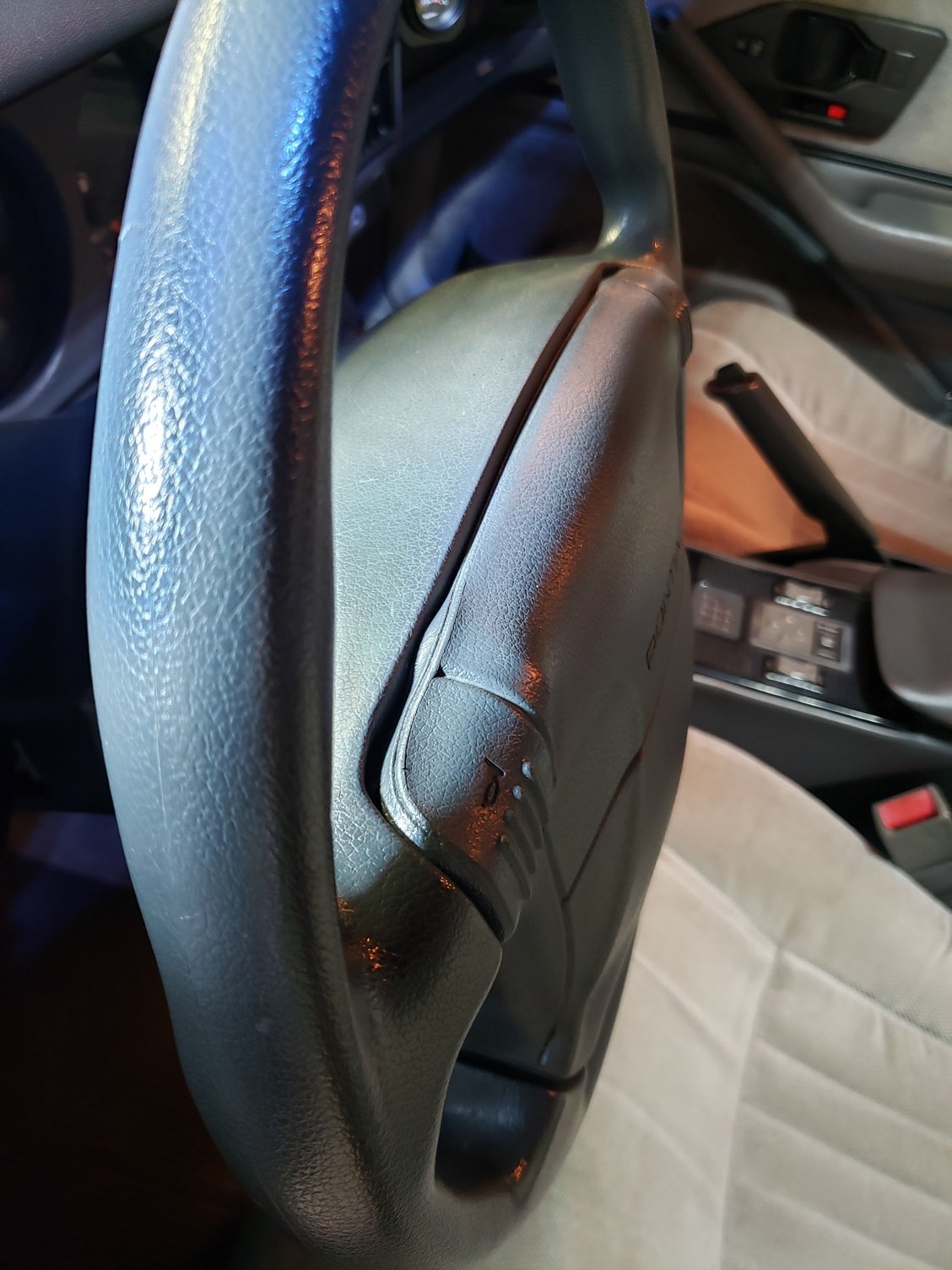

'92 steering wheel airbag cover coming off
Anyone got any ideas on how to fix this?

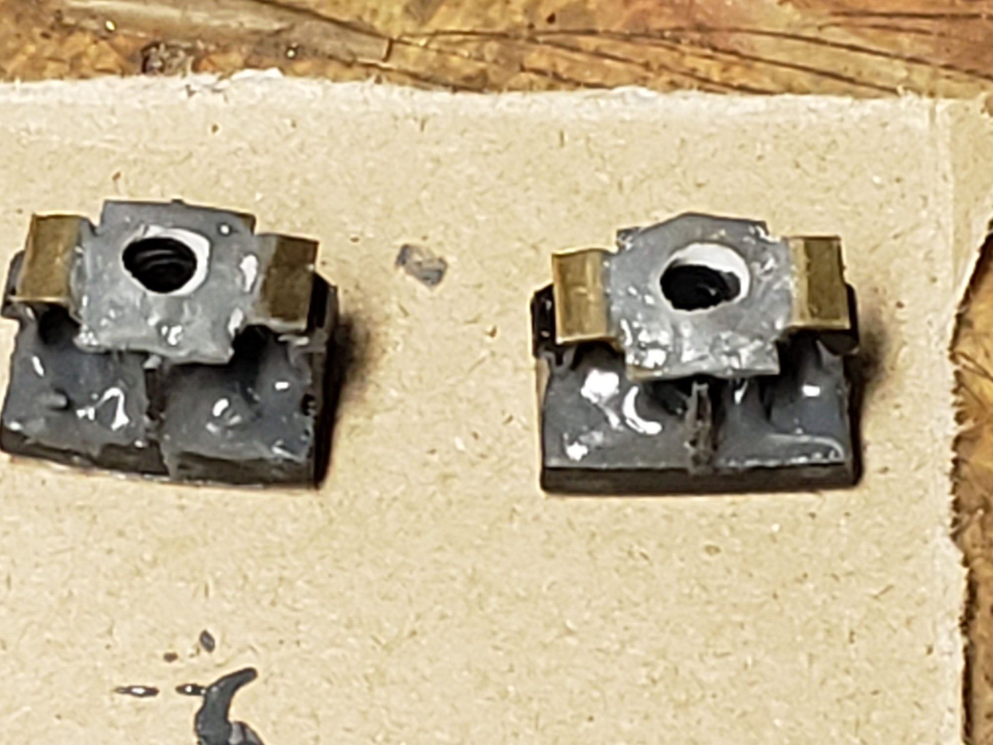

My horn buttons were still functional, but I decided to reinforce to prevent future problems. A little JB Weld does the trick.
I got a little excessive with the JB Weld. These needed to be modified slightly to fit back in horn switch casing.

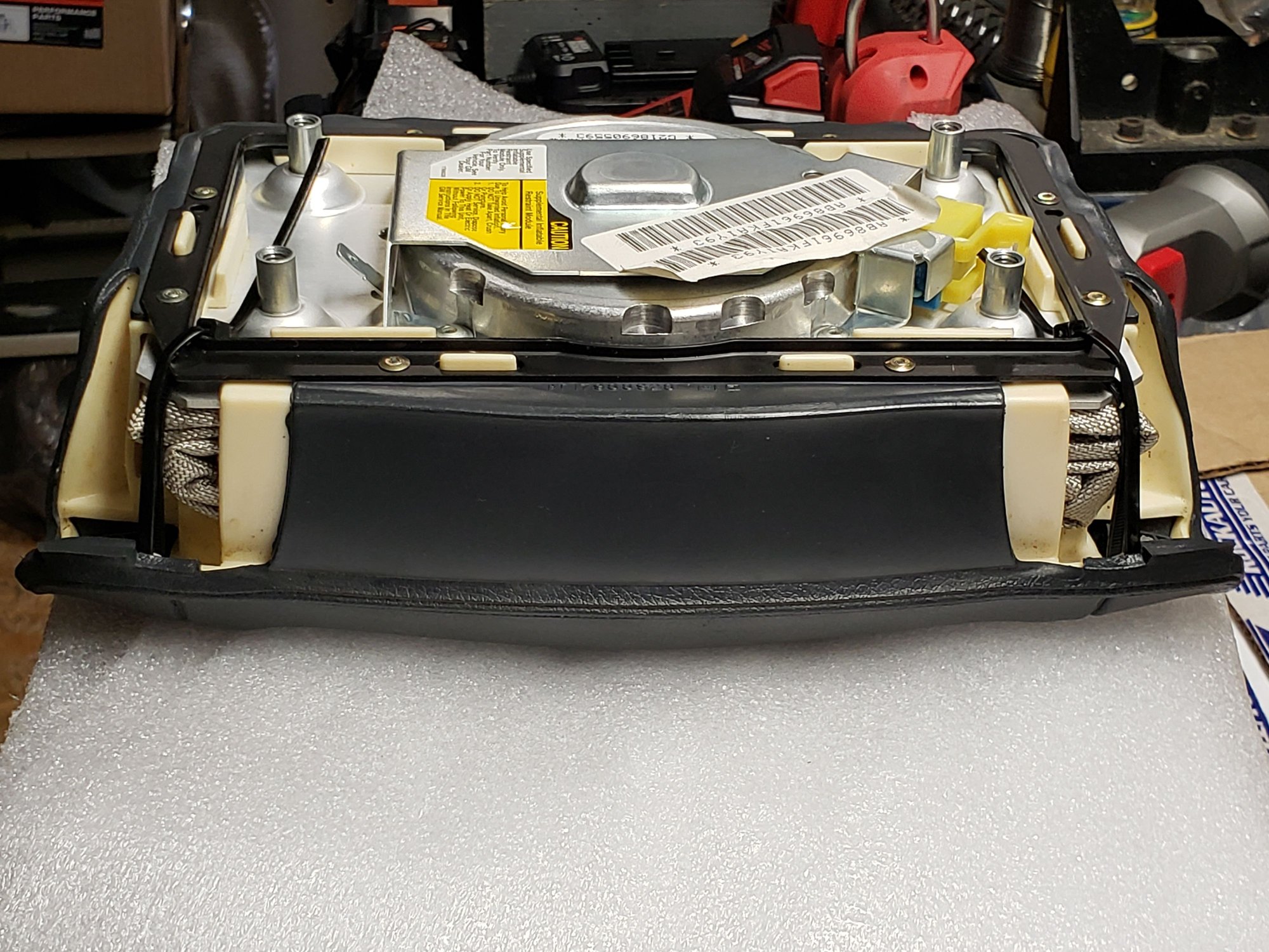

Airbag Modification:

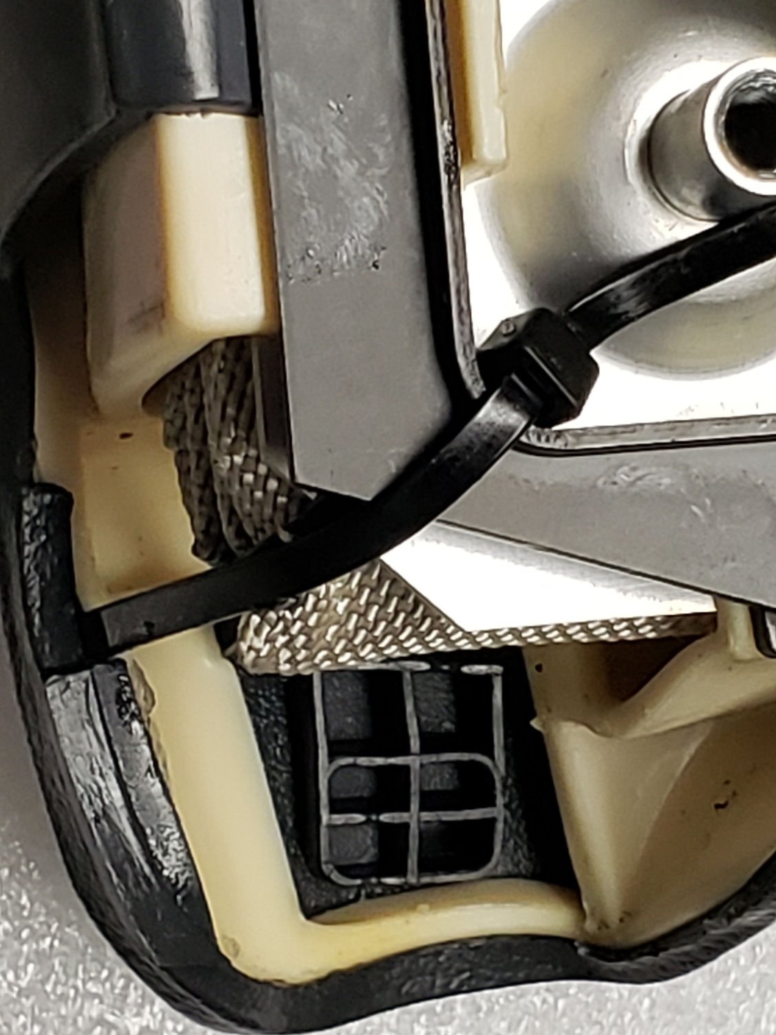

I used zip ties to pull back the white plastic, which straitens out horn button flap area. If located exactly as shown in these pictures, they will not interfere with wheel when airbag is re-installed. If the white plastic is cracked on your wheel this fix will not work. I tightened the zip tie until horn grey flap was straight across, even with top of airbag as shown below.

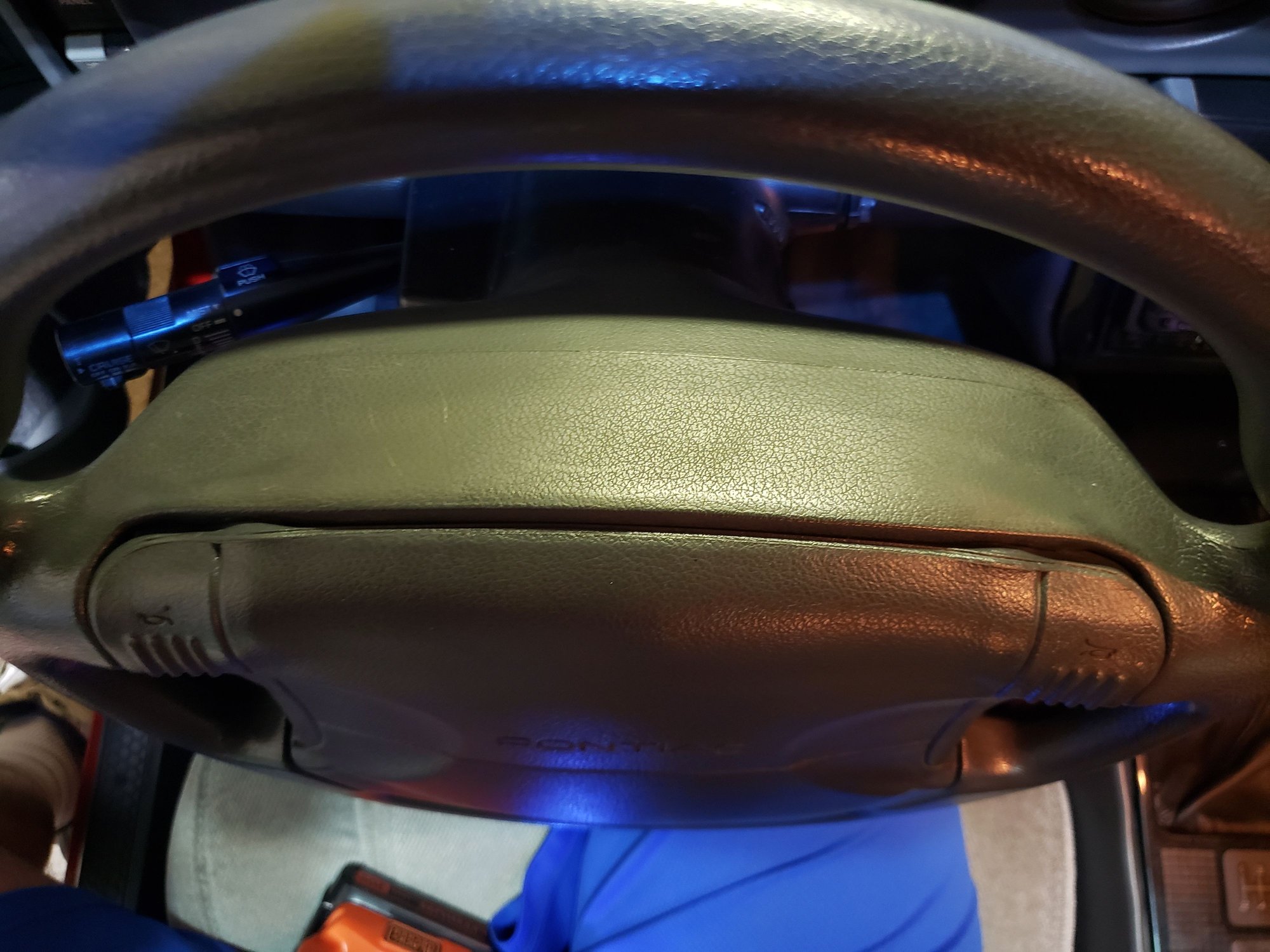

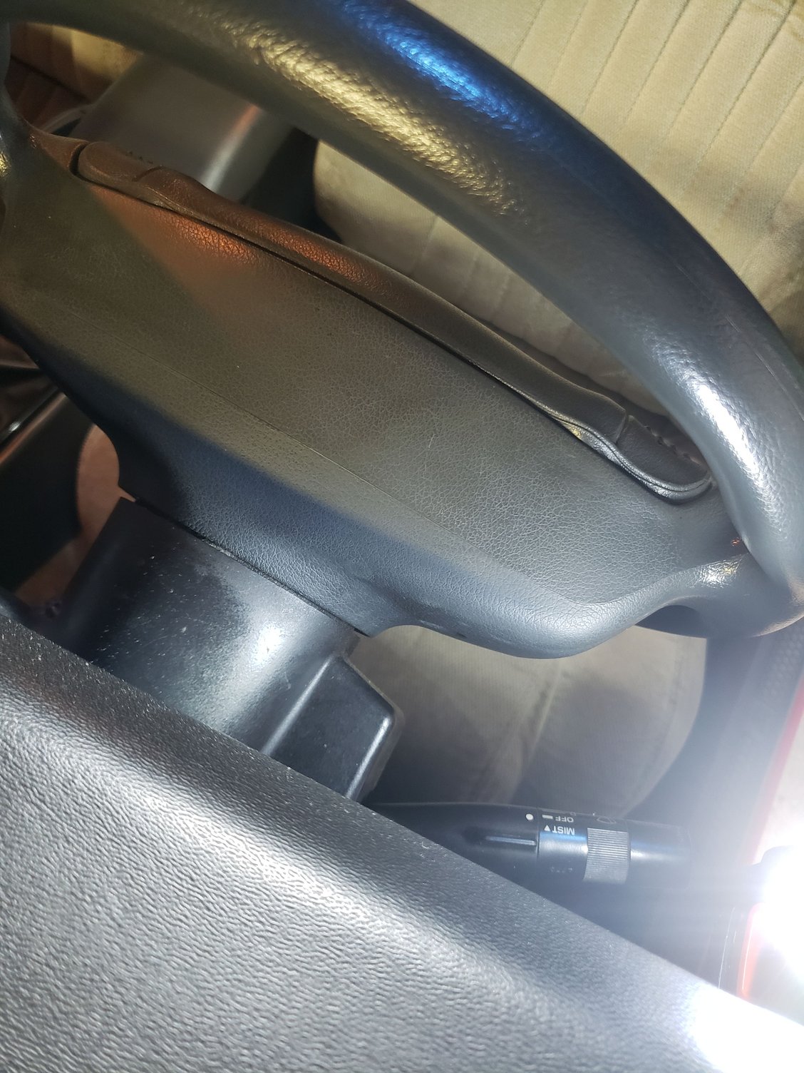

I placed airbag back in wheel and retightened. I did add shims (washers) to screws to move out airbag as it was originally sitting too deep in wheel. As a point of reference, my horn flap looked exactly like the picture in the original post above. Here are the final installed pics:

Huge improvement!
Thank you for sharing - I might do this on my 91 soon.
