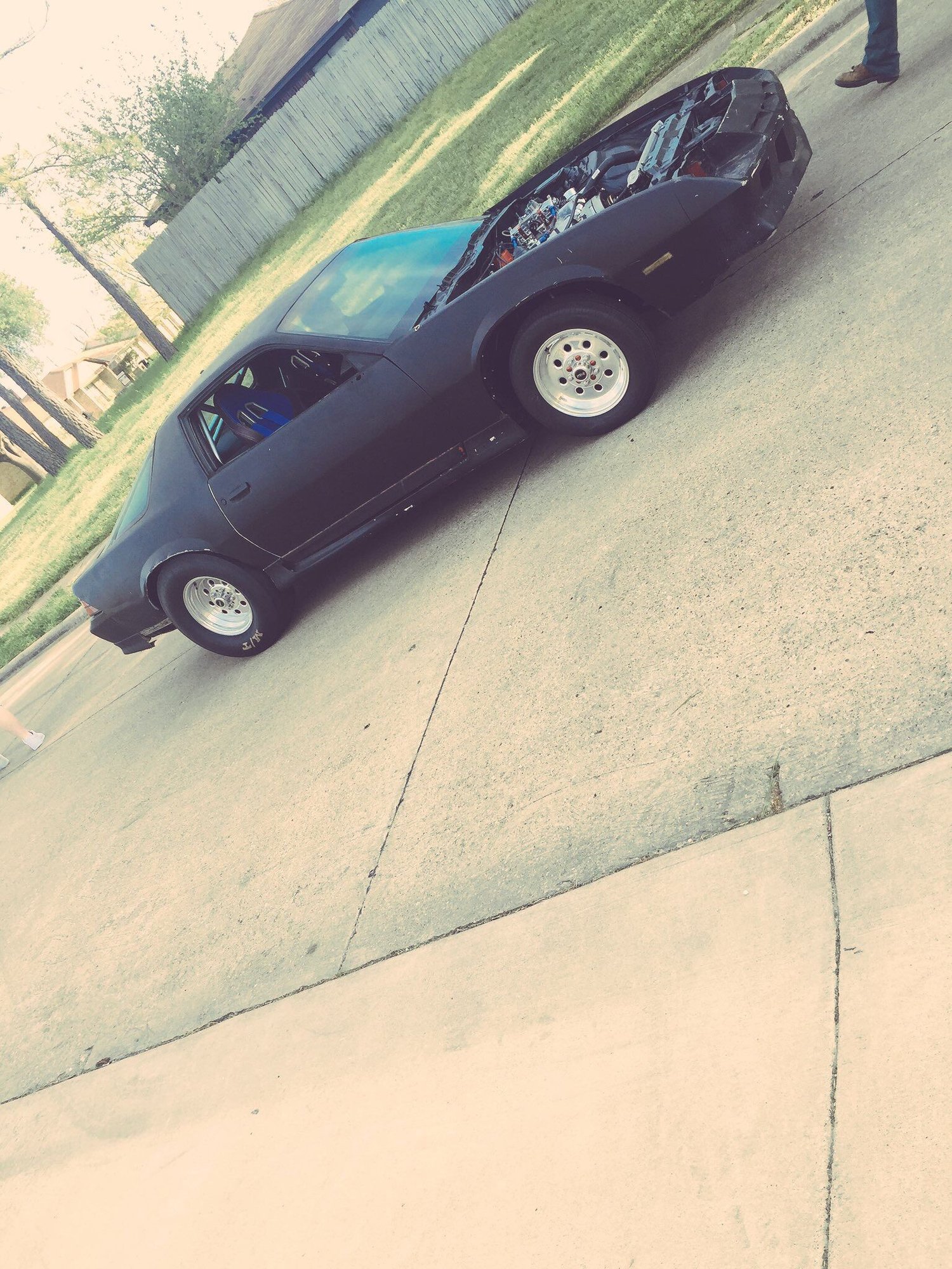

Well i got the 29.5 to fit without cutting the fender.. No rubs. no body lift. i kept the same spring i had in it. I rolled the heck out of the fenders though. im cleaning them up now so they dont look so bad. pulled the left front just on motor.. lol not a bad set up for no burnout and 3/4 throttle.. lol Thank you guys for the ideas.

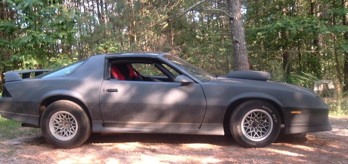

Here is mine with 275/60-15 Nittos (27.76" Diameter)
Here is the same car, with same tires but before I added the drag bags and Iroc springs
