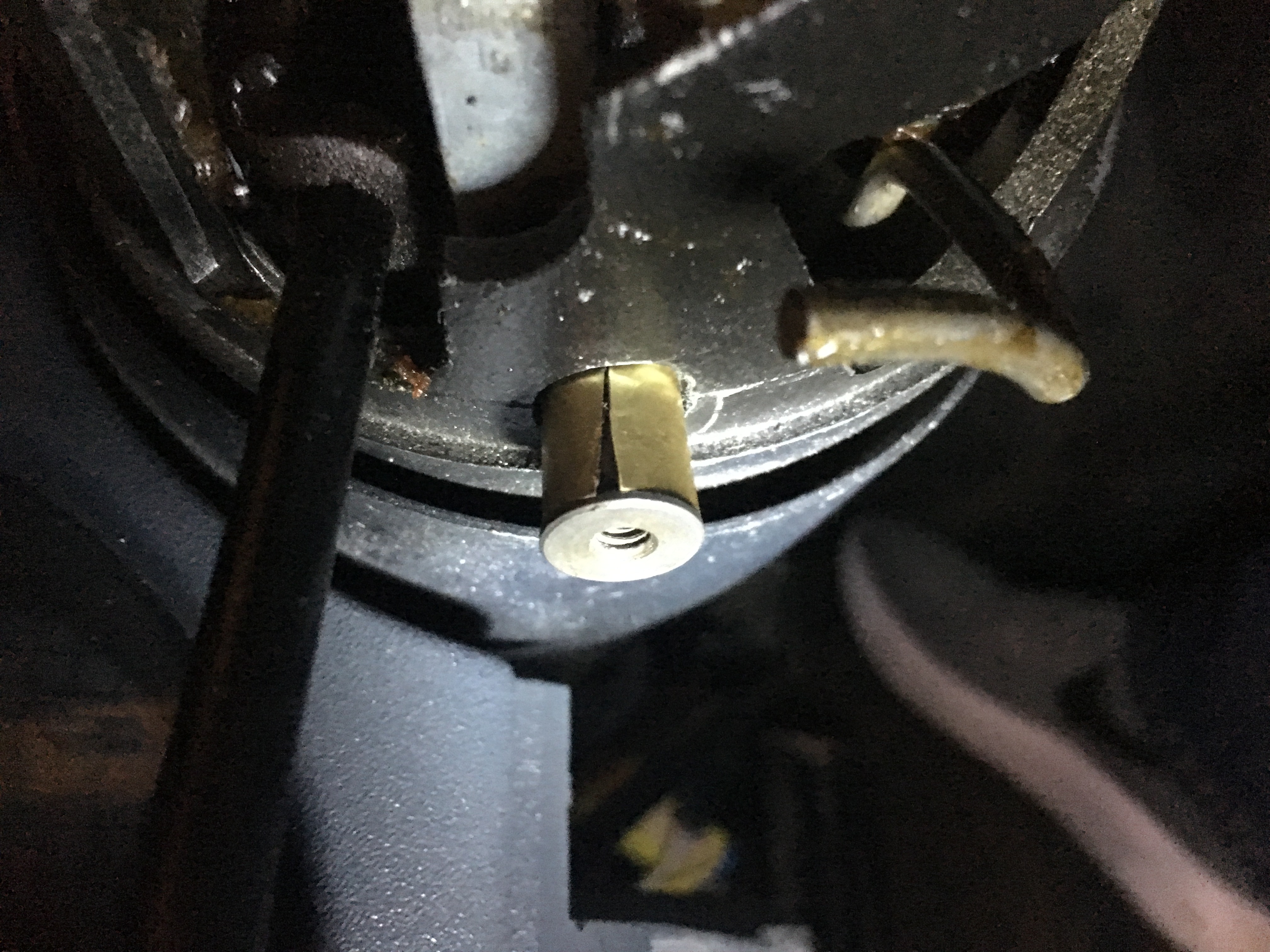

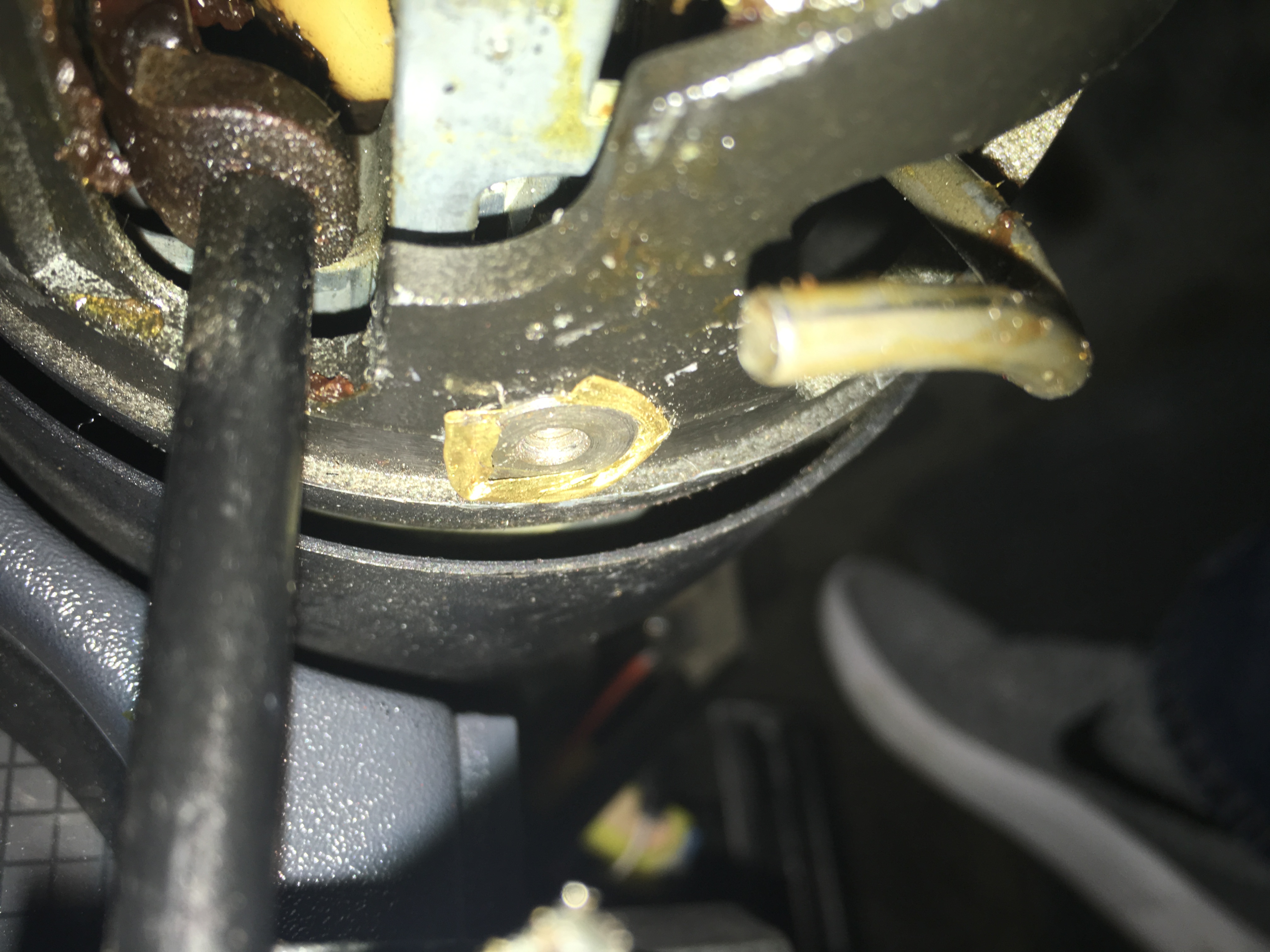

I thought I'd post this in case anyone wanted a temp. solution to the 7 o clock tilt steering wheel issue caused by the loose left hand side pivot pin.
I went to orchard and bought a brass sheet 4 x 10" that's 0.005" thick.
I then cut off a small rectangular peice that will fit around the pivot pin and smashed it in. I'm going to set the tilt and forget it and hope it lasts me a while. Also will be making sure I don't use the wheel to get in/out of the car.
Here's some pictures ... not the nicest looking but it's super tight now and doesn't move at all...

Here's a few threads on the matter and some links of oversized pin sellers. Navy02ws6 is right. The issue is that the steering wheel moves down about 1/2" in the 7 o clock direction the springs back up. The issue seems pretty common on these tilt steering wheel setups found in GM, Jeeps, and not sure what other vehicles.
