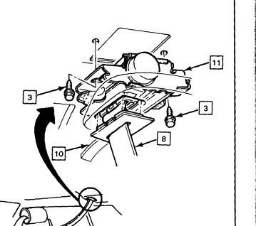

So the service manual does not specify left or right. I did take some pics of the passenger belt and noted the stitching. see below. note the belt comes through the buckle tab from the outside and is sowed on the inside. The driver side is the same. you could use this to determine which is the passenger and the driver belts. All I have is a schematic of the upper retracter. not very detailed but the cylinder looks like it goes to the back. the plastic trim peaces on the bottom are specific to each side.
Not sure if any of this helps.

thank you very much. makes sense. much appreciated.

You can tell what side they're for from by the plastic cover.It only fits the mount/door sill one way. The upper part uses a pin on one side by the bolt that fits into a hole on the body when installed correctly.
