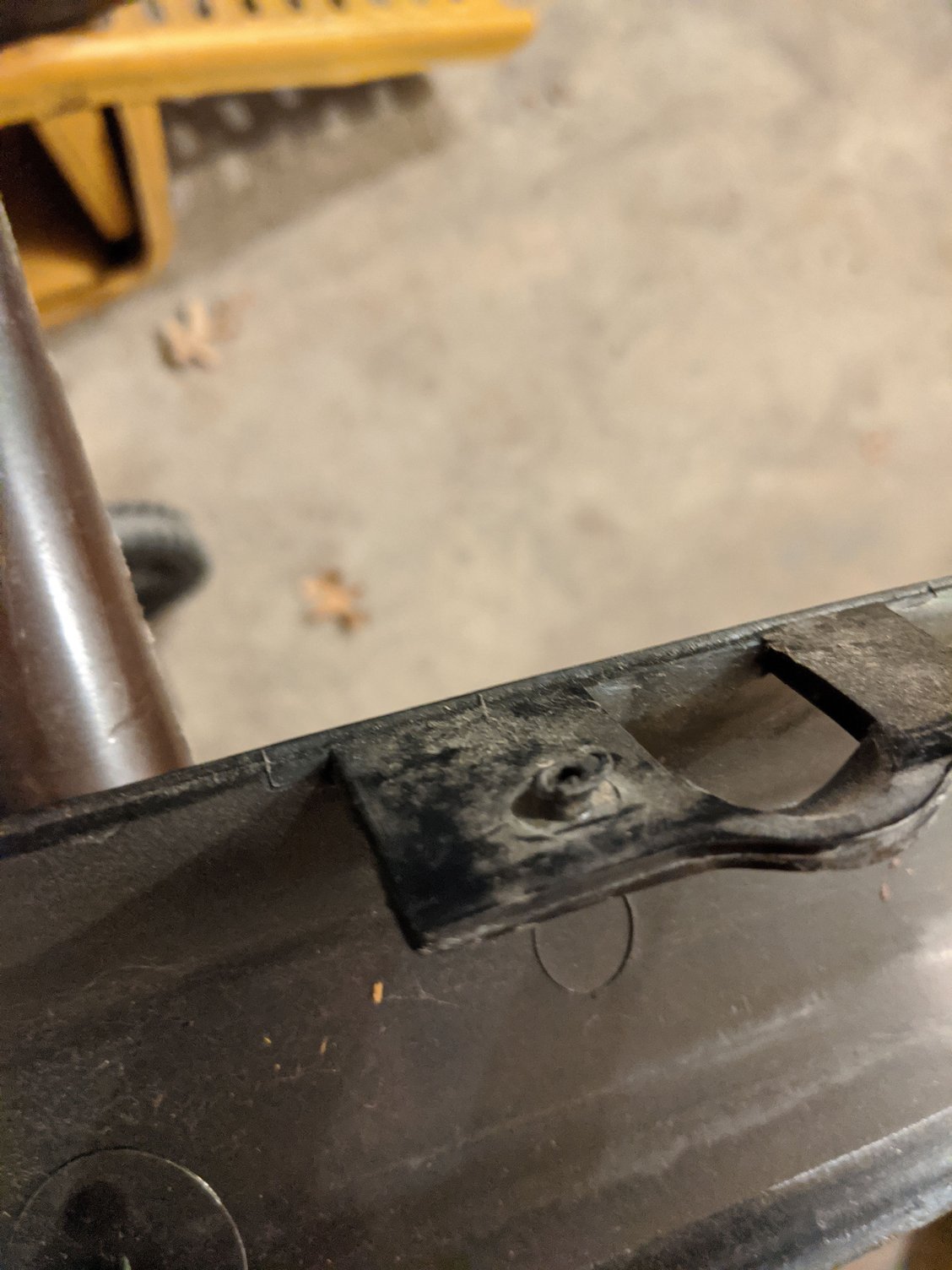

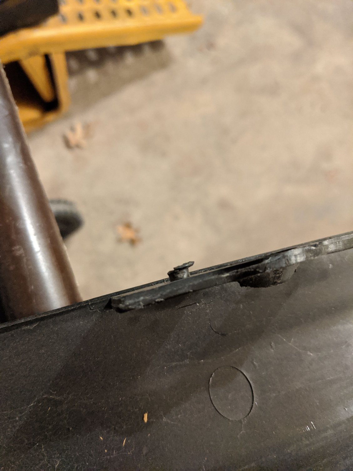

Hey guys,
I'm having a bit of trouble installing my new window sweeps. First of all, the old ones were held on by a single heavy duty staple, and were pressed onto the inner window molding. the pegs that hook into the window sweep fabric don't seem to have a hole in them for a legit fastener, and all my pegs seem to be broken (see pics).
Also, how do the window moldings attach to the door itself? I see some pressed on washer-type fasteners, but don't see how these interface with the inner part of the door.
Am i doing something wrong, or are these really just held in by the pegs, and I need new moldings?
retention peg is snapped off on one side
how do these attach to the door?

Originally the peg was longer. The weatherstrip was laid over the pegs, then a machine melted the end of the pegs to peen them over like a rivet. That was a one time deal, you've gotta get creative with aftermarket parts since GM never expected the weatherstrip to be serviced.

Well, that's really helpful, thanks GM! Thank you for the info, I'll probably do some sort of rivet or short fastener and adhesive to install the sweep. As for the installation of the trim piece to the door itself, does it just clip on, or is it fastened in some way?
