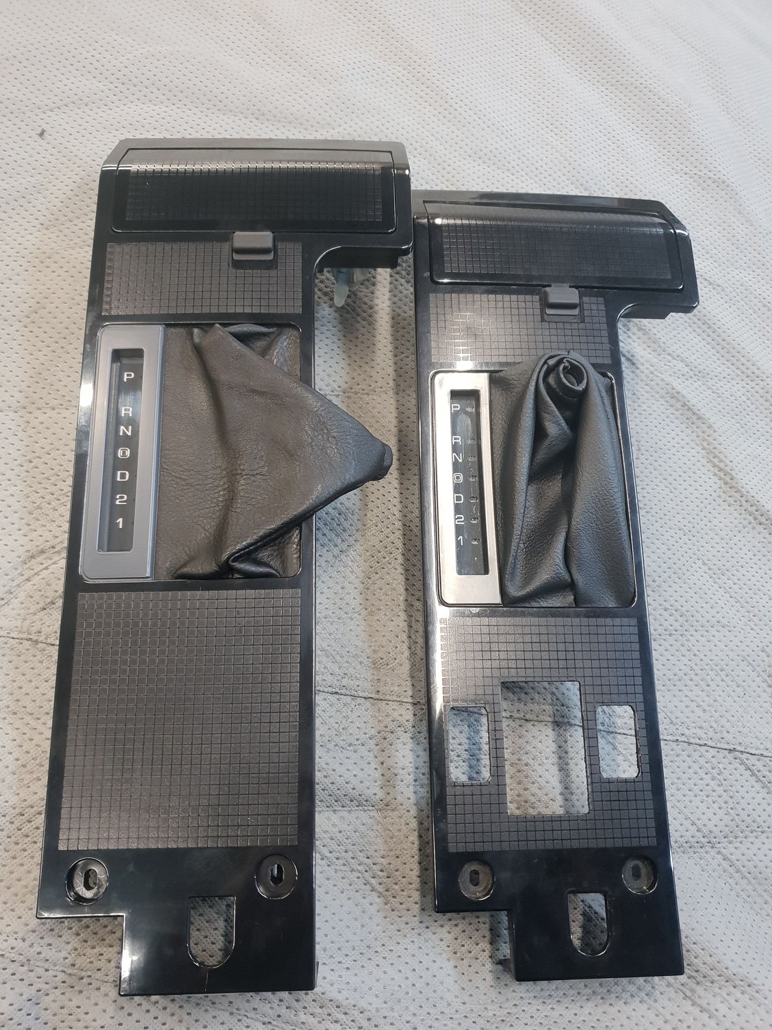

Ok, here are a few pics of the firebird piece.
First, the OE on the right and the repro on the left compared to each other. The material of the boot is different, clearly visible. This isn't bad at all, just wanted to mention it.

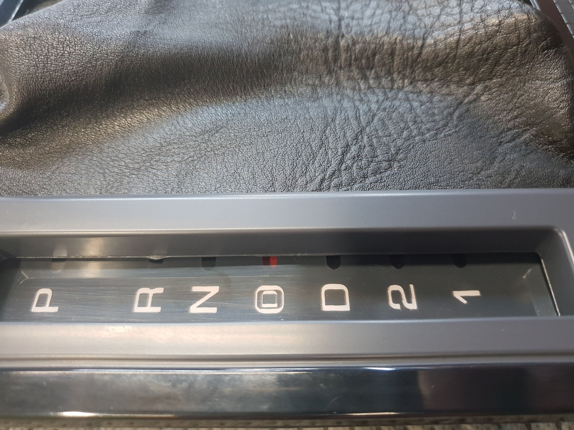

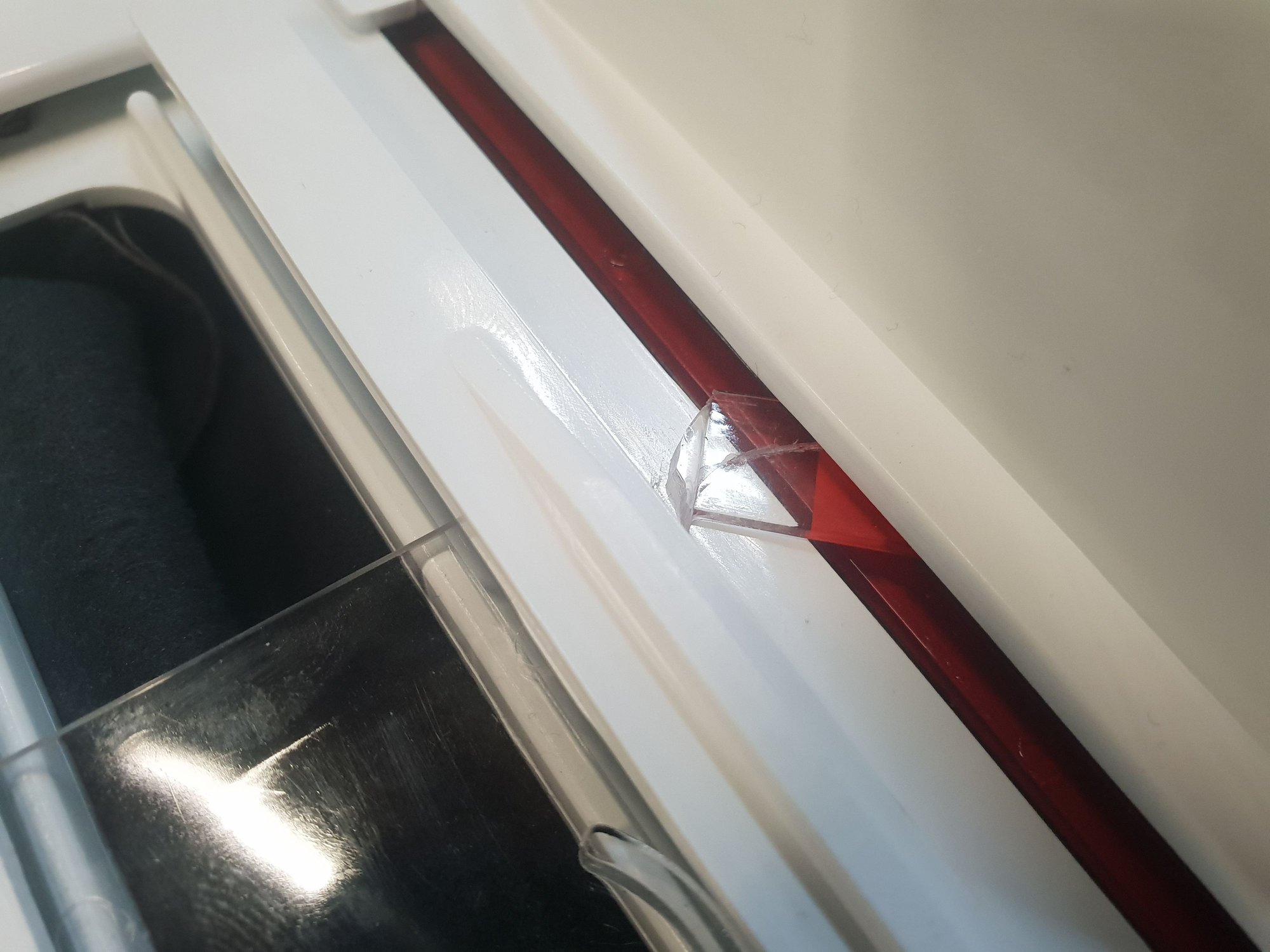

Here is the indicator. As you can see, the indicator is only half visible and hides under the casting partially... when I recognized it, I was wondering about it and disassembled everything to see whats wrong...

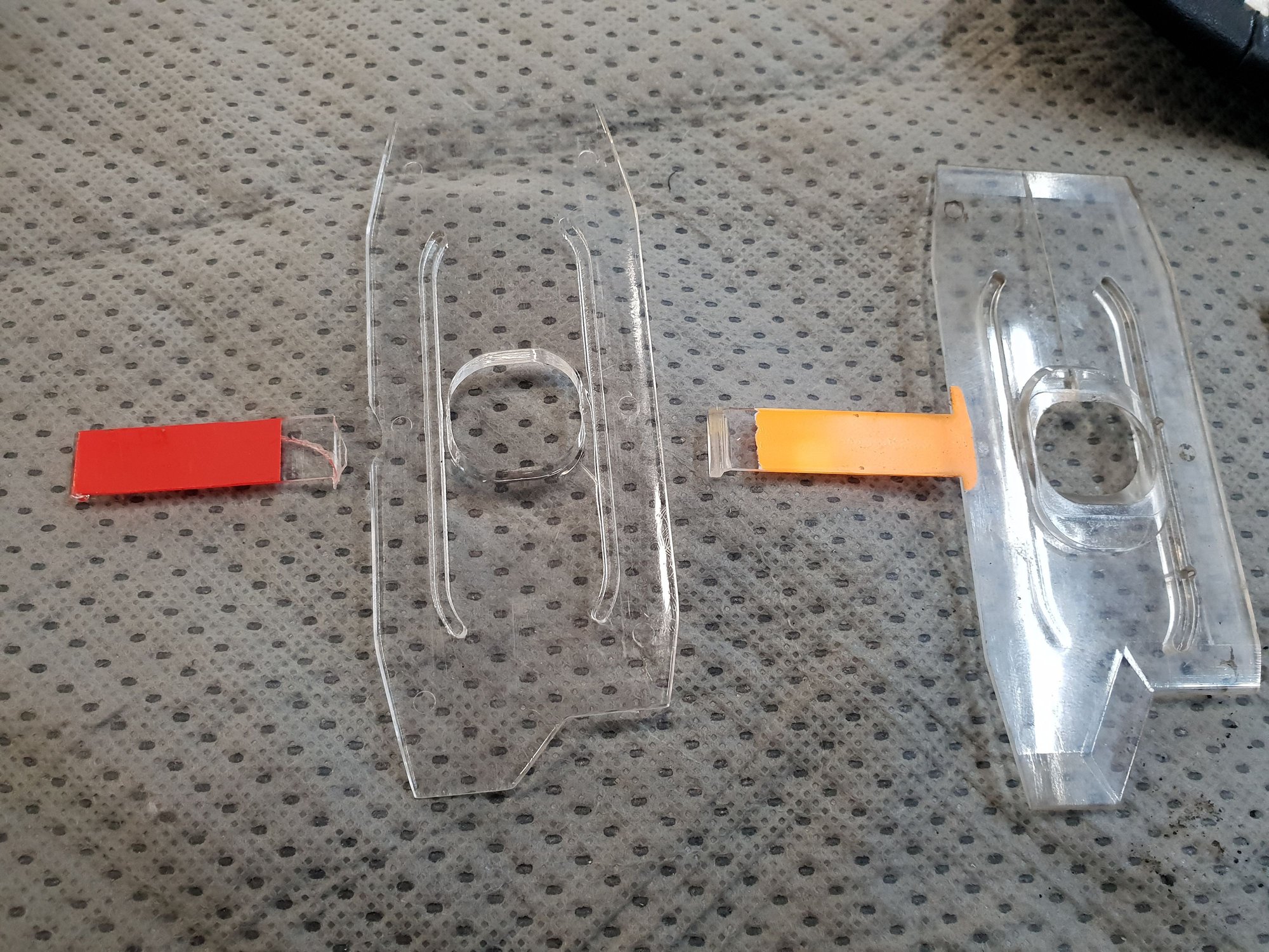

Then this came to me... the indicator tab is absolutely flimsy, it must have been broken in the box before I opened it...

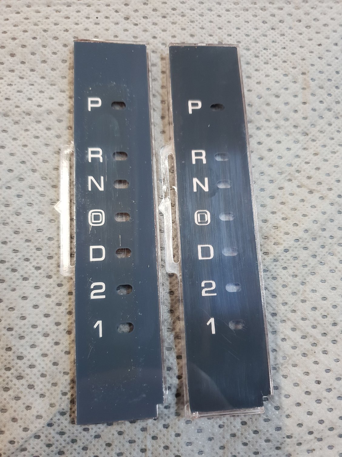

Then I compared the indicators directly to each other. OE piece on the left, repro piece on the right. You can see that the writing is different, kind of blurred or just cheaply printed out. But it the position of the PRND meets the position of the OE piece... weird, why is it hiding under the console casting?
Whole different colors of the indicator tabs... OE on the right, repro broken on the left.

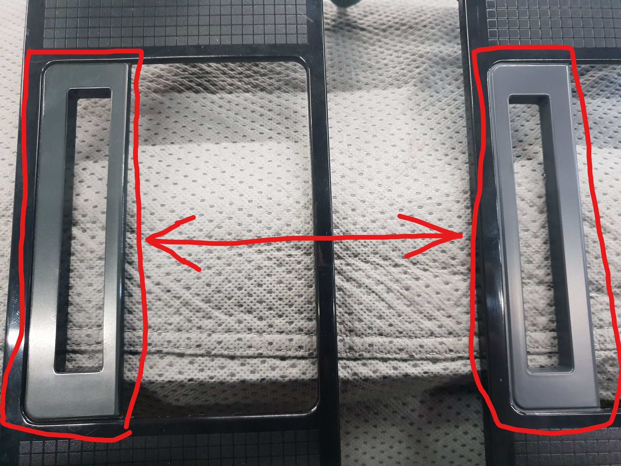

After a few minutes of head scratching wtf ist going on and why the indicator isn't fully visible on the repro plate... I found the issue. It is just casted wrong. If you compare both "indicator housings" directly next to each other you will see, it is just casted upside down! Turned 180 degree... I couldn't believe it. On the left is the OE plate, on the right the replacement. On the OE plate the wider parts of the indicator housing are on the left and on the bottom. On the repro plate it's vice versa! This is the reaseon for the only half visible indicator.

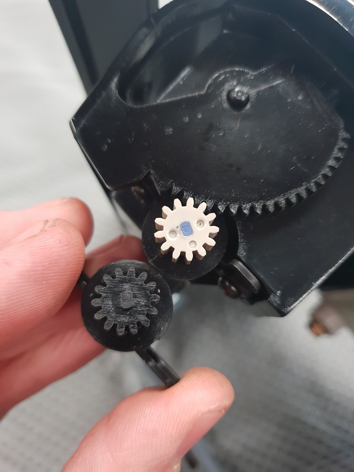

And the little repro gear (left) that opens the ashtray smoothly compared to the OE (right)... well, it didn't open. The gear was stuck and hard to turn, when you pulled the release button nothing happend. The consequence was, it broke shortly after this pic.
Well, is it just me? Am I picky because of being a german? I mean, how can you release a product to your customers that is not only made of cheap materials and also just casted wrong? I couldn't live with this crap. Everytime I looked down to the gear indicator I felt a hard headache with the only half visible indocator. So I bought an (expensive) used OE plate in good condition.

Kinda looks like they mixed parts of the later Firebird design and earlier design. In 85 the Firebird didn't have an indicator, just the shift pattern, and the thinner pleather boot. By 91 they'd added the indicator and gone to a heavier bumpy grain boot. For what they charge, the part should be correct.

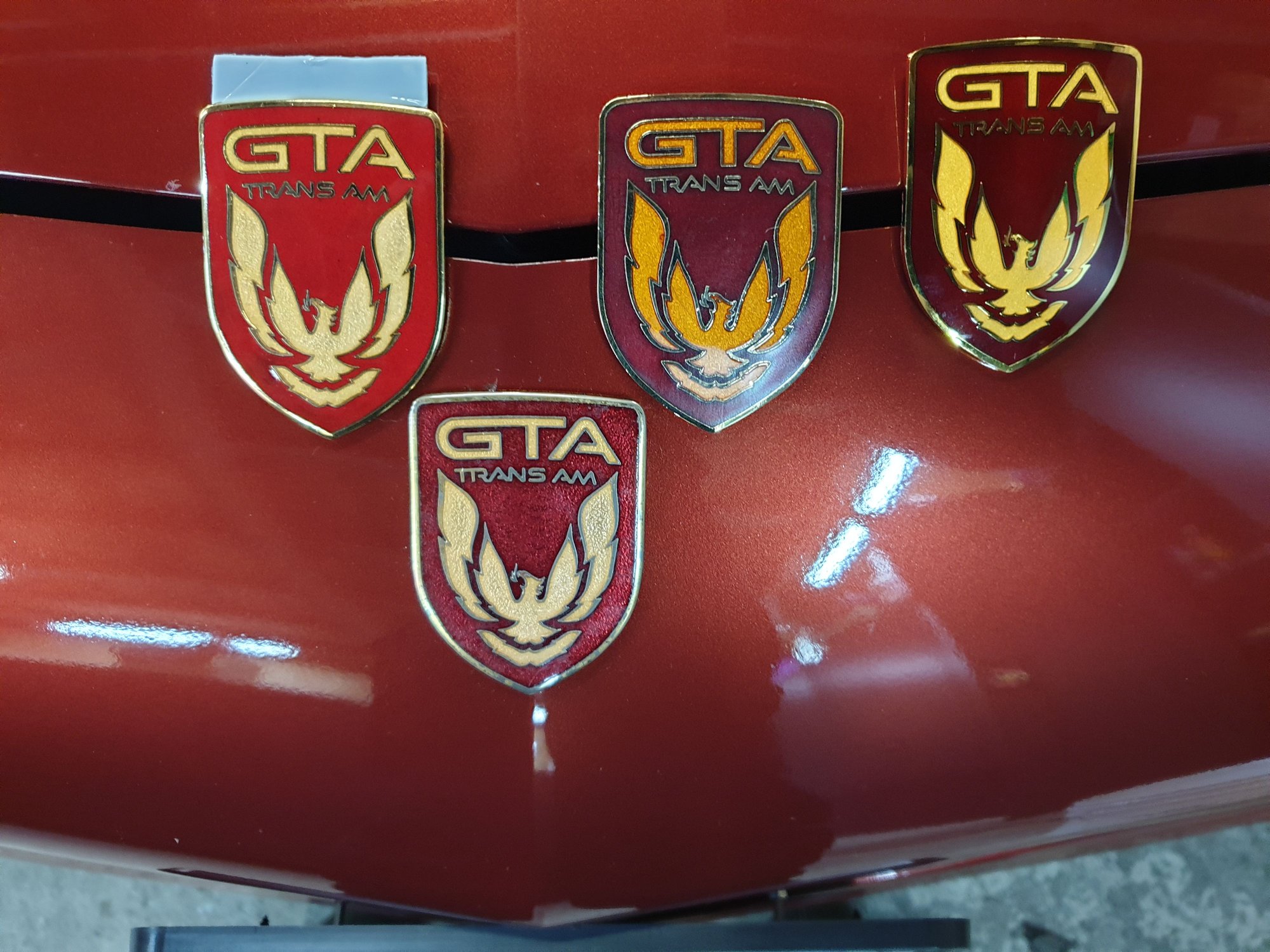

That's exactly what I think. If you reproduce something, why is it in most cases crap right out of the box? I don't get it... all the effort reproducing these things... and in the end it's not even close to original.
Same thing with the GTA emblems, all reproductions I have seen so far are completely different to the original emblems.
From left to right: NOS original emblem, should have been flame red but it is definitely bright red, someone put a wrong label on it... next is my original factory emblem still on the correct position. Next is a repro from car motorsports and the last one is from hawks...and they all swear the do GM licensed and 100% repros... just talking big and deliver crap. Car motorsports and hawks don't even fit the bumper, they are flat and not slightly curved to fit the bumper like the original. I can't understand how they still sell these parts that are useless in some ways.

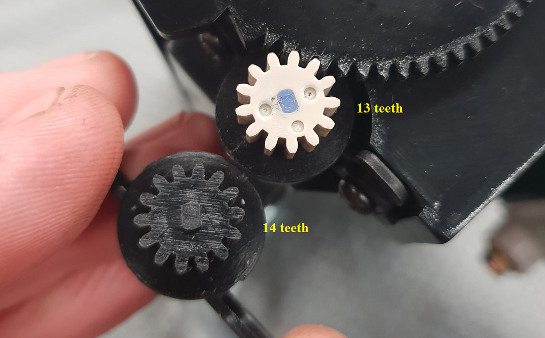

Did anyone else notice this?
That might be the reason why it was so hard to open and cracked... oh boy, what an epic fail...
