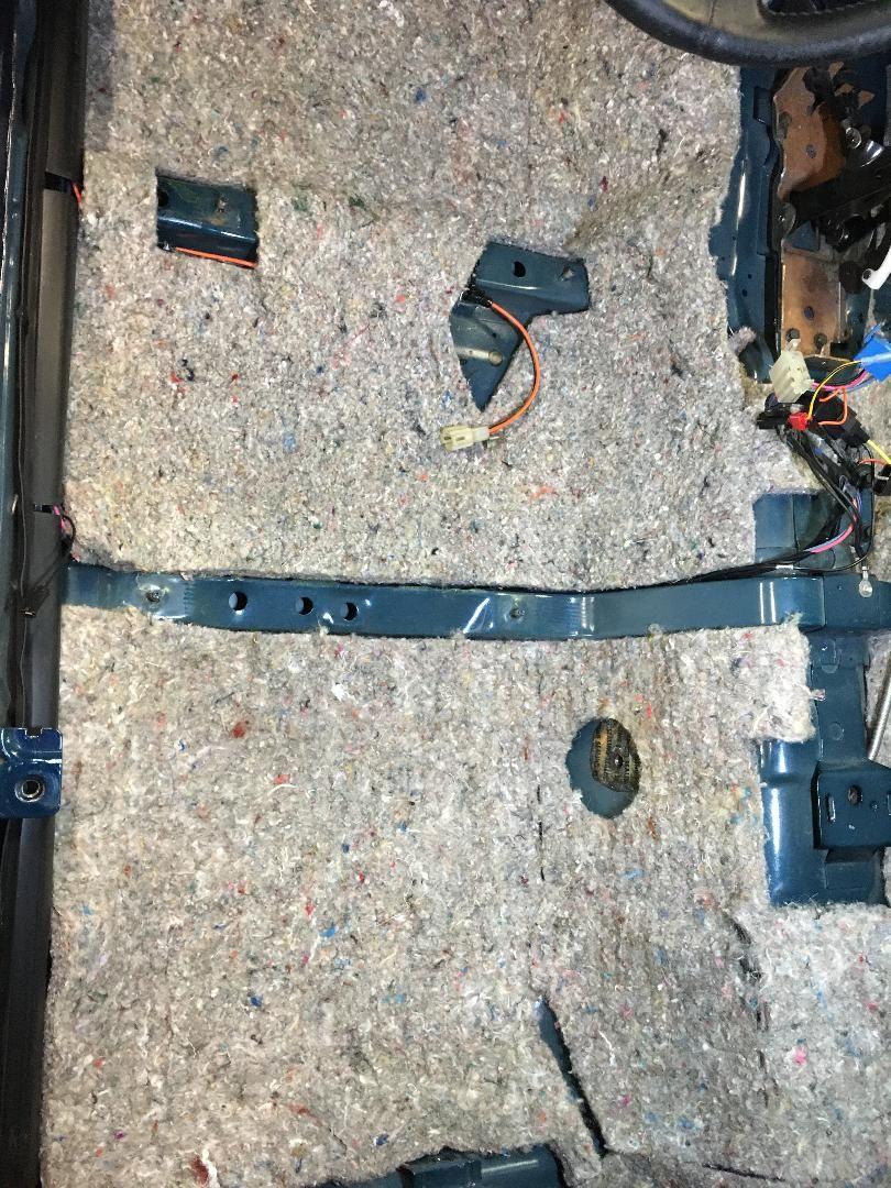

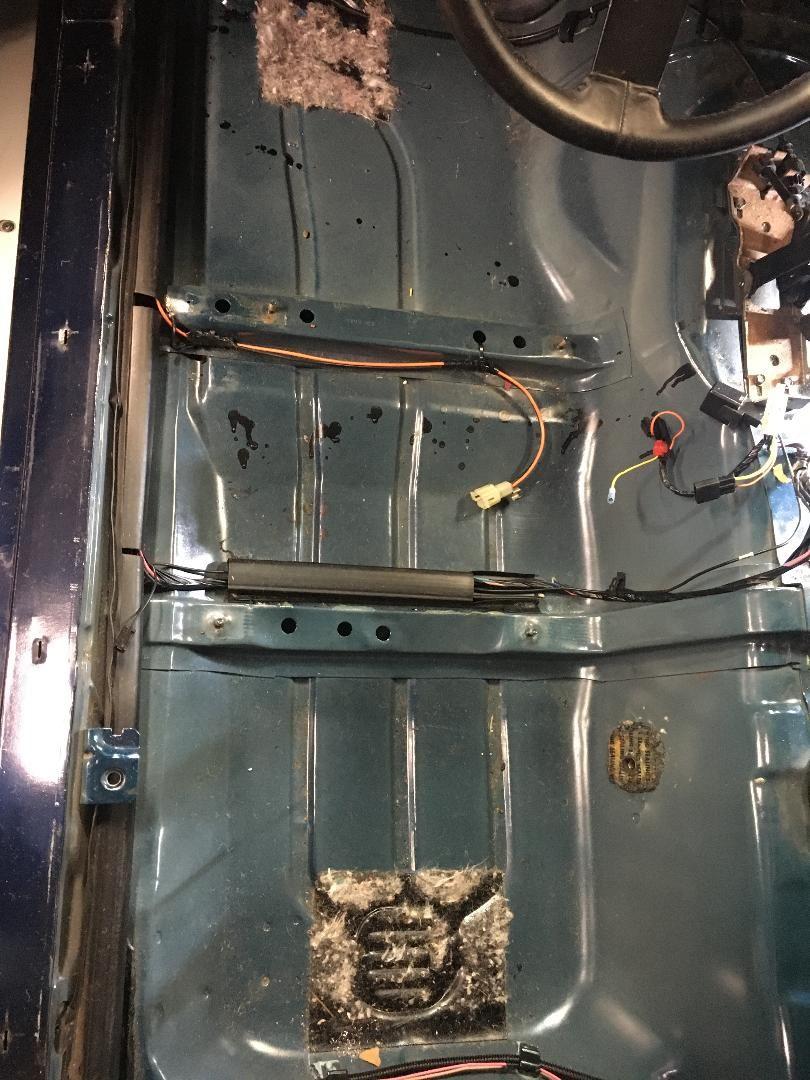

ACC carpet and jute padding question
I'm in need of some advice. I've thoroughly searched the forums and didn't really find the info I need. I'm finally replacing my 33 year old carpet with ACC cut-pile with mass backing. It came with jute padding glued to the back, but thinner and in less areas than the factory jute padding. The factory padding came off the stock carpet rather easily and is in great shape. It fits into the floor pan areas very well so I'd like to re-use it. Would doubling up the jute make the carpet sit too high or should I tear the jute off the new carpet and just use the factory jute? I'd like to get some ideas before I start fitting the carpet so I don't have to pull it back out. Thanks all!

If it was me, i would take off the ACC padding and use the OE stuff.I probably glue it to the new carpet too.

The old padding likely has odors not readily apparent. If it was my car, I'd toss it. When I installed OCC Mass backed cut pile (their best) in my 1996 Impala SS, I discarded to original stuff. I had to fiddle with and trim the ACC to fit. That was very annoying!

Thanks for the input. I know it going to be a fight fitting this thing properly but I’m going to take it slow!

I don'y understand why the fitting fight. On the factory assembly line, they toss the carpet in and center. Done.

It’s an aftermarket kinda thing. Even the best stuff is close but never perfect. I’ve replaced many OEM carpets (in different makes & models) and they fit right in straight out of the box.

Thanks for your response, to my (mostly) rhetorical question. In my 25+ years of professional automotive experience, and decades of hobby automotive work, I have learned to REALLY dislike the majority of aftermarket parts and "modifications".

I wouldn't use the old jute padding either. I realize sometimes aftermarket isn't perfect, but when it comes to soft items that absorb years of smells, dirty moisture and whatever else, I'd rather have new. By the way, what color gray is that called?

I definitely understand what you’re saying. The jute on the back of the replacement is just so thin and seems incomplete. I’m considering putting the OEM in a tub with soapy water, rinsing, and letting it drip dry completely, if only to see what happens.
The color is called Dove Gray. It’s a perfect match to the unfaded areas under the rear seats.

Quick update to my thread. I'm just about finished with the install. I tore off the new jute padding from the back of the new carpet. It seemed a bit thin and didn't have the same coverage that the oem had. I re-used the thoroughly cleaned oem jute. As for the ACC carpet itself, the fit is pretty good with the exception of a few areas. It was tough getting it to conform to the trans tunnel but it's close now. The dead pedal pad is kind of in the wrong spot but I can live with it, especially with the floor mats in place. Considering there's not many options these days for carpet I'm overall happy. If you're buying the ACC get it from RockAuto, just a little over $200 and $20 to ship.
