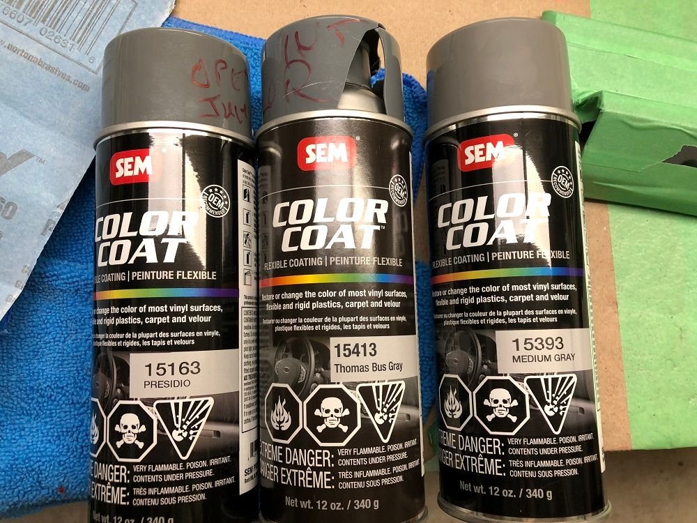

all these panels vary in color, the one you need looks like the thomas bus grey, 15413
thomas bus is the closest one for firebirds, presido is the one thats closest to the camaro gray

all of these paints will produce varying shades of gray, i've found that the color can be adjusted after painting if you buff it out with white car wax (if you need it lighter) or black car wax if you need it darker
