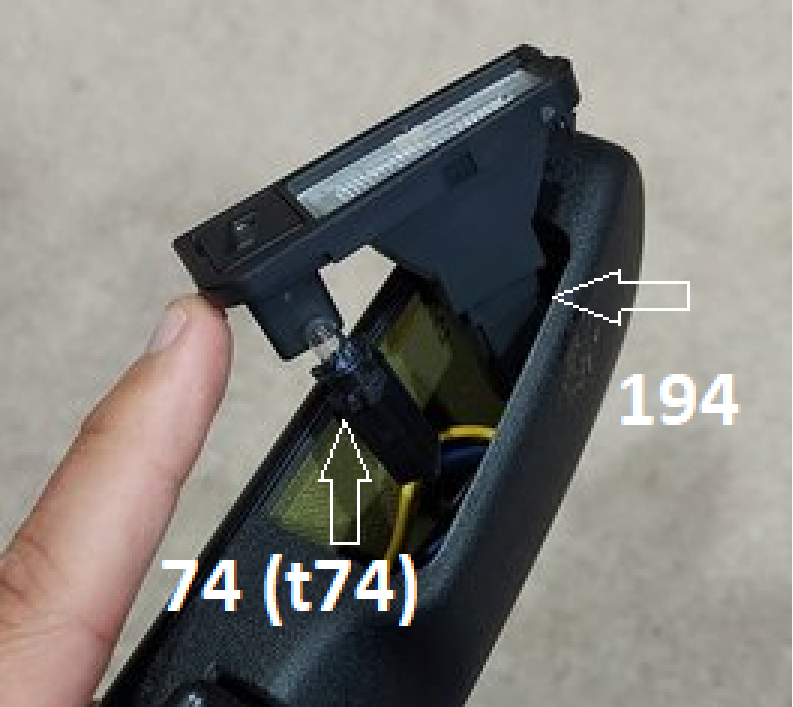

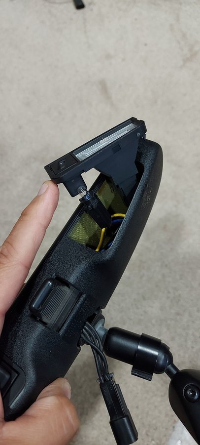

This picture is from a convertible with the single map light switch and a tiny light that remains on all the time (HVAC light). Does anybody know the part number for this tiny bulb?

I realize this post is a few months old, but that tiny bulb is actually a 74, or a T74. Just in case someone is looking for this answer in the future.

The bulb that OP is refering to isn't a 194, as Gunstar mentioned its a 74 bulb which is also used for the an automatic gear selector and the HVAC controls.

We have been installing the 194 bulbs in the lights on the bottom of the mirror for several years, they fit with no issues and work well. I've had them in my 1991 Camaro for 3-4 years with no issues, still work as well as the day I put them in. I can post some pics when I have some time.

I definitely should have looked at the OP's pic closer, that is different from the mirror I see the most of with the 194 lights in the bottom and no 74 lights. Was that a convertible only mirror or late 80's? We have had some convertibles and late 80's 3rd gens in here before, but all had the mirror with the 194 lights only.

FWIW, I believe the ash tray light its also a 74 bulb.
