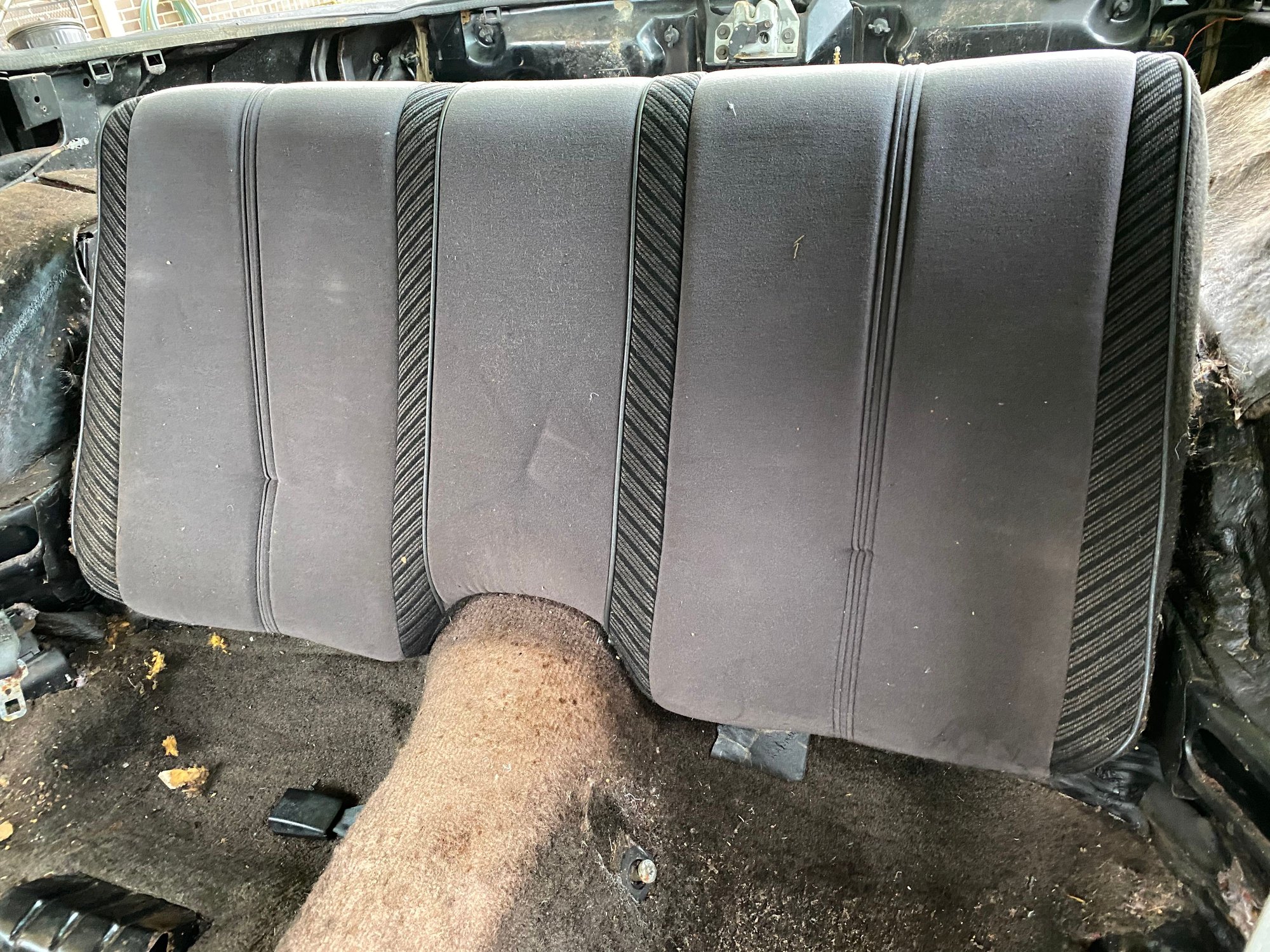

How does this rear seat back come out? The brackets seem to be welded in and I have yet to find where a bolted connection is on it. Anyone??

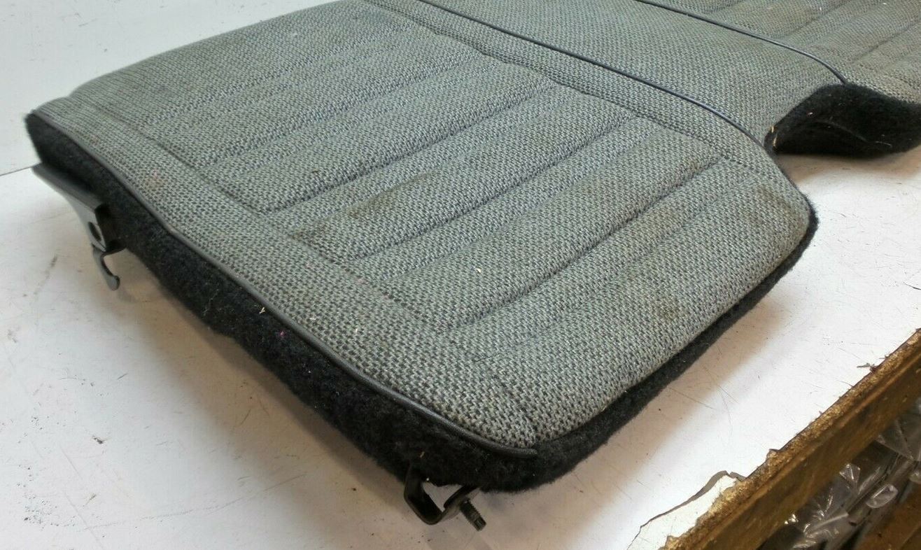

Bottom left and right corner. The hing that allows it to fall forward has a threaded end pointing down. The nut screws UP from below.

You can see the stud without the nut

Thank You!! I actually found it about a half hour before I commented here. Just hadn’t had time to get back on here. Now to get this drivers seat out tonight. 👍👍
