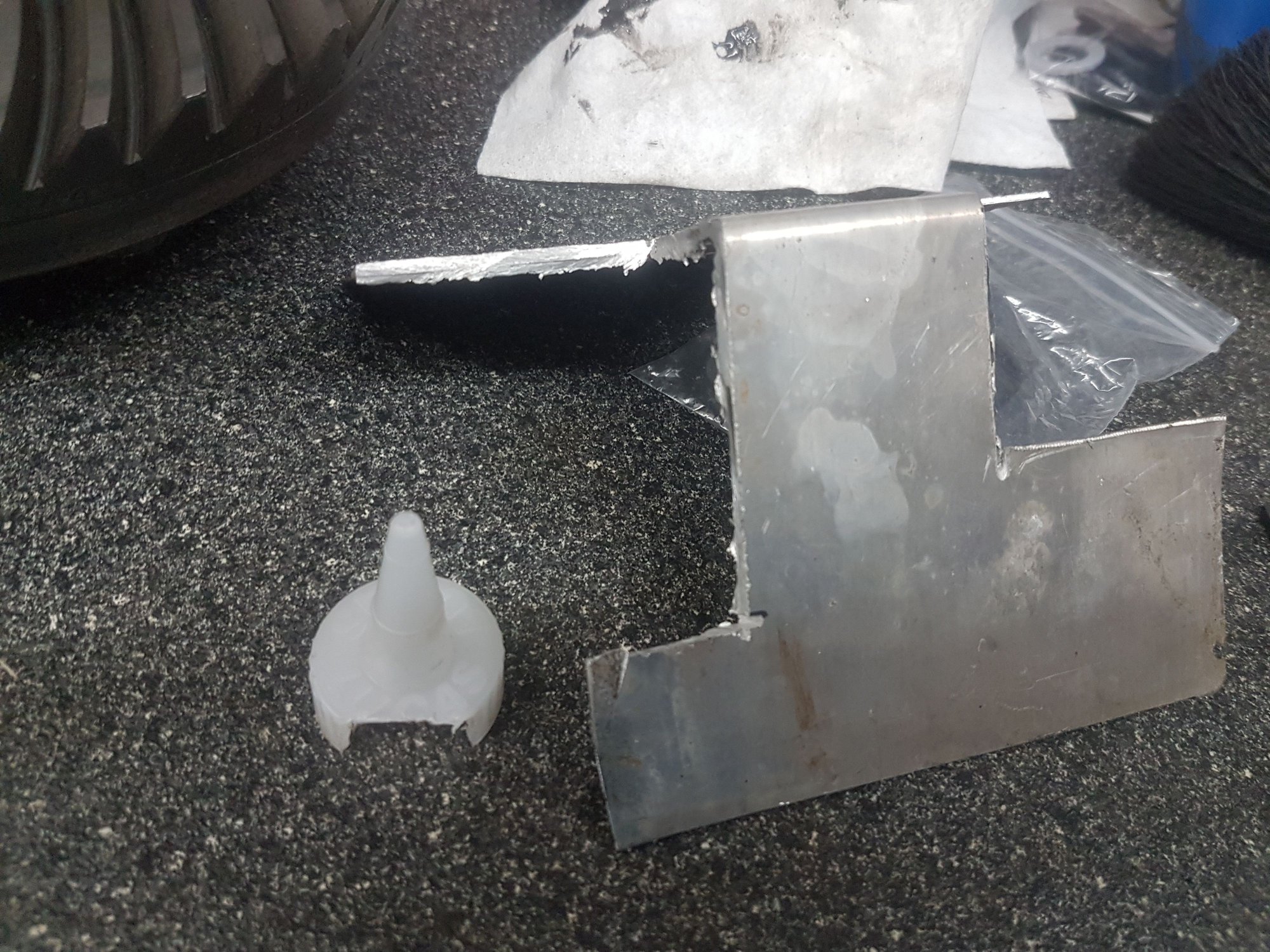

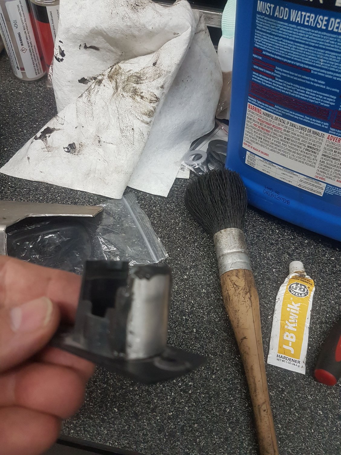

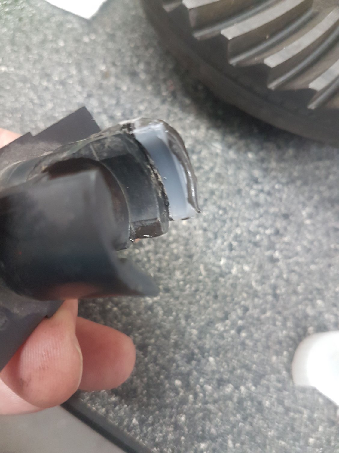

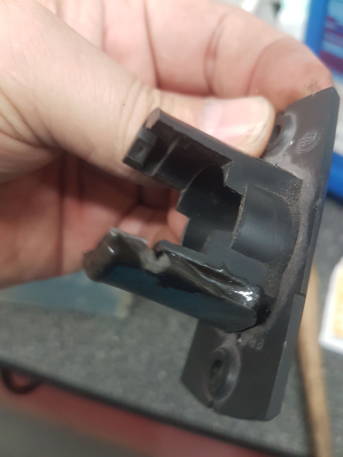

My 87 just was released from body jail and door panels were removed to take off door handles and mirrors and a lot of little stuff is missing for armrests, parts for mirror was missing metal clip that I was able to source then it found the bracket was broken so I decided to repair the part. Grabbed some scrap sheet aluminum I bent it to curved shape around a deep socket then cut it to size. Next was something I could JB qwik that would let the clip retain the lever assembly. Found a gear oil cap that should work part 2 will be attempted install hopefully a good shade tree repair
