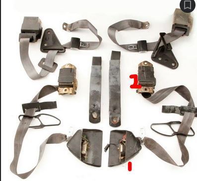

Hey all, I recently ordered some seatbelt replacements from summit that i thought were going to work for me. In most cases the GTA model isn't included so 99.95% of the time the trans am parts are the same but unfortunately seatbelts weren't one of them. I ordered SafeTBoy STBCFB4D model belts which after reviewing the seat belt listings seem to cover all models from 82-92 with bucket seats. https://www.summitracing.com/parts/sao-669906
This new kit only has a retaining buckle on one side and the retraction unit on the other, while the GTA factory belts have 2 retraction units, one on the floor and one on the roof. does anyone have any tips on how to find the right seatbelt set or is my only option using one of these kits and deleting one of the retraction units?

I've not seen new units with dual retractors. 82 model years had a single retractor, in 83 they went to the dual. You can consider having the original ones rebuilt with new webbing, I've done that several times. If you stick with a single retractor style, look for 1982 style sill plates, they are designed with a smaller opening.

Who has these available? I think i might have my factory units rebuilt but in the mean time I guess I'll need to use the 82 style ones i got to get the car inspected.

I had good luck with Safety Restore to rebuild mine. You don't need the 82 sills, it's just a cleaner look vs the dual retractor sill plates that have larger cut outs

The dealer(s) have long since used up all the parts for recalls. They started with the button kit, and towards the end (nearly 20 years ago) they were replacing the entire receiver assembly. At this point, it's unrealistic to expect them to replace the parts.
All the aftermarket belts I've seen are single retractor designs. Most have a bracket to mount the old cover to the door sill so there isn't a gaping hole from a missing part.

Those summit belts in the link are for verts and they look more like the 4th gen vert type than 3rd gen. Or maybe they just used whatever pic they have.

yup.. after i attempted to install them i discovered the retraction unit is designed for vertical install instead of horizontal on the roof like the factory ones. so they are a complete fail, guess i'll have to try getting it inspected as is and then have them rebuilt this winter.
