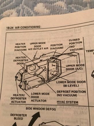

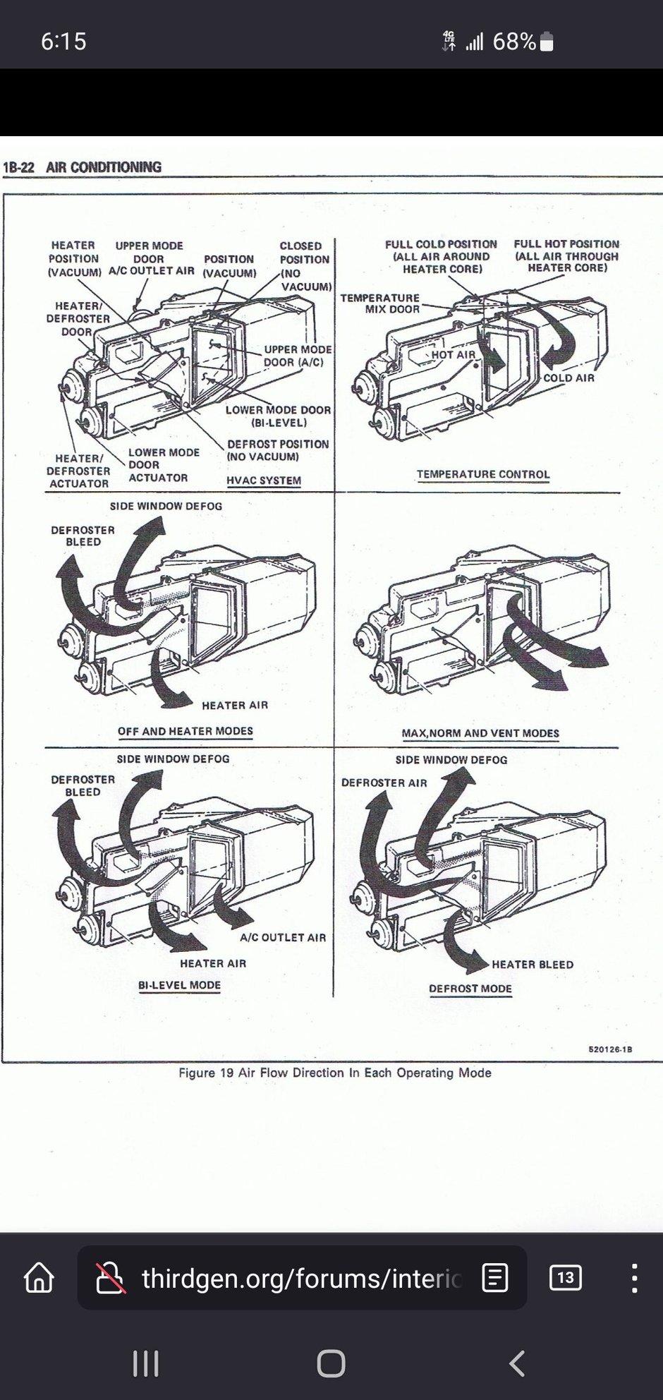

I came across this picture, it looks like I need to access the upper mode door? Is this correct?

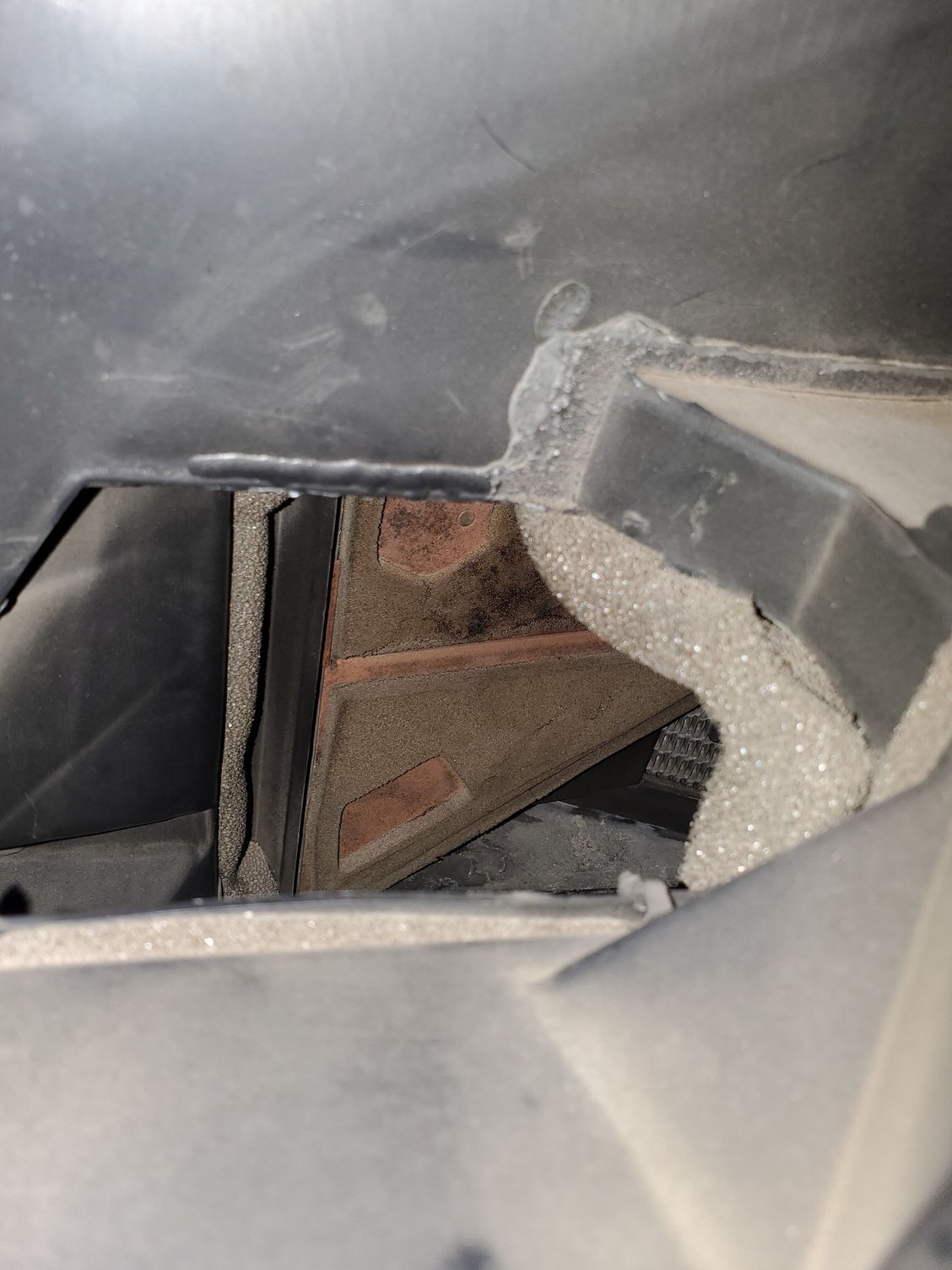

So I've got an update and may honestly leave it this way - I personally never use Bi-Level and only use Heat for my feet when it's cold out.
After jumping around a couple threads I tested something.
I disconnected the RED line (which controls UPPER MODE DOOR) ((the door that wouldn't open for me))
And for testing I connected the BROWN line (which controls LOWER MODE DOOR) to the Red.
To my surprise it works! and on top of that apparently when the upper is opened, it pulls the lower as well.
For some reason the RED line was not producing any suction at all... so something with the line is messed up or the actual Digital Dash motor thing in the passenger's foot well.
-- Here is behind the dash, viewed from driver's foot well, you can see the RED line that connects to it.
-- As I mentioned I connected the BROWN line to it, and it opens both.
Hope this helps someone in the future.
