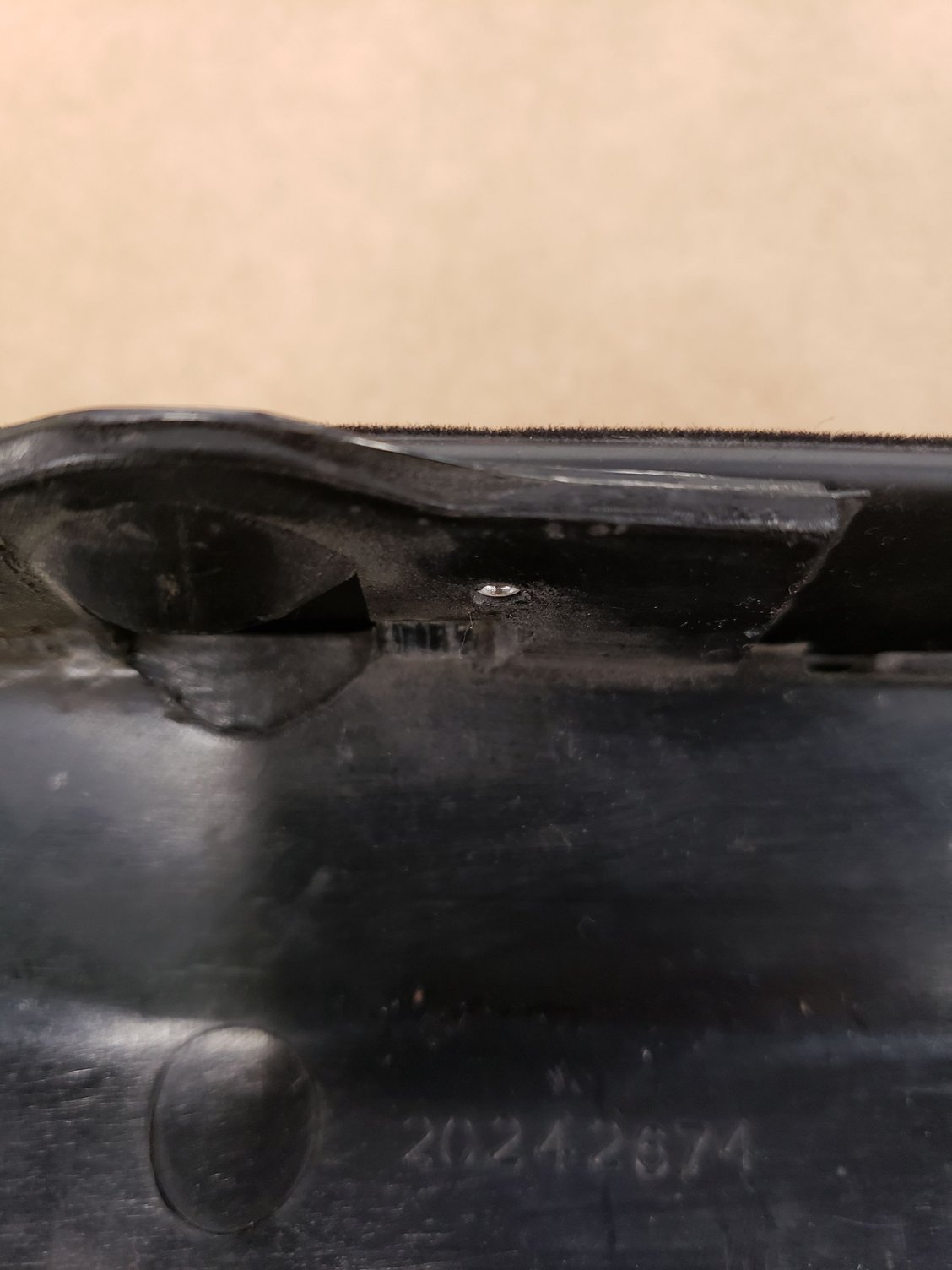

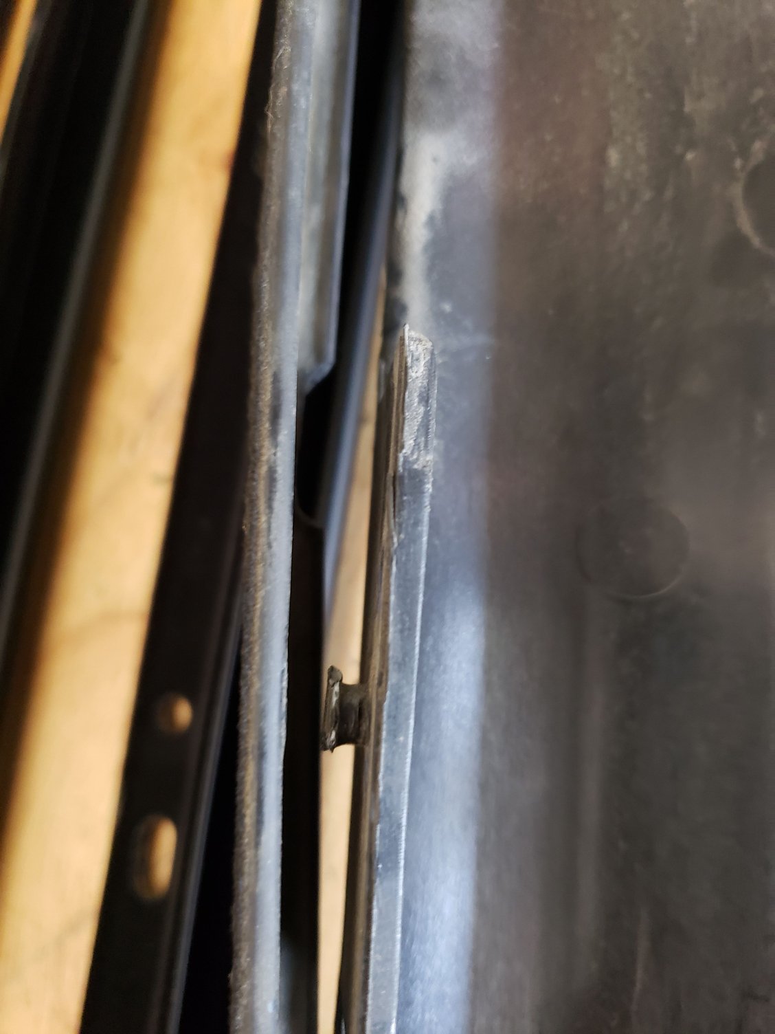

I'm replacing the weatherstripping around the doors. The inner window sweep is held on by these weird little fasteners, kind of like pop rivets, but they don't poke through. A couple have broken off, and it's like they sit flush on the standoffs. What are they, and how do you replace them?

I was thinking I maybe could pop rivet and grind down the tails. They would have to be just about flush though, because the backside rest against the door structure. Not much there to bite.

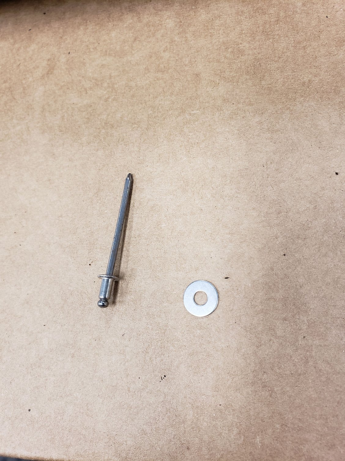

Re: Window inner sweep fasteners

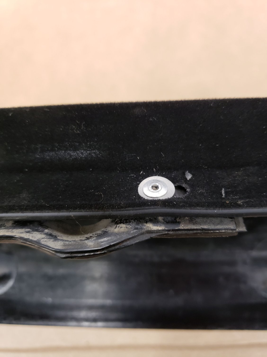

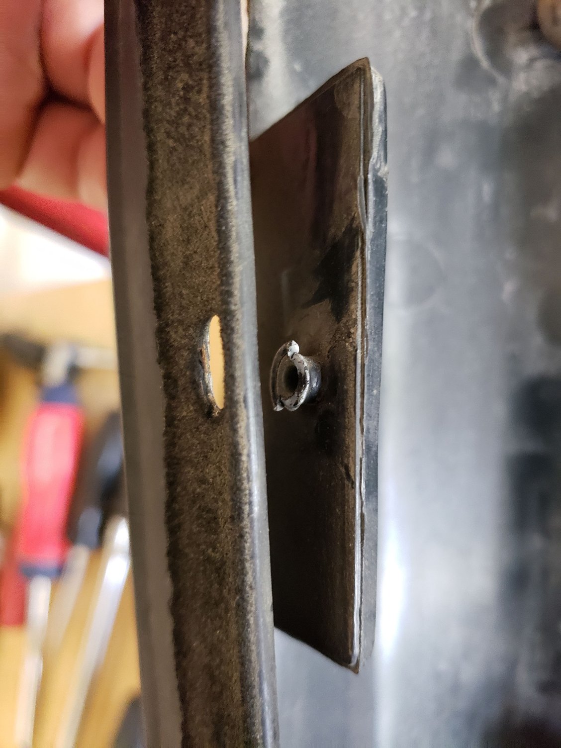

Here's what i ended up with. Pop rivet just long enough to bite the plastic and a washer. Drill a hole, pull the rivet through. Seems secure enough, we'll see how it holds up.
I’ve had that same setup for over a decade, for what it’s worth 👍
