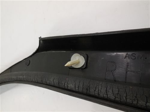

When I fitted the headliner, I had to really shoehorn it in, because I was not able to remove the molded black plastic trims that run up the inside of the windshield pillars and across the (inside) top of the door window apertures. Getting the headliner in was barely possible without removing the trims - but getting it out again is impossible, unless I can get those trims off. I am concerned mainly because I don't know what the fixings are or exactly where they are. I'm sure they'll be brittle after 34 years,and I want to cause them as little stress as possible. I can get the screw out that's at the top of the windshield pillar, (and I'm able to remove the trims that make the back edge of the window aperture). But so far that's as far as I can get. Photo attached clarifies what I need.
Can anyone enlighten me how to go about removing the trims without breaking anything, please?

That Screw Is Not Factory The Moulding Was Most Likely Removed Before And One Or More Clips Broke It Uses This Type I'm Not Sure How Many There Are
