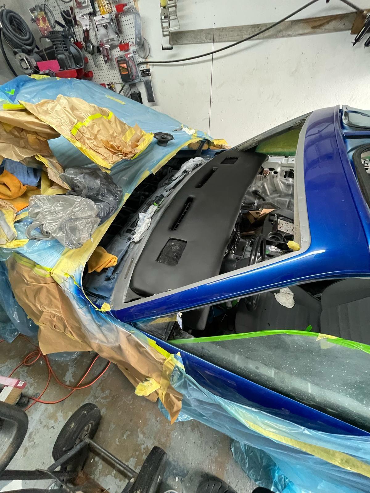

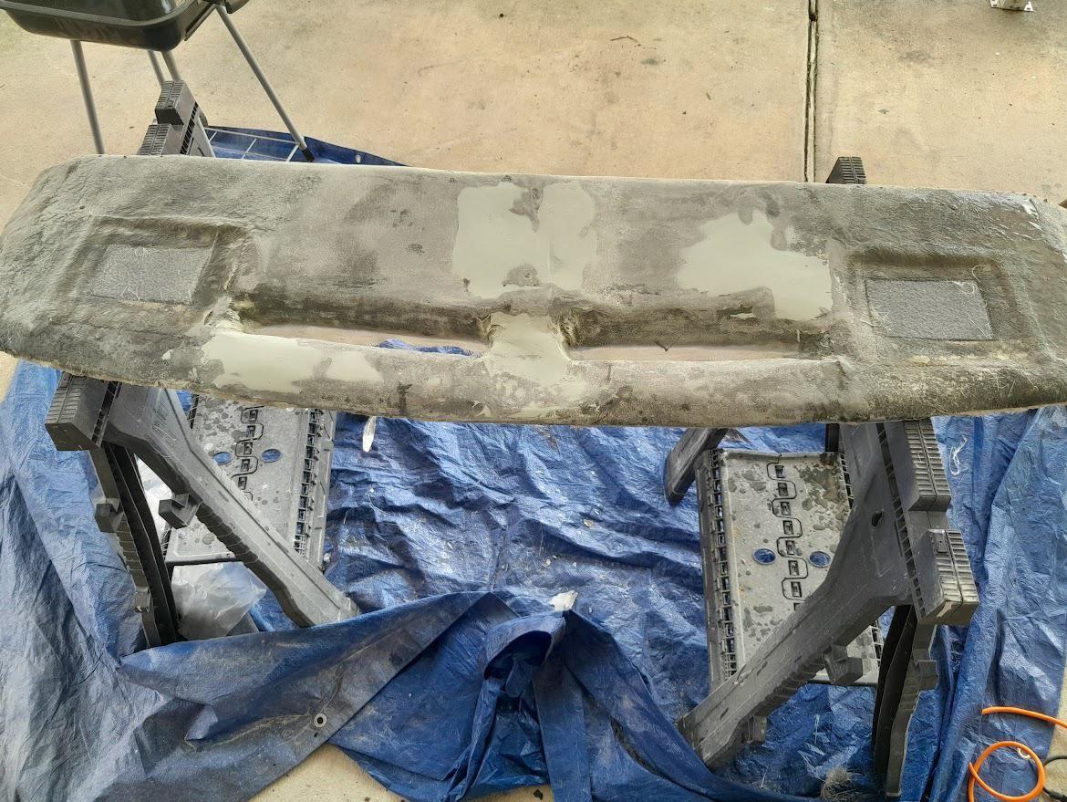

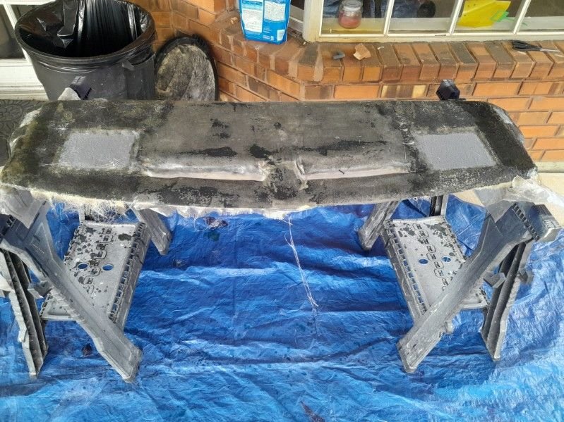

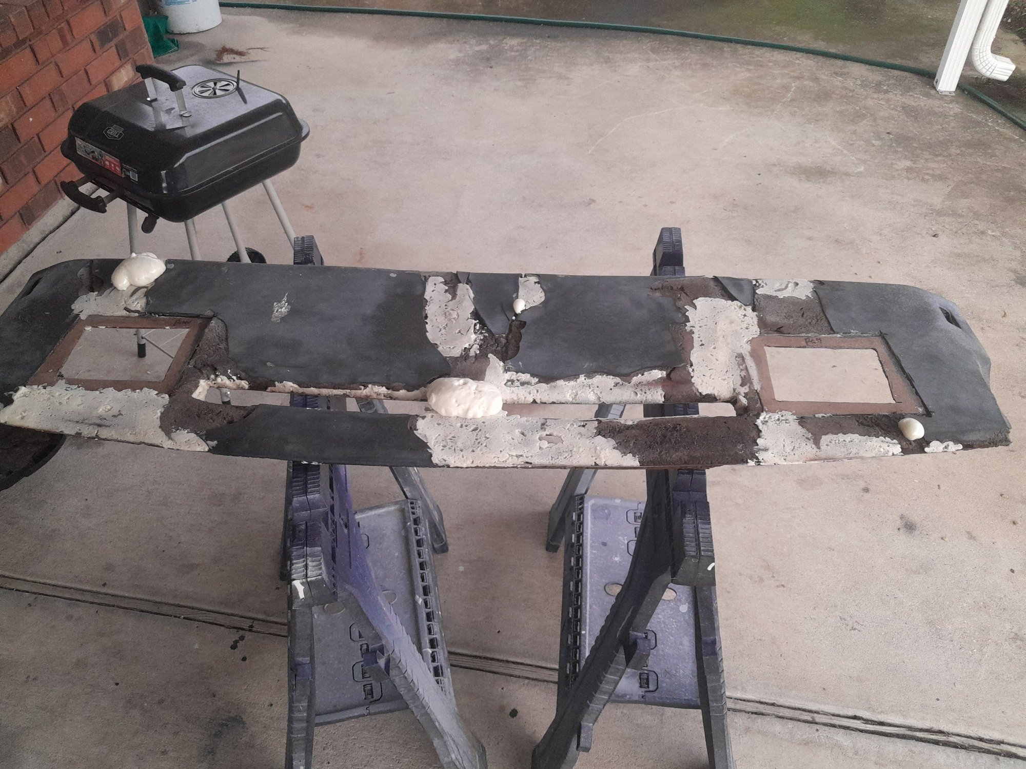

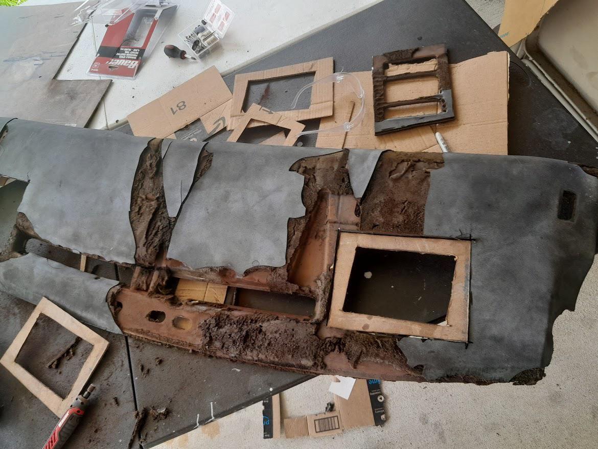

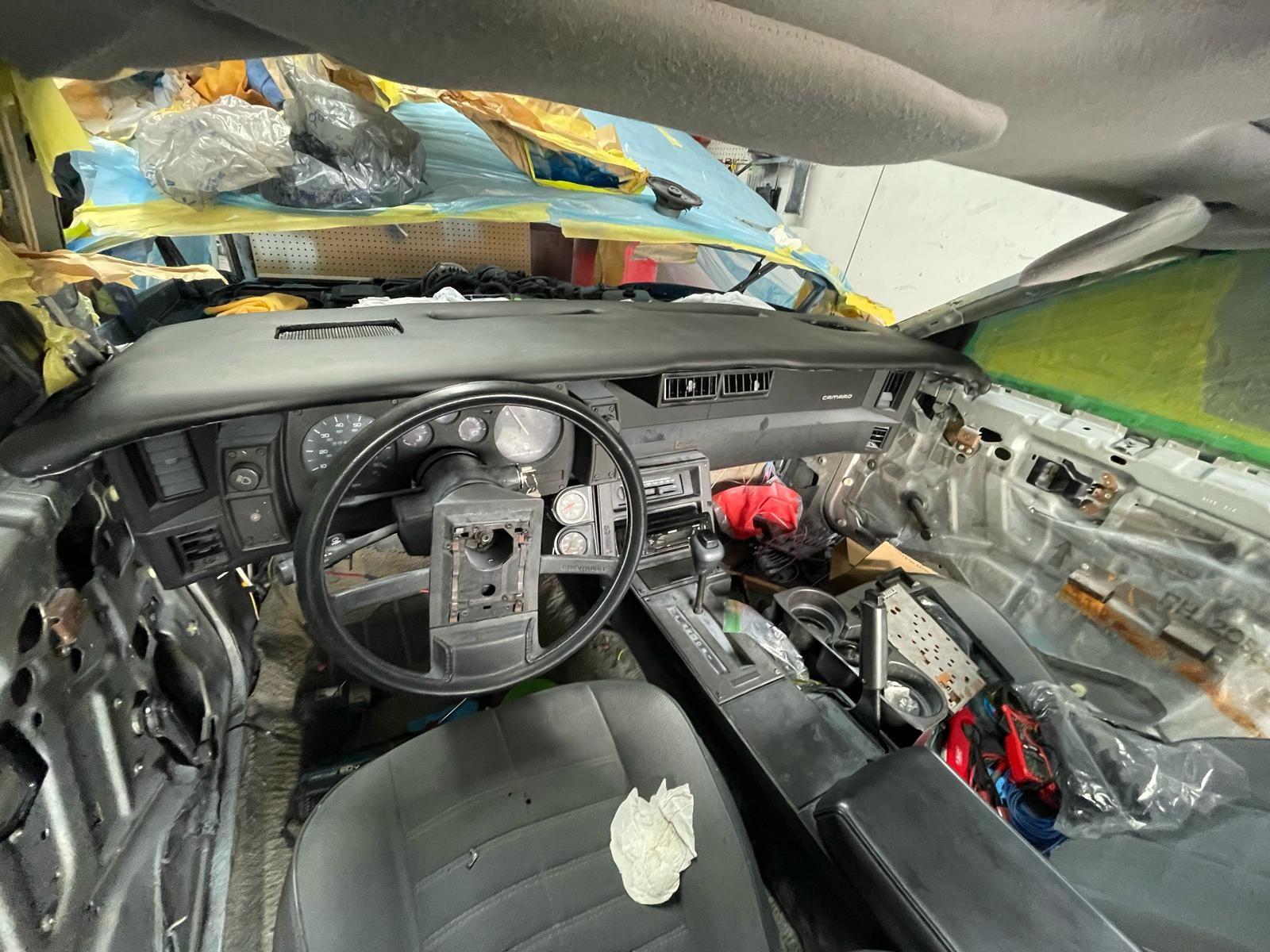

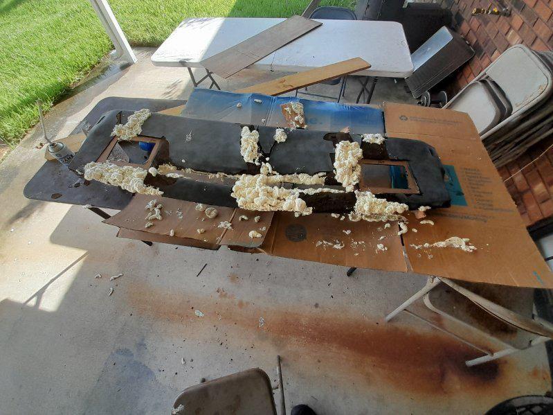

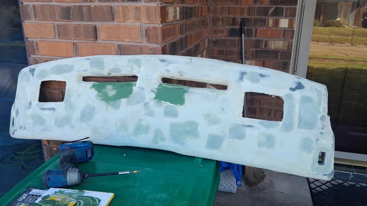

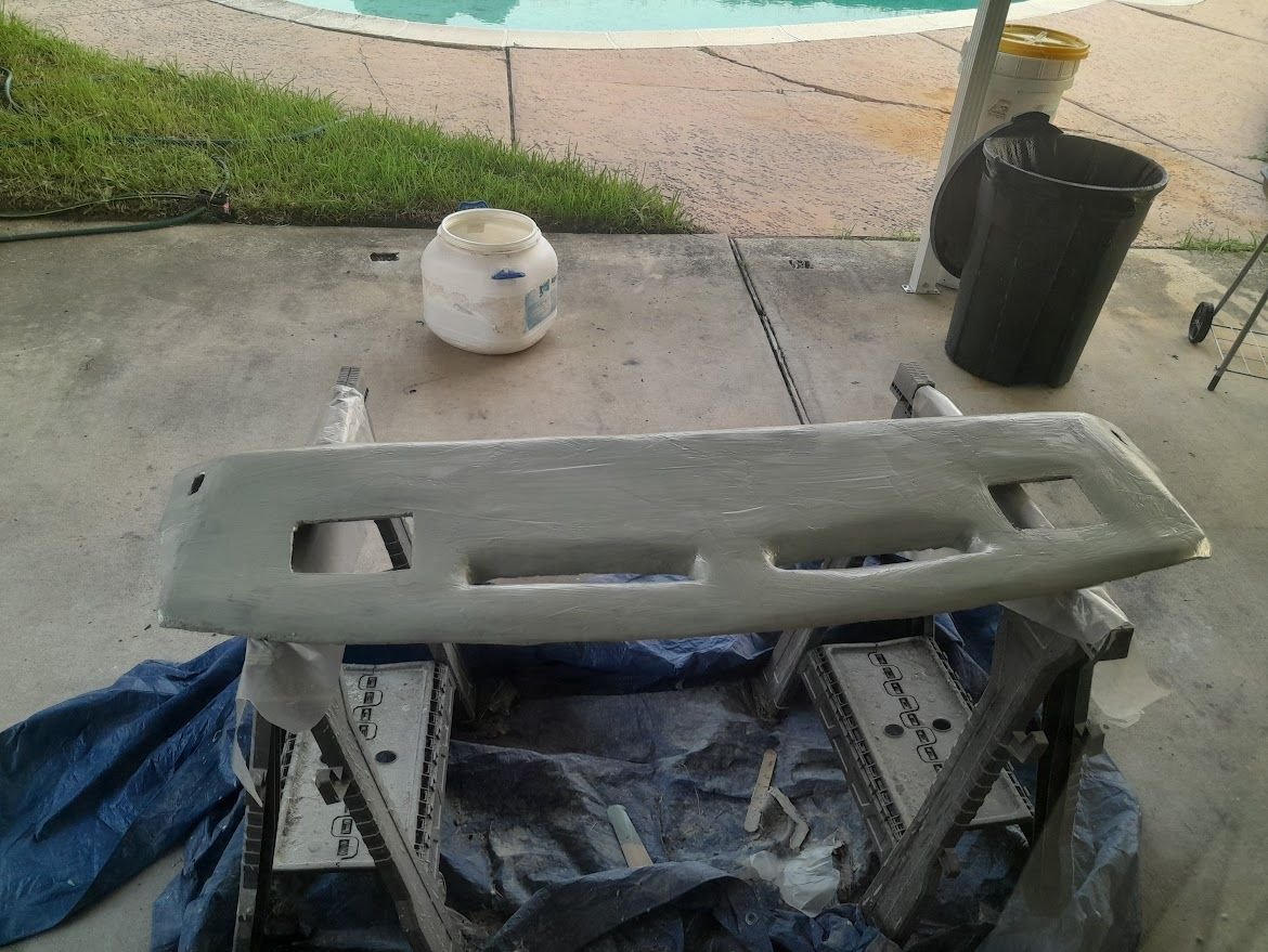

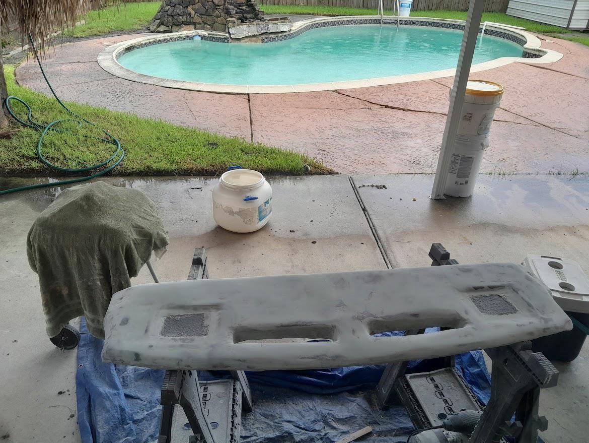

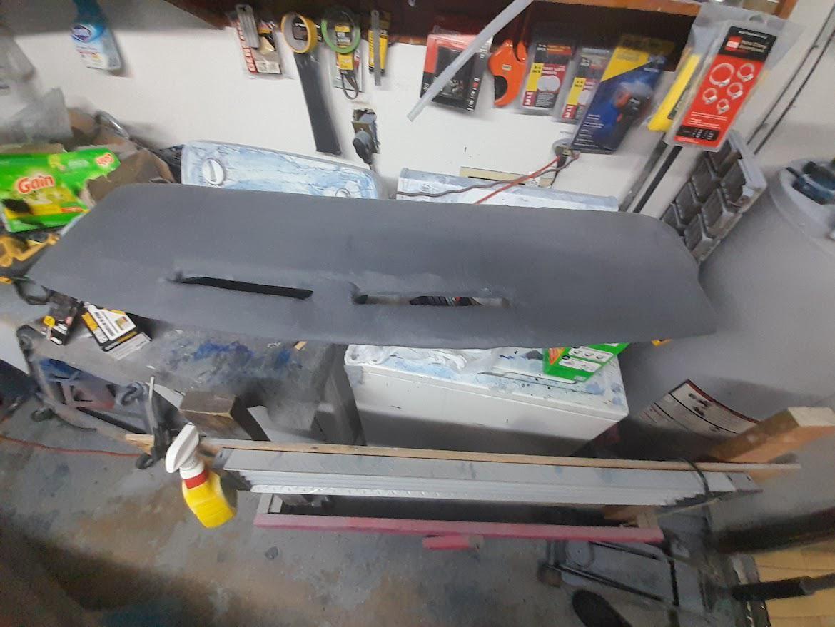

I just wanted to post some pictures of my dashboard I restored using fiberglass resin, fiberglass matt, fleece blanket, and body filler for the finishing touches
