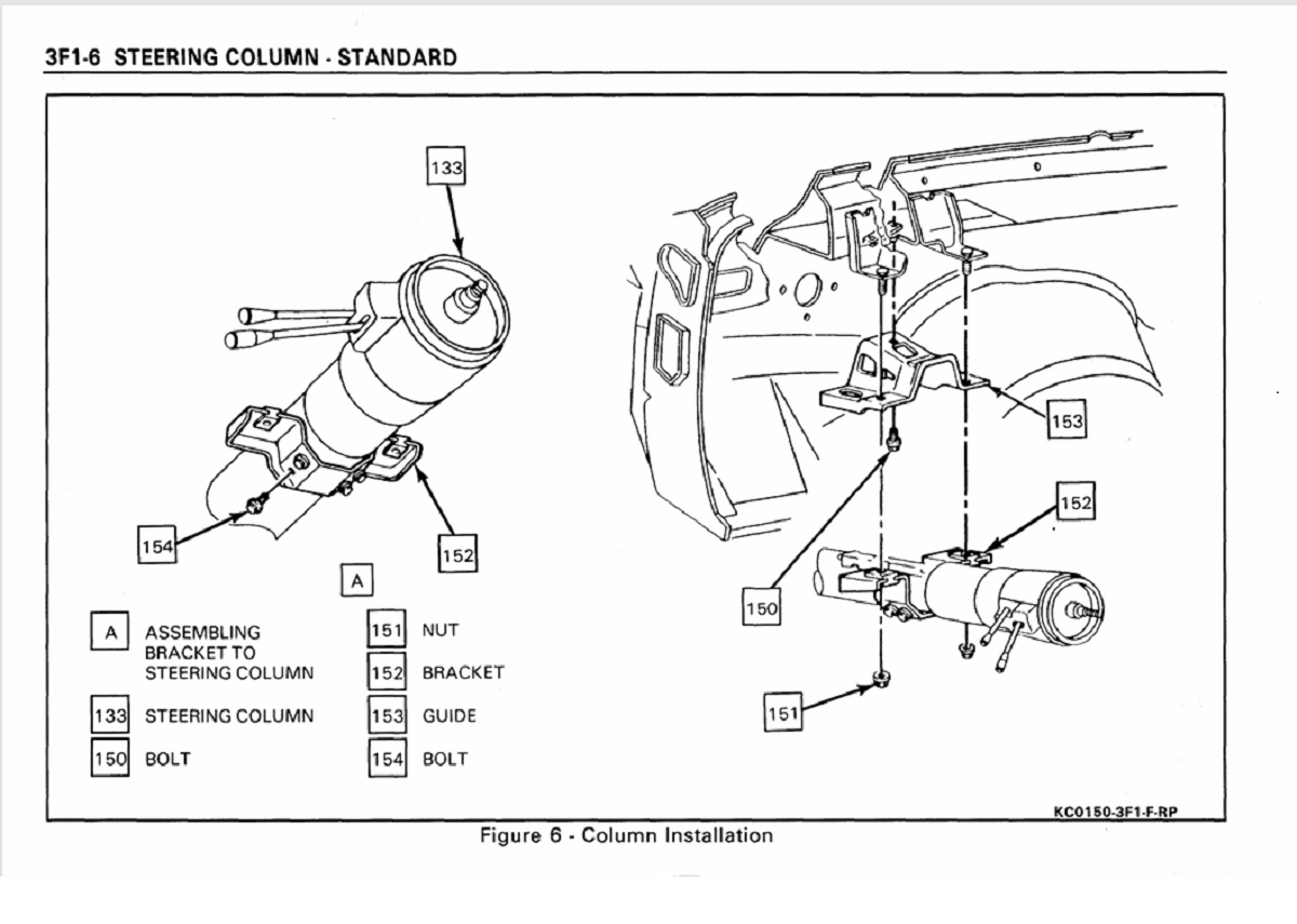

Hey guys, brought myself a beautiful 82' sport couple with an lg4 305. However some Muppet did a conversion to RHD and I'm converting her back to factory and am confused on where the top mount attaches to the firewall. Any advice is gratefully appreciated. My first full restoration and Google ain't always helpful....

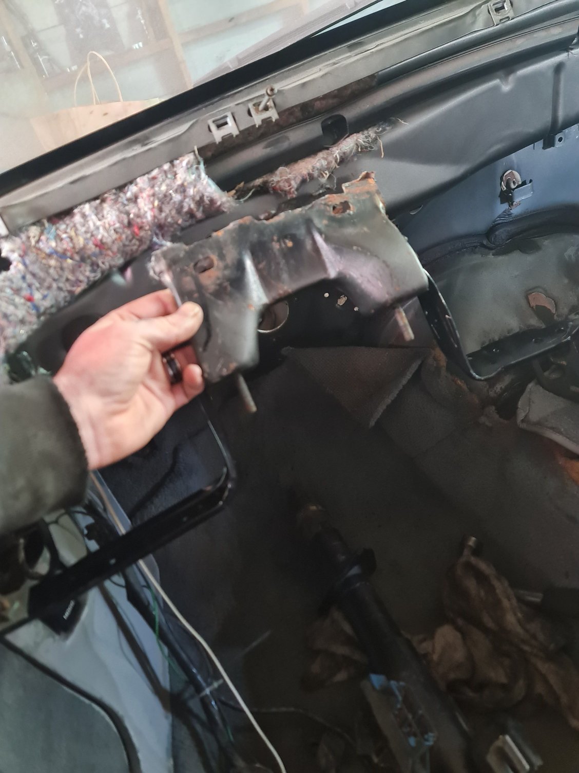

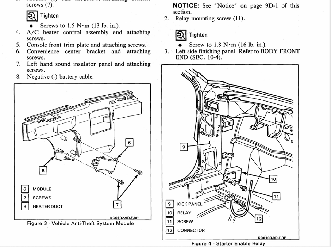

All i have is this.
NachoIroc
May 18, 2018 08:54 AM
emckee03
Sep 5, 2014 10:25 PM
DTL504
Sep 15, 2008 08:56 PM
