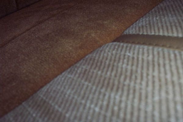

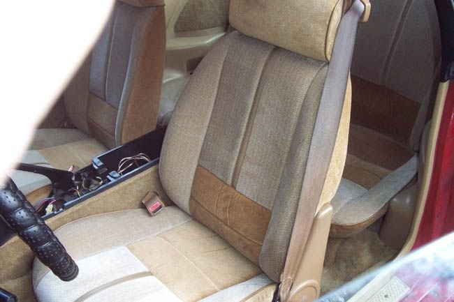

I bought Hawk's interior about 20 years ago when I first redid the beechwood cloth in my 89. I was not impressed. Just looked cheap. -and of course, it was. Probably worth the cost honestly, but it wasn't quite what I was after. That being said, it served me well, and "most" people didn't know. The door panel material matched the seat exactly, which of course wasn't remotely close to OEM. Finally redid it all in 2018 from Princess at Lethal. I want to say it was about $2000, but it looked excellent!!! She WAS able to find the exact materials that GM used, however I chose houndstooth over the factory woven material.

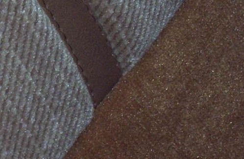

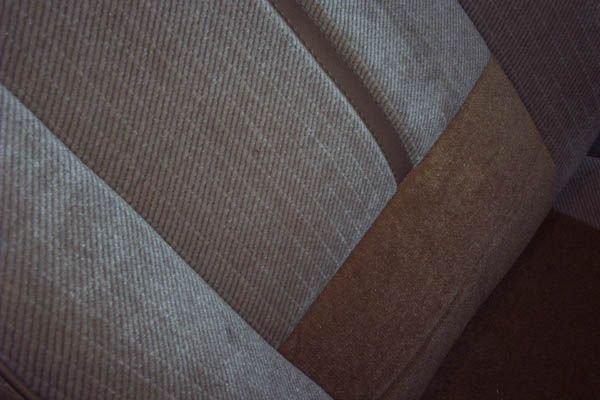

Hawk's. You can see it's all basically the same material, just made to "look" textured. -and of course, different color.

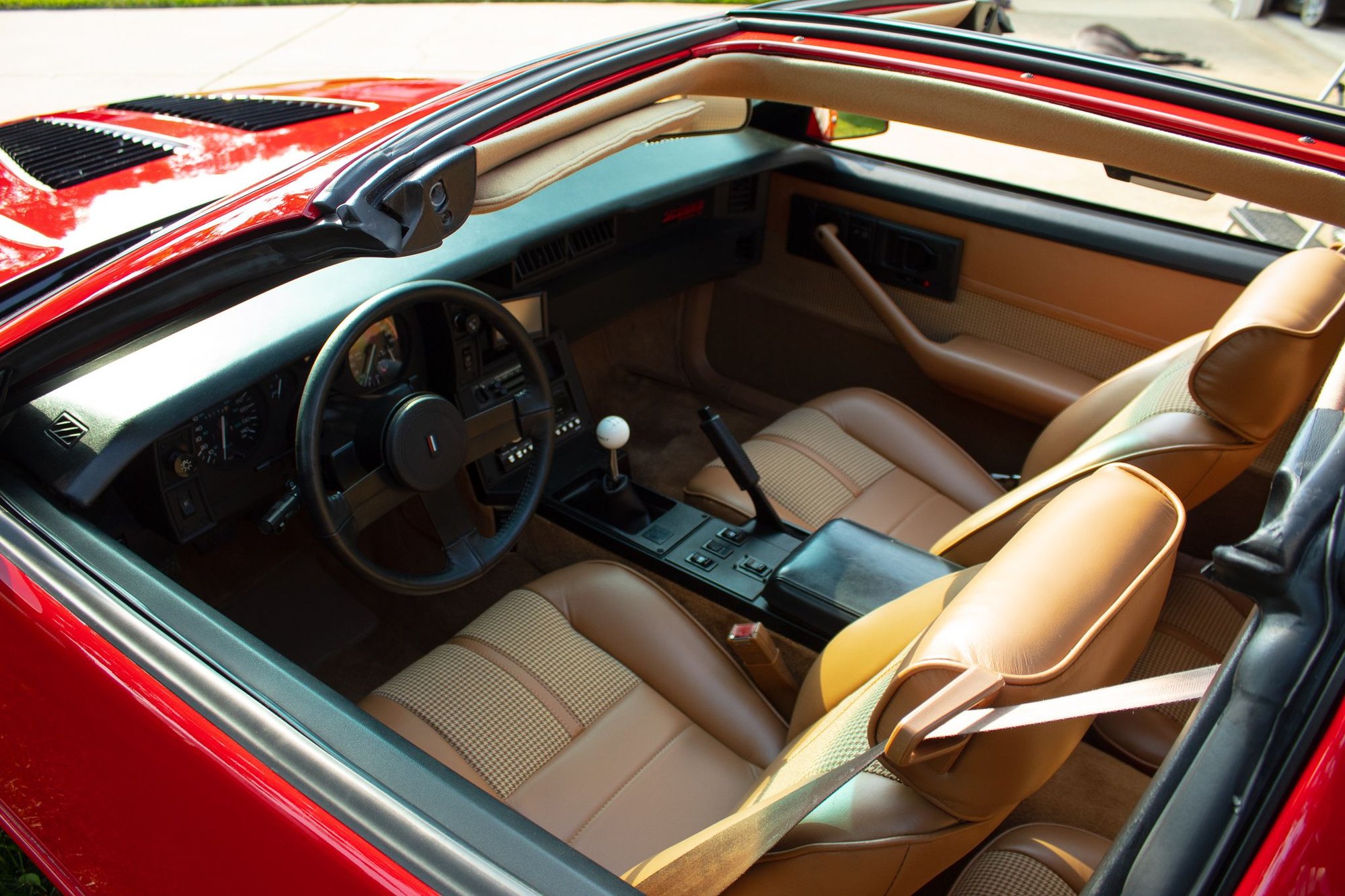

Princess/Lethal!

Her work is NICE! I'm a little bummed that she won't do my seat style.

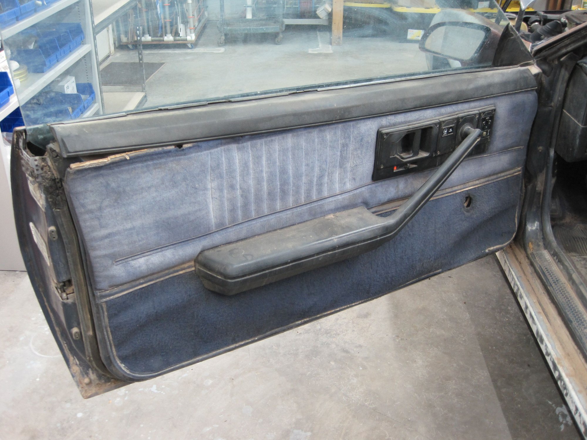

So now I'm thinking, besides being faded, I think the carpet and fabric are savable. I can make my own panel, maybe out of Coroplast, and figure how to dye/paint the fabric and carpet. I wonder if SEM has the same colors?

Ok, I lucked out and found some used panels on eBay. Way better than mine. Even the top rails don't look bad. I already have some NOS, (I think they are), top rails if need them.
I may or may not try to recolor them as they don't look bad in the photos. The cardboard has a little bump on one of them and there is a wrinkle or two in the fabric. The local upholstery guy said wetting the cardboard with water and weighing it down sometimes gets good results. Worst case scenario, he could resew them back on new water-resistant board.
I'll make a decision when they get here.

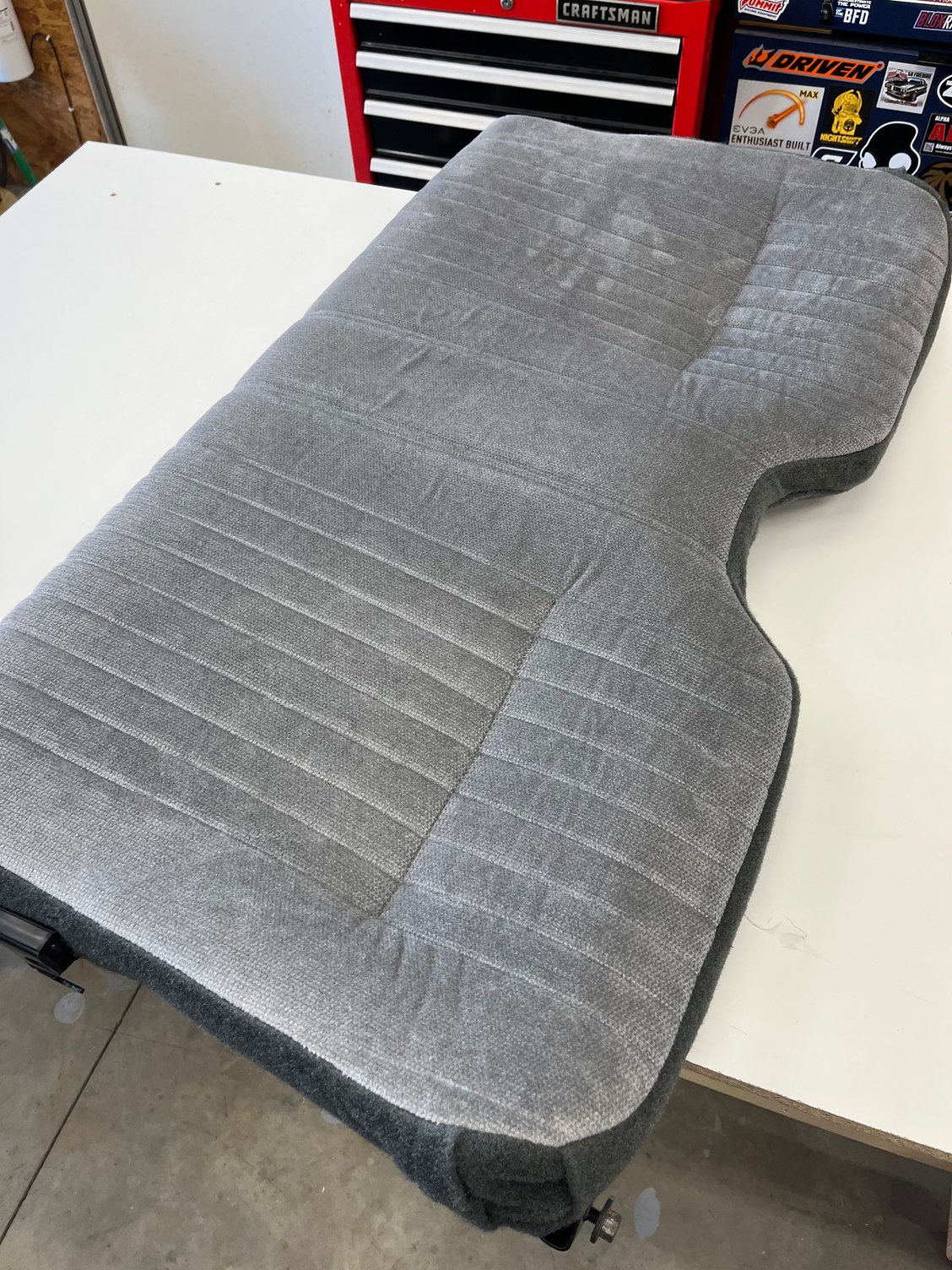

I recently installed the Acme Chino Velour light charcoal upholstery for my formula (from Rockauto, same as what hawks sells), the Chino is supposedly closest to the original 85-92 firebird pallex that you can get , it's not an exact match for the cloth pattern but very similar texture and color, and it fits well and was very easy to install.
I cant speak to the camaro encore velour pattern, but as an easy replace kit I was overall very pleased with it. The prices keep going up up and up, here's a comparison picture
keep in mind my factory covers we very sun faded and dingy, so the color is probably much closer to it as it came out of the factory.

That looks pretty good to my non-discerning eye. I think anyone aside from the strictest 3rd gen purist would have a hard time finding an issue with them once install.
How was the install? I need to replace a lower cover on my wife's outback, sounds like good practice lol

thanks - I am one of those people that would immediate notice it, but it's so close that its well worth it to me, would do it again in a heartbeat.
the install was very easy at least for the formula seats, I had no prior upholstery experience. it's all pull on/zip and then Hog rings in the same locations as the originals, and punch out holes for bolts and levers.
Just be careful disassembling everything and take your time, especially with the seat tracks. Some of the seat belt fasteners are loctited in so they can be tough.
If I was doing it again I would probably get a better set of hog ring pliers than the ones that came with it, but they did work fine. Knipex makes a really nice set.

Maybe I'll give Acme a try. Based on your photos, I think they look great! I think I can tolerate a fair difference in material. I have a sample and it looks good to me.
