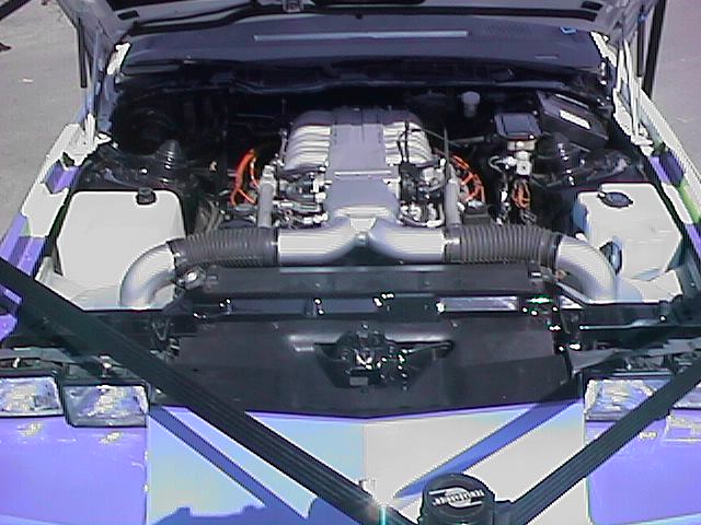

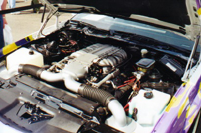

I've seen a few online before and 1 in person two years back. An IROC with an LT5...just about the coolest thing I've ever seen
There's plenty of space for them in the 3rd gen's engine compartment (more so than with a typical Big block swap which are a dime a dozen) and the LT5 just looks killer !!
The most difficult part (I would think) is getting a custom set of headers built as there's very little clearance at the sides (by the shock towers) due to the LT5 being so wide.
If I had an extra $19,000 laying around, I'd pick up the LT5 in a heartbeat.

Wow that is awesome. Nothing looks as sick as the LT5 intake. Yea i would assume the headers would be hard to fit but at least I know it's possible. Do you know if it fits under the stock hood? I didn't realize that they cost so much either. $19,000 is about $12,000 more than I expected, but I guess that is true considering how many we put in the Vette's and how many are no longer in them.
