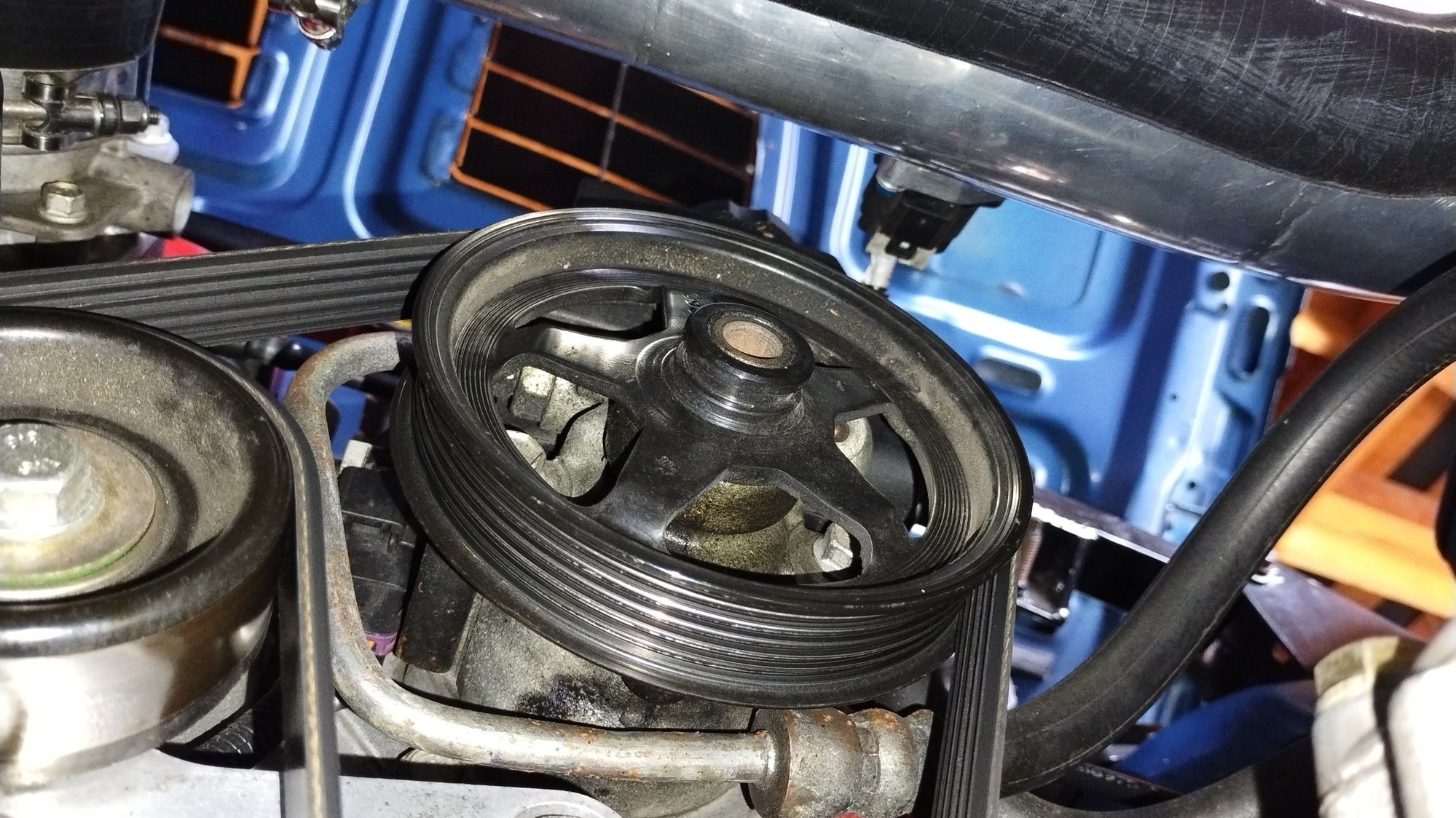

FYI - the stock hose will require major rebending to fit (not just tweaking) and the routing of the steering hose in this picture won't work. I installed a new stock hose same way as this picture and then it was in the way when I installed the serpentine belt. I was able to make the hose work with some more bending. Here's some pictures.
New PS hose installed like picture above with serpentine belt on:
PS hose with more bending to clear the serpentine belt:
I assume those are aftermarket cooler/lines b/c my OEM sits up so much higher off the pump above the framerail. I like the look of these and how you have them laid out. I know this was over 3 years ago but do you rememebr the cooler line parts?

Re: 3rd gen Ls1 swap power steering lines????
the steel cooler lines (the two on the right side of the picture) is the factory setup. i took them from a 1984 TA L69 car. not sure if these lines were specific to that engine option.
