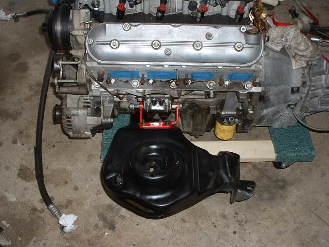

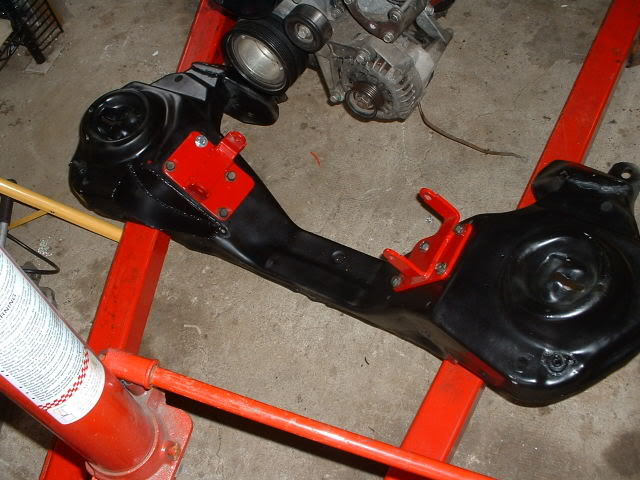

When I installed my spohn mounts way back when...there was only one way they would truely fit. Yes they would pysically bolt in in a couple different positions, but none were right. Mine right now are installed in the only way possible. My head to firewall clearance is how it should be...about the same as on the stock motor. HOwever..thats not what determines were the oil pan sits.
We're talking about a cast oil pan vs. a stamped steel, traditional pan. The sharp, squared off sump is what is causing issues.
Spohn probably test fit his mounts on their shop car, and it probably fit and worked great...or atleast with enough clearence. Problem is, and I keep saying this...no two cars are exactly the same. So if you build 1/4" of clearance into your test car, by the time you make all the parts and account for manufacturing tolerances, you might have zero clearance on 50% of the cars out there. Some might have more than 1/4" of room.
The problem isnt the plate that bolts to the k-member..its the straps. If they were moved only a hair rearwards, it wouldnt be a problem. But...then you'd loose head clearance by the firewall. Its give/take...and right now Im willing to give my k-member a notch than loose head clearance. And there is no way in heck my brake line would move around to the back of the k-member. It originally ran over the top of it...it now runs along the FRONT behind the steering linkage. If you were able to put your brake line between your oil pan and your k-member, either spohn changed his mounts, or you got a good set. haha.
Also...I had zero issues with driveshaft fit, or trans mount location. If I installed the mounts in any other position, 1) the motor wouldnt have even bolted in, and 2) everything else would have been screwy.
Maybe the mounts changed some since I bought mine? I got those suckers quite a while back.
Some illustrations. This is from my first swap. You can see from the bolt pattern that they are pretty side specific.
Here is a shot from the side. See how the strap is offset to the rear? Any other position would pull the motor so that the pan was in the k-member. You can see from the picture, that there is already hardly any clearance by the pan.

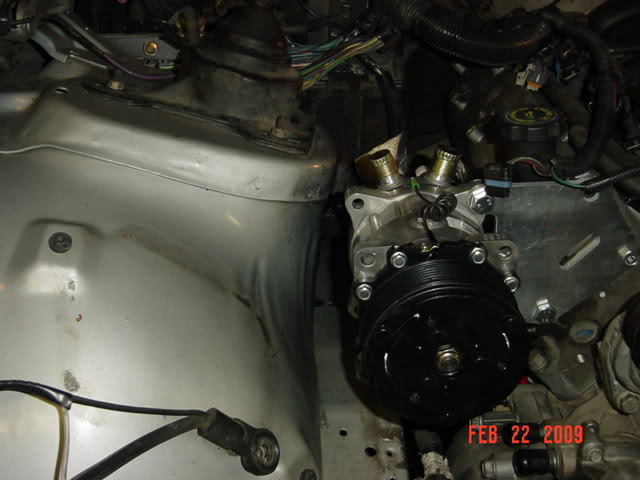

As promised, I set the relocation brackets and Sanden compressor back in place to see what it looked like. I just used one bracket, as it does a good enough job putting the compressor where it would be if the whole system was installed.
Looks like I panicked without reason.
From the front, with the hose inlet/outlet up:
From underneath, with the hose inlet/outlet down:
And, from the top, with hose inlet/outlet down:
Now I have to decide which system I want to use. Each has its advantages.

Advantages of the relocated Sanden:
New compressor
Easier access
Single belt with tensioner on the slack side
Disadvantages of the relocated Sanden:
Move weight up
In the way of the front of the engine (spark plug access, for instance)
Rewiring required
Advantages of the stock compressor:
Tucked in nicely
Has its own belt
No rewiring required
Keeps weight low
Disadvantages of the stock compressor:
More difficult access
Connector broken (arrived that way - apparently a fork lift "incident" in transit)
Need a special outlet manifold (or some really weird routing to reuse the 4th gen manifold/tubes for what will be custom plumbing, anyway)
Serpentine belt tensioner is on the tension side (not sure why the factory did that)
Don't know if the thing even works
