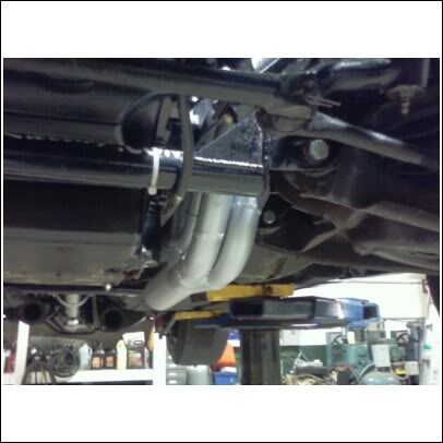

finished up the passenger side header today finally.
here's a shot of the drivers side installed

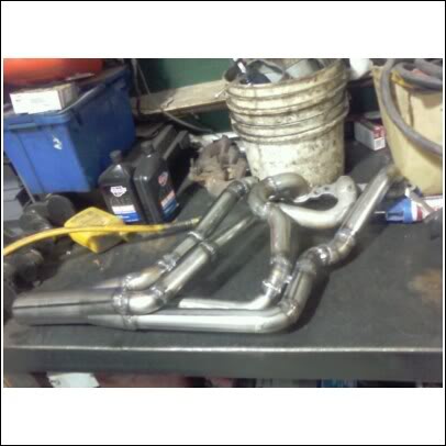

here's the passenger side on the welding bench

finally finished both sides today and painted them in VHT header paint.
drivers side installed from behind
both headers installed....only .5" lower than the oil pan, should be perfect for ground clearance.
both headers from behind
passenger side header, now this is what I call tucked perfectly. .25" clearance all around the collector flange.
