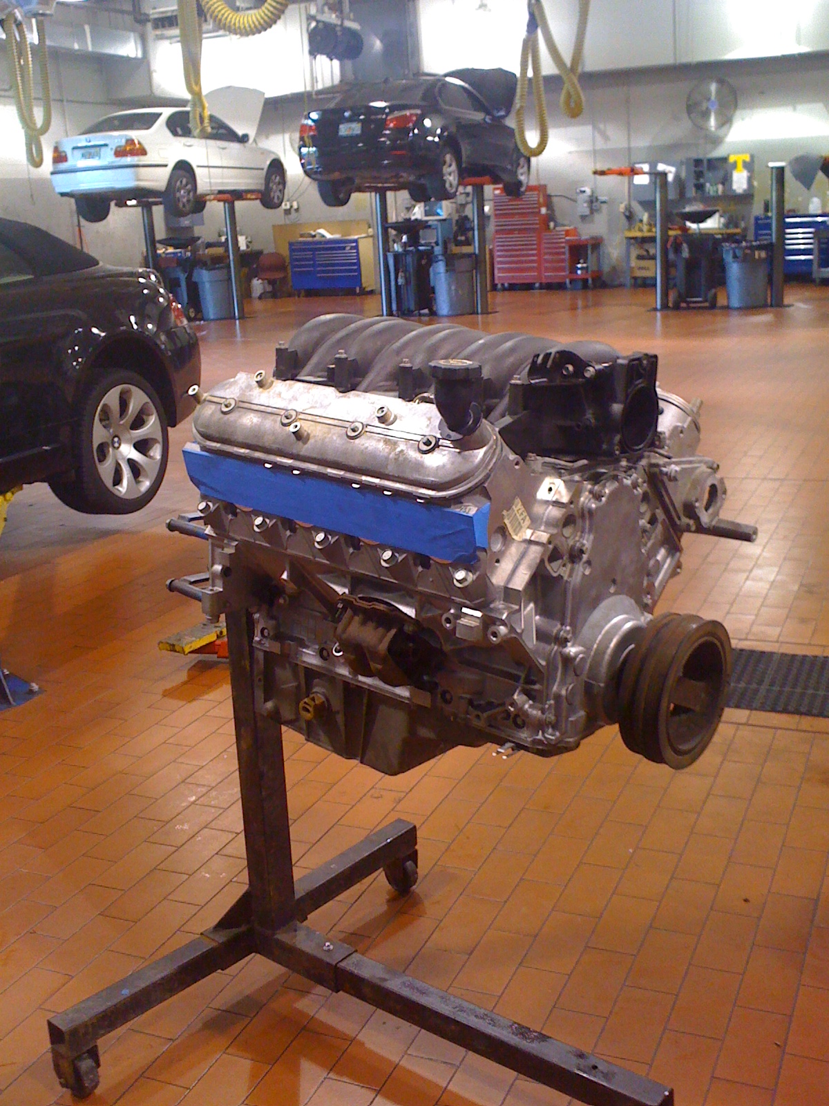

starting question-003.jpgim in the process of starting this beast of mine...just wondering...if the computer doesnt see oil pressure will the engine still fire and run??i thought that the theft deterrent system just cut out fuel??i by passed the fuel relay and had the fuel pump running constantly while cranking..still no start..does the computer also cut out injectors or iginiton coils??really just tryin to get this this to run, its been a long time commin..thanks for any input!!!
