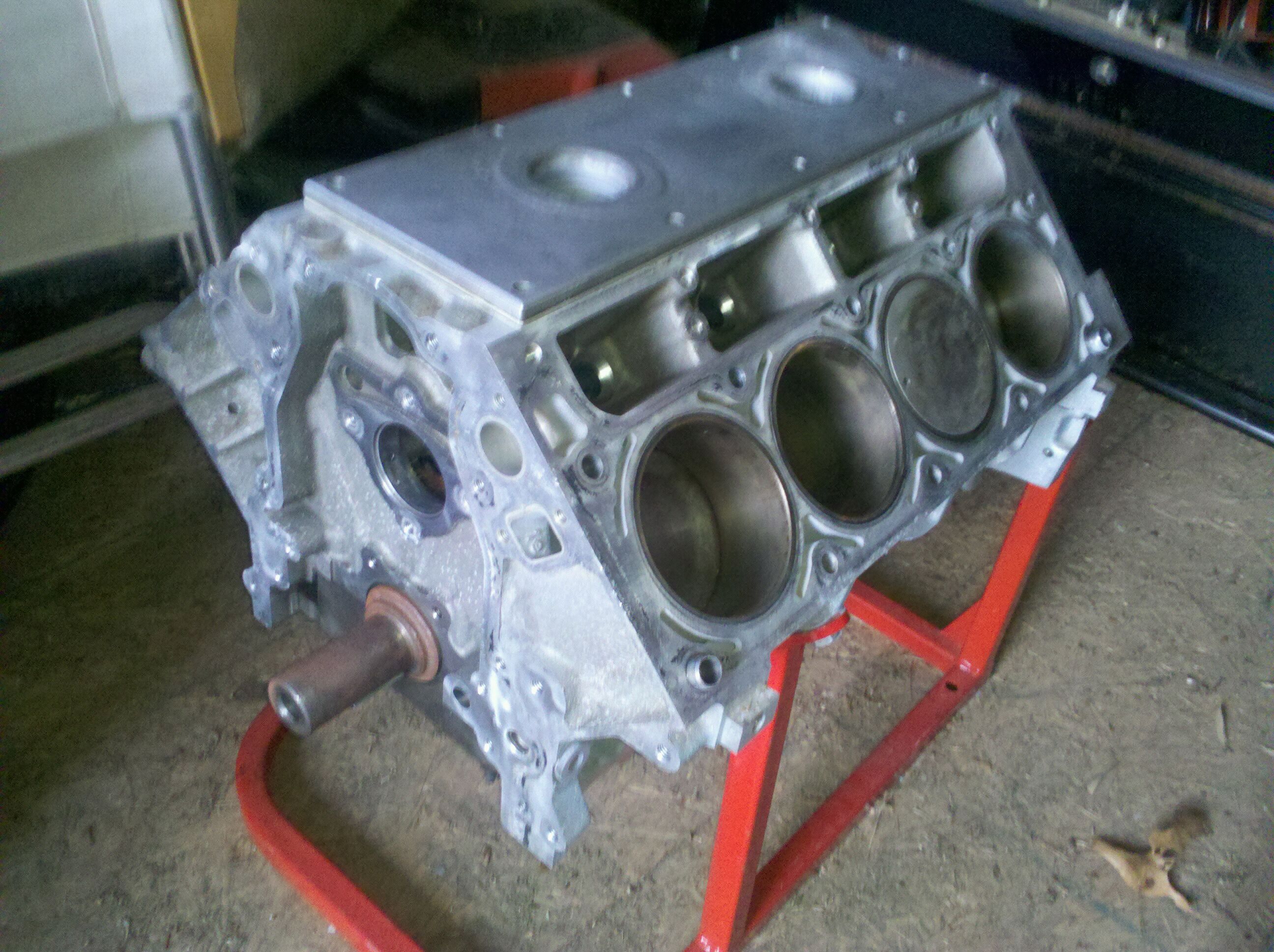

Well I got my shortblock home last night, first time I've really got to look at one of these things, how different they are from the genI design.
As for the transmission issue I still dont know what I'm going to use, but I have plenty of time to figure that out. Still undecided on a cam, mostly who to get it from. I am pretty dead set on the AFR 215cc mongoose's, anyone have any opinions on SCAT vs Eagle for forged rotating assemblies?

wow. you're missing A LOT from a short block... its going to nickle and dime you to death getting all the pieces, good luck.. hit up LS1tech for most of the parts, i find they are the cheapest over there.
I got the front and rear covers, I need an oil pan and I didnt want the cam, what else am I missing? All I really wanted was the block itself, I'm pulling stock internals and selling them.

lifter trays, lifters, lifter tray bolts, oil pressure sender, knock sensors, cam retainer, cam retainer bolts, hard line coolant steam lines, coolant line bolts, 24x or 54x reluctor gear, cam gear, crank gear, balancer, crank balancer bolts, serpentine system(not cheap), oil pump, oil pump pick up tube, pick up tube bolt, oil level sender, rear main seal (possibly, cant see the rear of the block)
and this is what i can just see by the 1 picture... hope you got this for 200$ or less... like i said, a lot missing
and thats just the short block... the top end is another ballpark..
and you DONT need the FAST 90/92 or 102 intake to make power. LS6 intake will flow very well into the 450+ hp mark.
the gaskets on these engines are a tad on the expensive side.. ONLY use the GM MLS head gaskets.. DONT use felpro head gaskets.. you can use the felpro intake gaskets or felpro anything else.. just dont use their head gaskets..
here is also a quick tip.. use exhaust valve seals on ALL 16 valves.. the LS1 exhaust valve seals, seal a little tighter.. same price as the intake version.
if you need any info on other things, or cheap places to get parts, let me know. Ive built 3 LS1's so far.. and now im building an LT1 yeah going backwards a bit,
